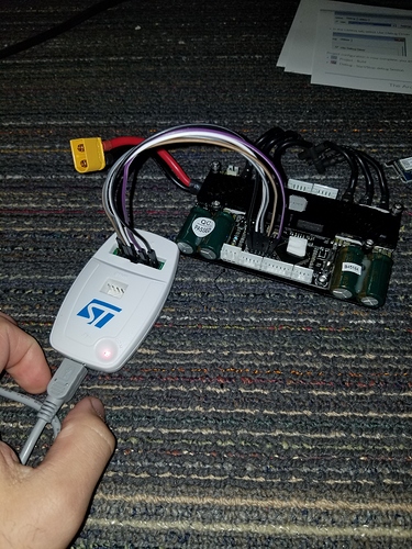

Check the pinout, you’ll have to solder wires to the PCB as it doesnt have a header, same pinout and connections. You have to do some work…
no toturial said to solder anything, its not the older version its the dual vesc unity focbox, from the raptor 2.1

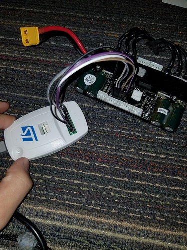

This is it plugged in, I get a blue light and red light that blinks twice with a pause in between repeatedly
I’ve moved around the ground wire a bunch, but other than that there isn’t much moving to do, I’ve got the right wires in the right place according to one of the best walkthroughs I’ve seen out there
Any activity on the unity? Blue light should flash for firmware reading I think.
Blue light on unity stays solid, I get a long red flash when I try to connect with the utility
Oh, and the red light blinks twice then pauses and repeats

When I try to connect to the box with the utility
Damn, thanks for the help anyhow
Seems like a fucked up MCU to me, but thats a giant PITA. Maybe @kellag or @deodand would be more useful.
