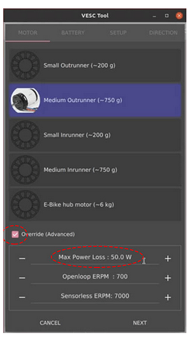

I donā€™t know brother, thatā€™s really strange. Your PPM start and end are way off. At this point I would reliable the firmware, defaulting there VESCs and start over. Your pulselength values should be approx as followsā€¦
Pulselength Start 1.000 ms
Pulselength End 2.000 ms
Pulselength Center 1.500 ms

Hahaha, this is exactly what I was suspecting why VESC was setting your motor current values so low. Forget Frank, you know how heavy your motor is right? Itā€™s close to 750gram. And you clearly see a 750gram motor class, right? Then itā€™s only logical to go for that instead of what Frank said.
Okay. So instead of mapping I just went in and set the Pulselength Start to ~1 ms and the Pulselength End to ~2 ms. Problem solved. I shut off the remote and the wheels do not accelerate. Except now my remote never gets to full power.
Looks like the problem is in the remote control itself then?
Yah so receiver is sending 1.5 as idle but when signal comes from transmitter itā€™s not hitting peak now it sounds like. If itā€™s the same distance off from -100% with full brake as it is from 100% from full throttle then can just squeeze both start and end point in by same amount say .1 and end up with same midpoint (1.1 to 1.9).

Seemed super weird two receivers would both have same issue so figured probably that idle is actually good but tx idle was low before so the rx idle seemed like high 30% or whatever.
Sorry I didnā€™t pay close attention to the values in the screen caps of VESC config probably would have known this if I looked closer.

If this is the root cause, and it certainly looks it to me, then the Torqueboards remote should work fine when it arrives on Saturday. In that case I am sure Hoyt would be cool about replacing the remote. As @mmaner said before, I should have a backup remote anyway.

I meant 750g, phone keyboards are difficult for my big beat hands :grinning:. But Iā€™ll redo it anyways just to show the results. What VESC are you running?
