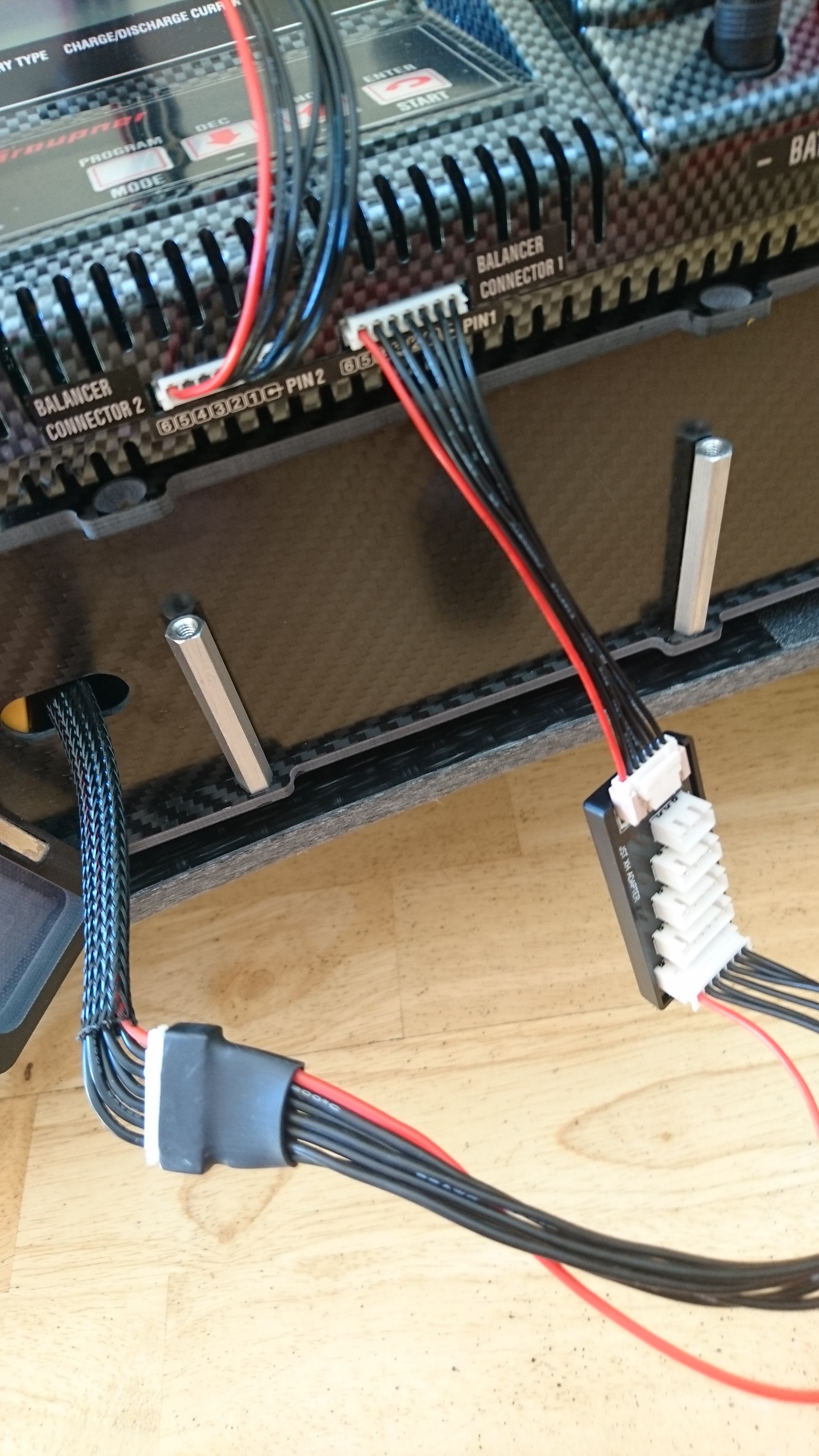

Ok, just to confirm even though I have Li-Ion (30Q’s) I should use the Li-Po program?
Also, how do I know which is the minus and plus poles for the balancers?

Am I right in thinking you have a 30q with a bms? Or do you have your balance leads connected outside of the enclosure lipo style?
The balance plugs are all keyed and line up. I’m just confused as I have two separate packs, so does one become + and one - depending on which side it is plugged into (e.g. the one with three red cables in the 2nd picture is positive I’m guessing).
@Dareno It is a 2x 6s7p (creating a 12s7p) pack (edit: with 30Q’s) with no BMS so each pack has its own set of balance cables.
Fuck I don’t know! You’ve got a fine rats nest of wires going on! I can’t even fathom what you have going on there
 what I’d do is charge one battery at a time till @Trampa can unfuck that bundle of wires

Doesn’t that charger charge more than one pack at a time? I am not sure of the issue. Should be plugging them in as individuals. Thats how I have always charged my multi lipo packs.
Am I missing something?
@Dareno is right. Have you ever parallel charged a lipo?
I’d do it like that, but you have so many jumpers, wires, and connectors that I cannot tell where they go and what they do
 unplug the jumper in your trampa box at the XT
 hook the battery XT to the charger main power and then the battery balance wire to the charger
 and charge one 6s battery at a time, till you figure out how to parallel balance the two batteries
 good luck, my eyes are bleeding!
The idea was that I should be able to charge the battery(s) in the monsterbox just like you would if you had two Li-Po’s. The battery builder recommended it and I confirmed it should work in this thread The battery builders club
Have a look here: One 6S pack carries the plus pole (balancer 2), the other 6S pack carries the minus pole ( balancer 1)
