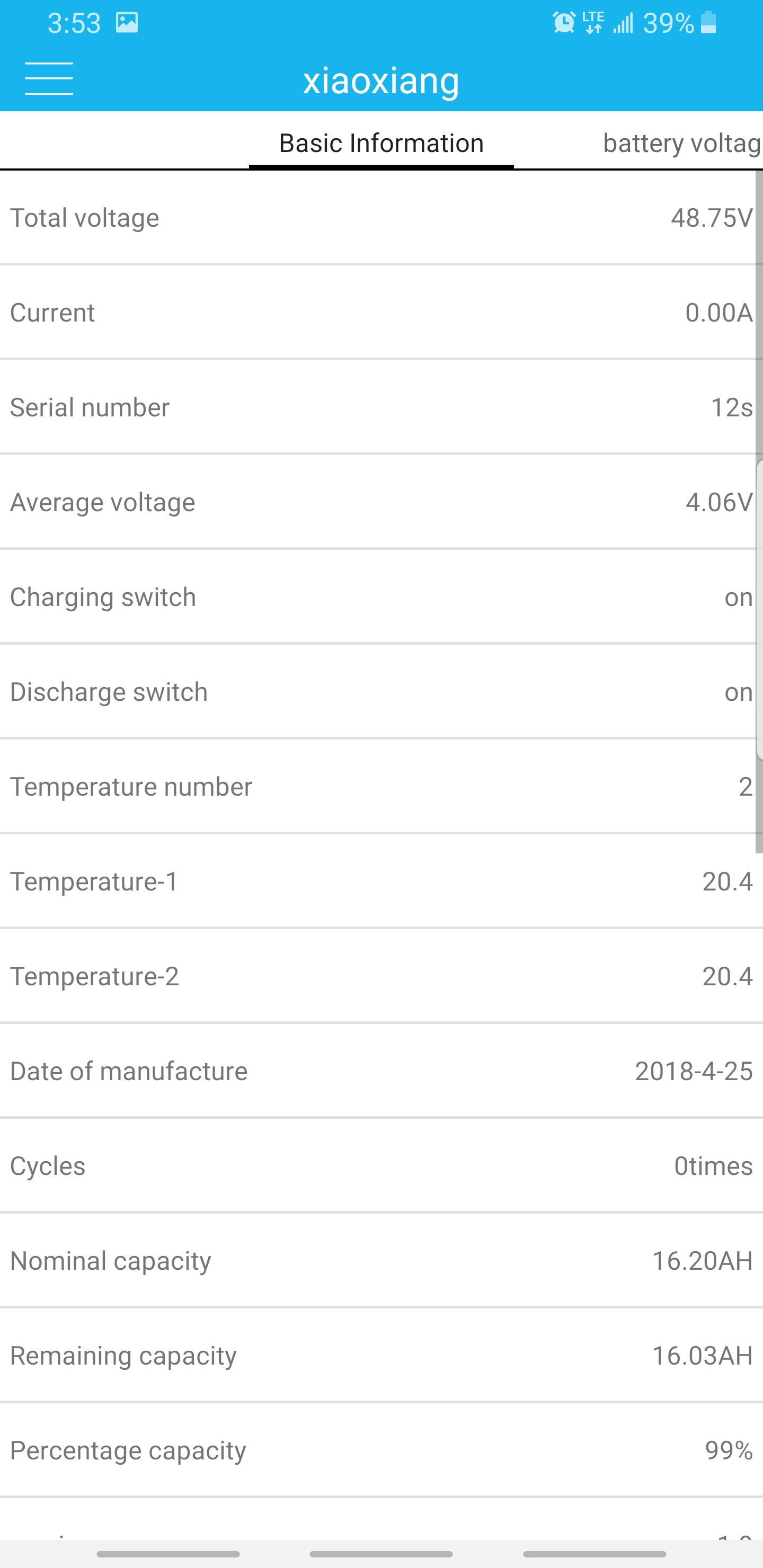

Like I said, you can always offer him to supply the bms. This way you know itll do what you need it to do. I supplied my builder with a smart bms for the added paranoia safety called “bluetooth” :rofl:

How does blutooth help with saefty is there a remote that u can use blutooth with?
@onebluesummer this is what I do with the bluetooth part.

The one I use is the ltt smart bms with bypassed discharge
https://www.lithiumbatterypcb.com/product/13s-48v-li-ion-battery-pcb-board-54-6v-lithium-bms-with-60a-discharge-current-for-electric-motorcycle-and-e-scooter-protection-2-2-3-2-2-2-2-2/
Note: if you want the extremely advanced features you need to buy the pc module (pictured in the first one⬇️)
