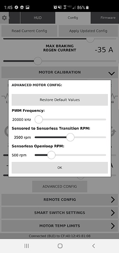

@Deodand, I noticed this menu the other day for the first time. Can you please give me a brief summary of what these values do and expected outcomes of changing them?
@Venom121212 i can tell you with what I understand from charles’ words that the transition is at what rpm sensors turn off. He told me to bring it up when full throttle from standstill was making my motors wizz without spinning
Thanks for the data bud, I appreciate it.
It’s explained in here :smiley:

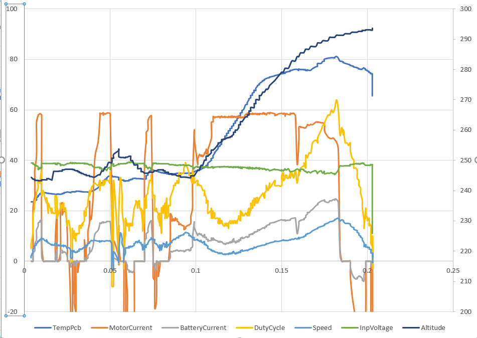

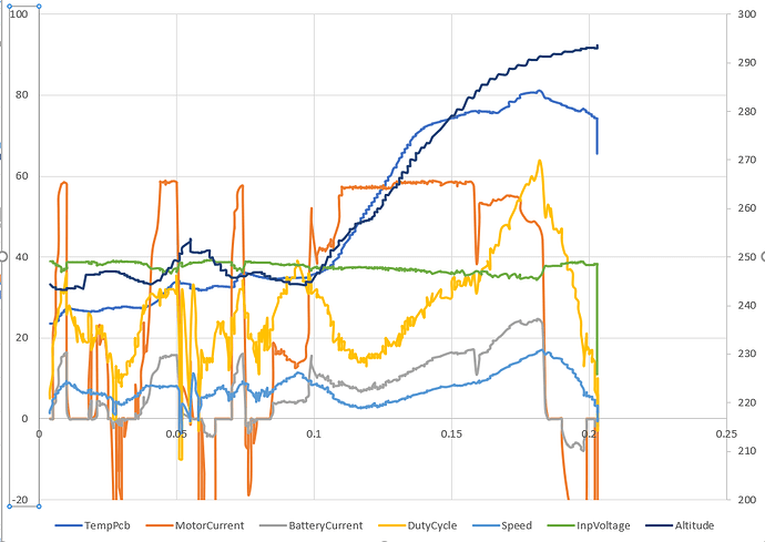

Follow up from previous post. I re-calibrated the remote and that was definitely off, so the good news is I made it up the hill! The not so good news is my speed was ~3mph. Is this what I should expect, or is there something else I should look at? VESC settings as follows:
Motor_Min=-60.0
Battery_Max=45.0
Battery_Min=-16.0
Cutoff_Start=34.0
Cutoff_End=31.0
Temp_Start=85.0
Temp_End=100.0
Watt_Max=0
Speed_Limit=35.1
Wheelsize=90
Motor_Teeth=16
Wheel_Teeth=36
Motor_Poles=14
Battery_Cells=10
Battery_Wh=290

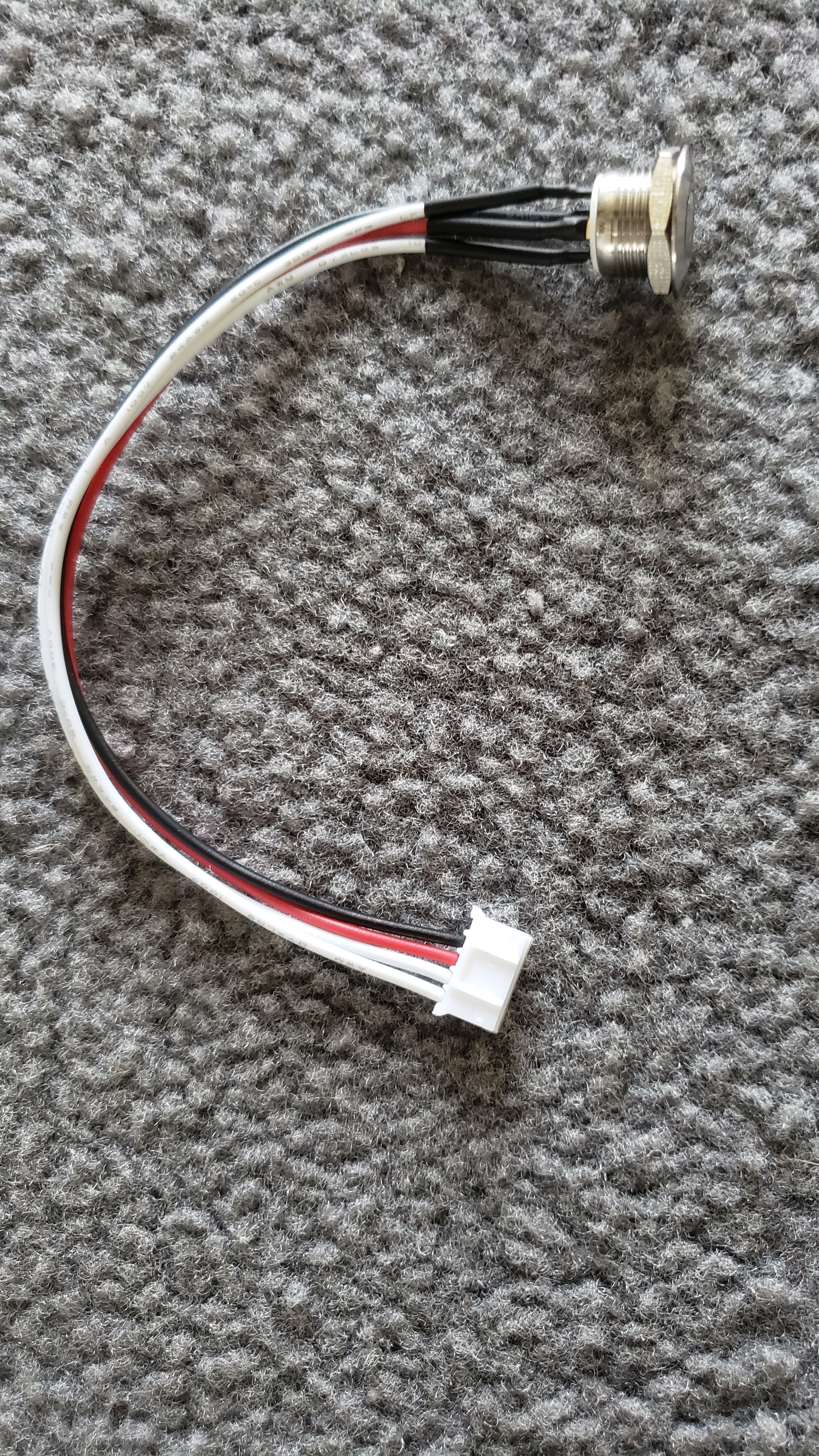

Does anyone know what this type of connector is? I am trying to extend the unity power cable without modifying it.
5 pin jst ph or zh.

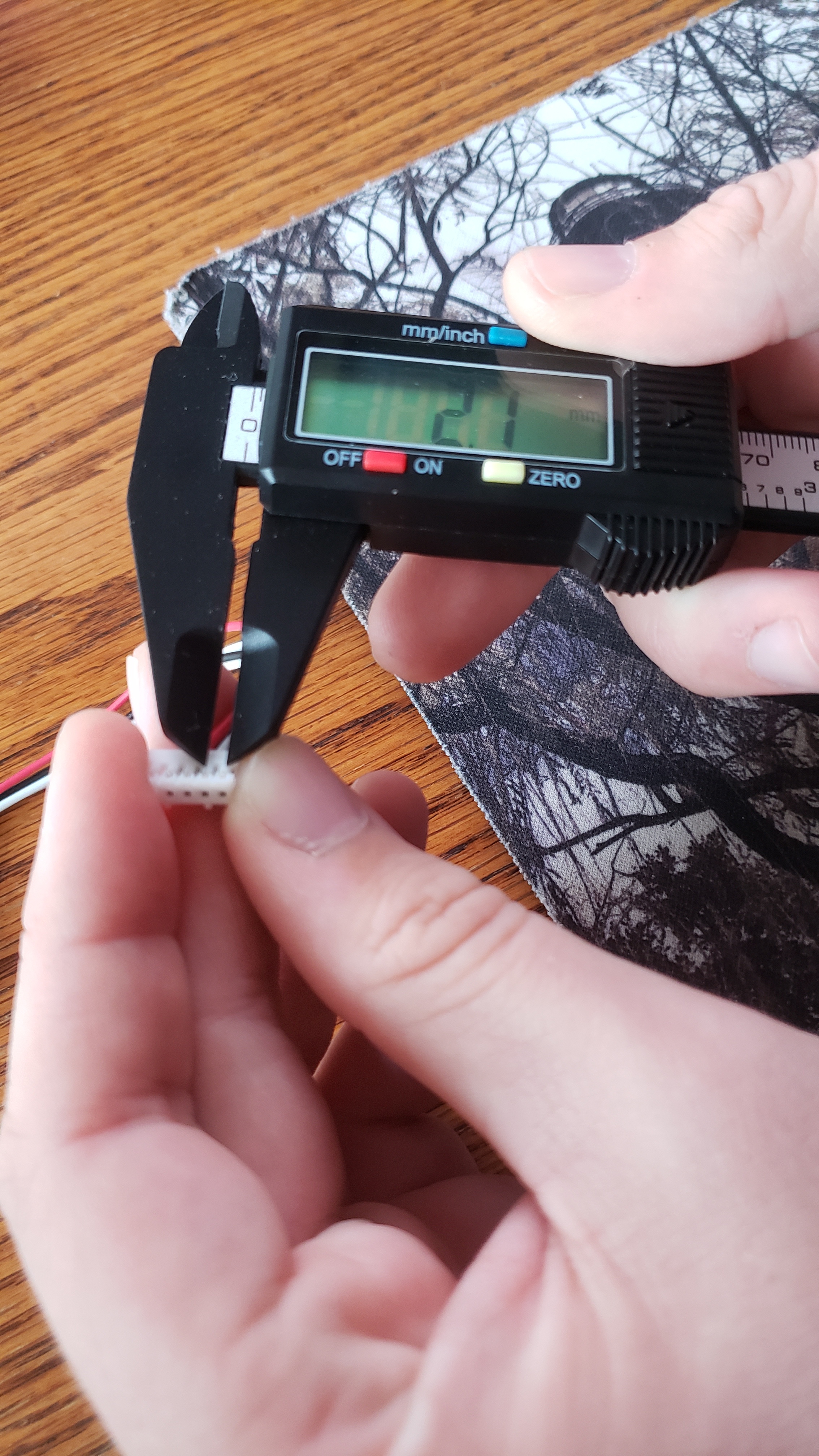

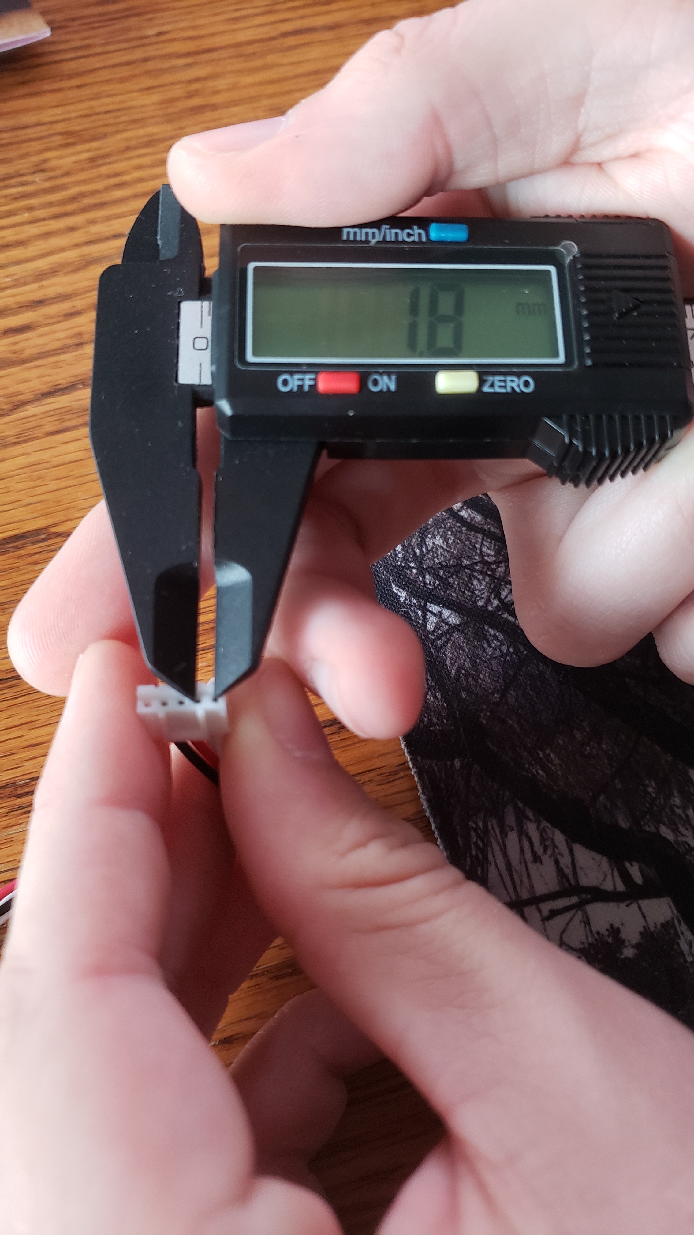

Measure the pin to pin distance in mm and let me know the result
If it’s 2mm, it’s ph.
If it’s 1.5mm, it’s zh

Looks like 2mm to me
Should be jst ph then. I might have a few laying around. You in the US by chance?
What is Motor Max? What motor is it?
Yep. (MN)
Got you mane. Pm me your address and I’ll send you one. It’s 200mm long, that work?
200mm would work great! PM sent.
