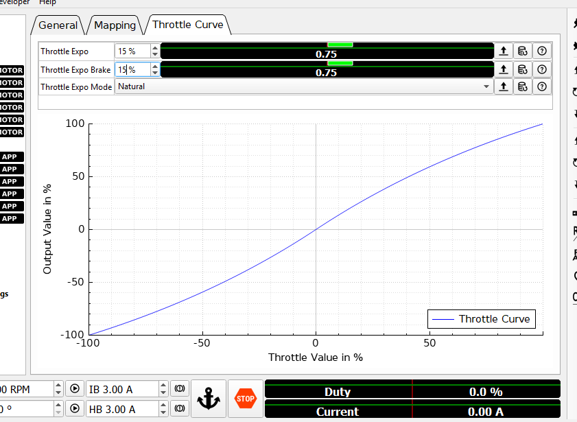

Not exactly. That will help too, but what Venom121212 is talking about is basically a control for, if you mash the throttle from 0 to 100% instantly, how long does the signal take to do the same thing? By default it’s pretty much instant - you mash the throttle, you get 100% torque RIGHT NOW. You can add a delay, so for example it takes 1 second from when you mash to 100%, before the motor gives you 100%.

@onebluesummer Exactly. Unity ui has something called positive ramping time that does what @MysticalDork is talking about.
Adjusting that throttle acceleration curve will help make it feel not as punchy at start up.
