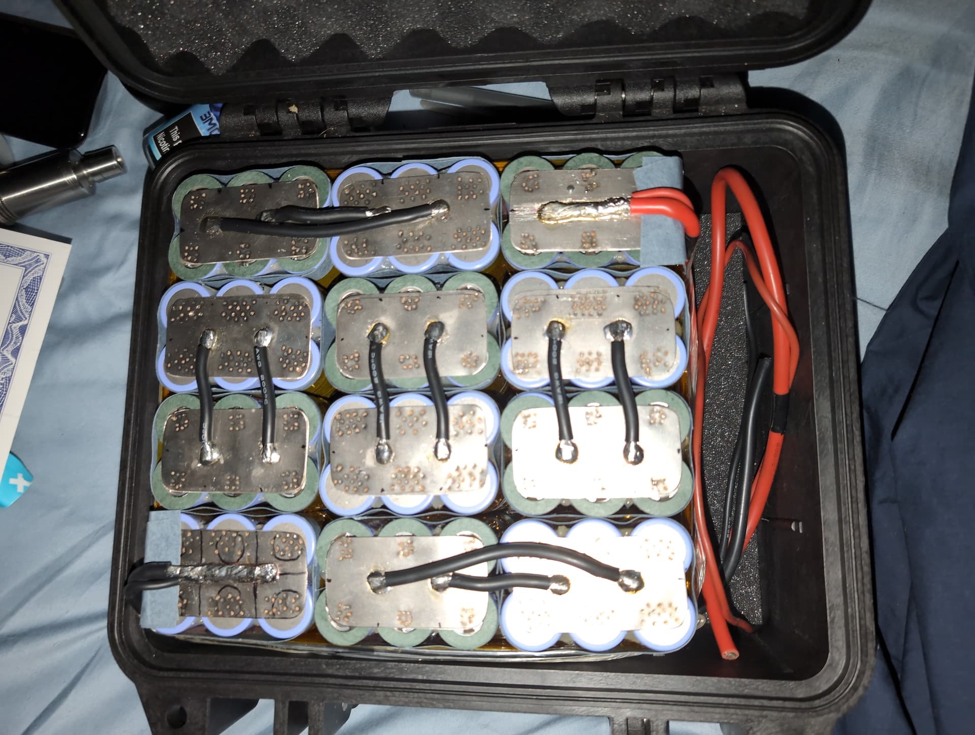

  4. I’m 6’4 and 210lbs I like to ride fast and hard. I don’t want to drag my board up hills because it doesn’t have the power to go up. I currently am building a 12s6p 40t pack. It is not complete so I am now trying to decide if I should keep it 12s6p or bump it up to 14s or 16s6p. I may be able to fit 14s into the pelican 1200 if I go 1600 I will need a bigger box. What are your thoughts?

Quite a few people have fit 12s8p into a peli 1200… 16s6p technically might fit, but I suppose it depends on how much you hate yourself. It would be a difficult build.
Any bigger than a peli 1200 is too big IMO, and after having a 16s6p mtb build, i don’t think i’d want a smaller battery.

Thanks for the response. Sounds like 16p is really the way to go but at least with the way my pack is built so far I don’t see anyway to get 16s6p in a 1200 with the bms. I should be able to get 14s6p in there the way it’s built now just adding 2 more parallel packs. Or I may be able to do 16s6p in the pelican 1300 which is same size but 2 inches taller. Or does that extra height get in the way?

So I double checked and I can only fit 14s6p im 8 batteries short of 16s6p. But I don’t know where the bms will go :joy:.
