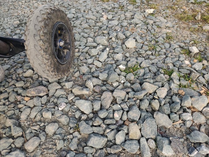

Would you says the Airs handle larger rocks like these good in terms of not disturbing your vision? :smiley: Currently using Trucks from the T and my vision literally goes blurry when riding over those rocks with 30km/h. Can’t see shit.
also not sure what hardness i’d need for speeds up to 60km/h while still being somewhat maneuverable like i currently am with barrels in the inner position at 100kg-

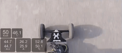

Balanced they are. Ride from today:
on what max speed?
To clarify, i only ride my 60km/h on long flat, smooth roads that i know.
When i’m offroading i’m in the 20-35ish km/h
go figure haha
