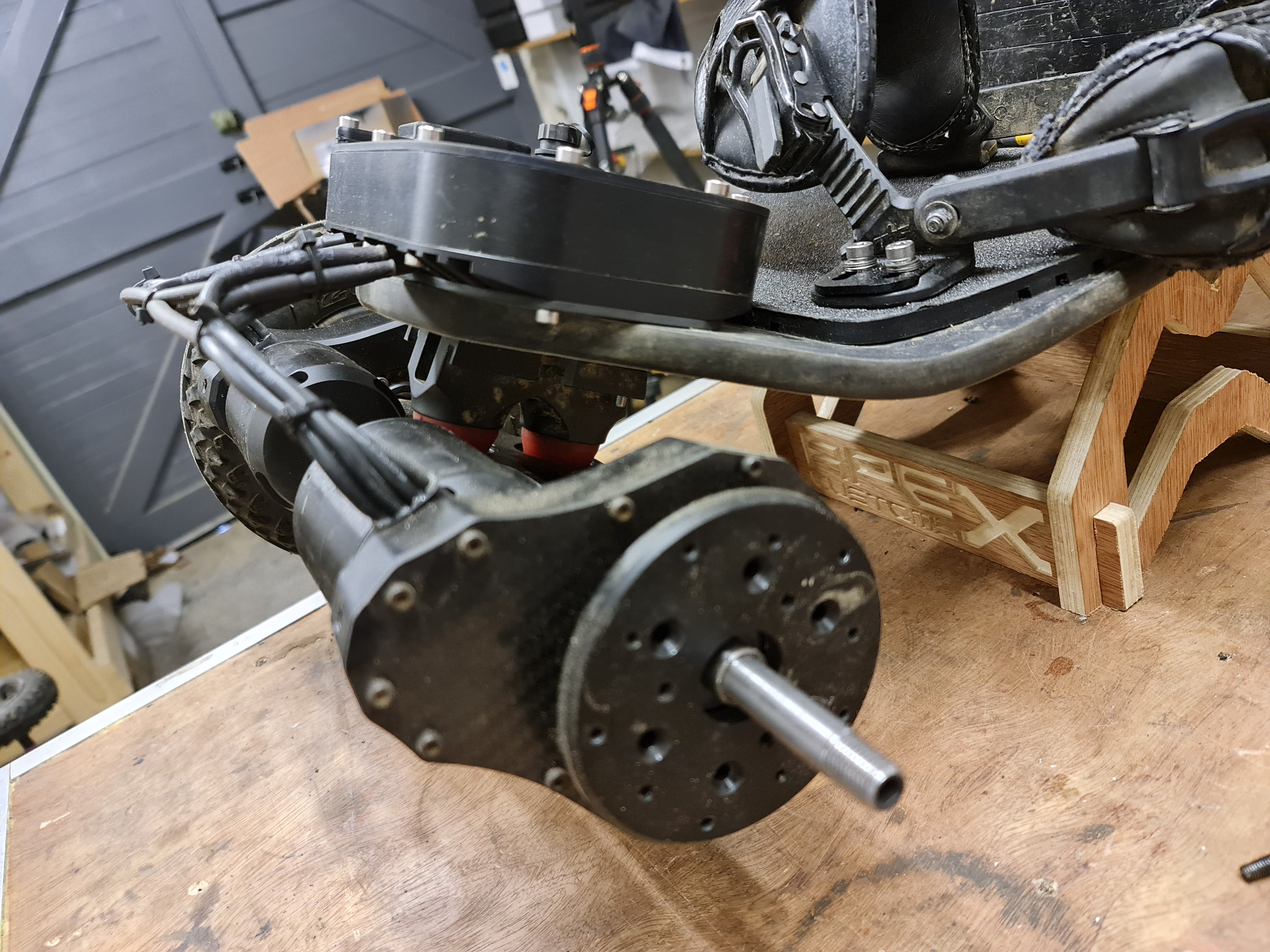

They work with Moon drives, and 3dS etc. Here’s some info for you guys
With Moon drives installed
Hey, I did want to ask. How did you get your ESC enclosure installed on the Haero? Specifically the mount plate. The Bro is so wide at the tips, you can’t really take the enclosure off without taking the mount plate off. Unless I’m just stupid haha
So you see the 4 bolts that bolt through the mount plate and into the base plate? Those are the ones you remove to take the enclosure off (although you never need to do that on our trucks, just 2 kingpin nuts and the whole hanger is free) this leaves the mount plate bolted to the deck with the truck bolts.
For the bro, you will be able to tighten the top two no issues, but the bottom two the deck is in the way. What I do is I use the mount plate as a drill guide and put a 4mm hole through the deck, then use a 35mm M4 bolt and washer and bolt through the deck, through the mount plate and into the base plate. Looks super neat actually.
