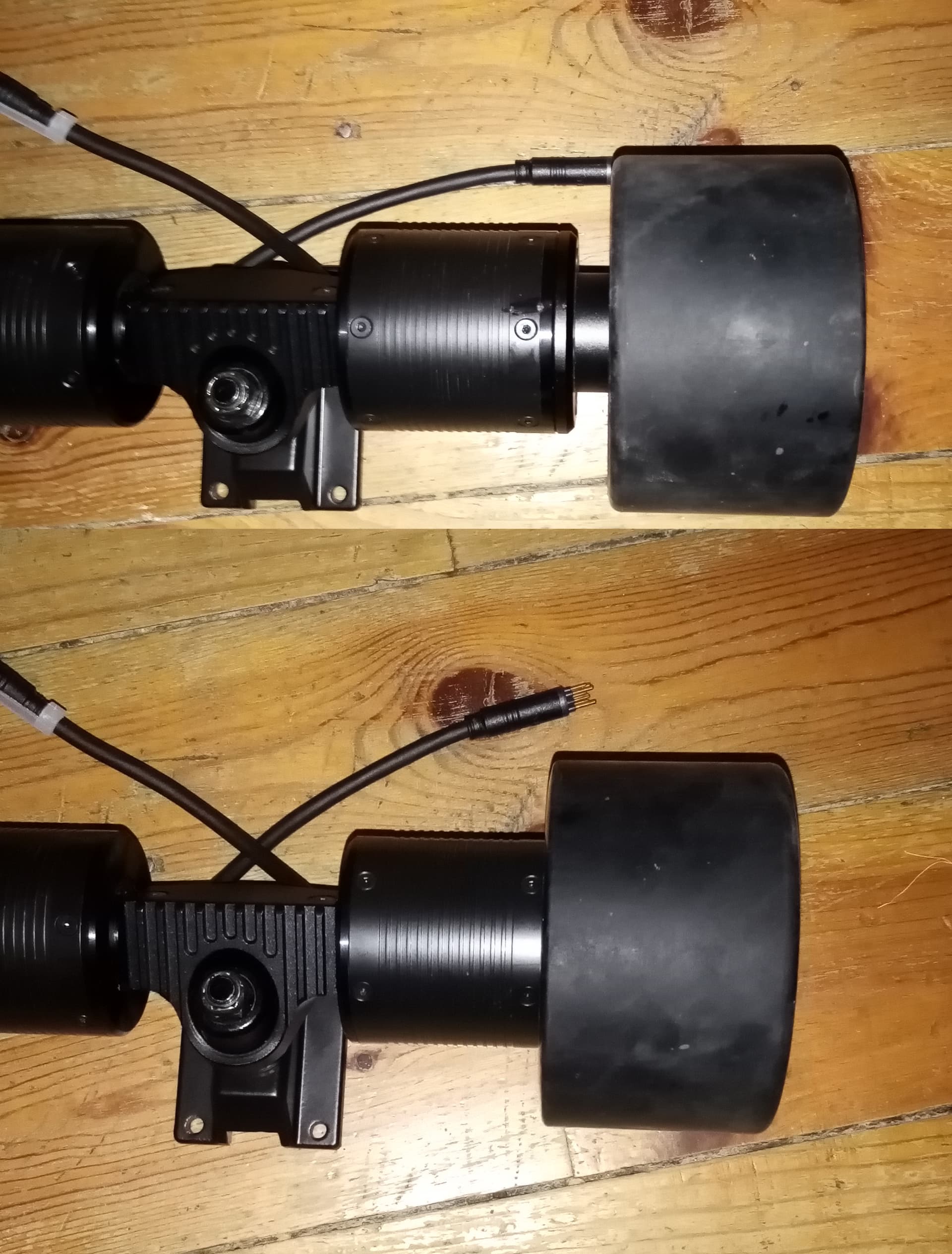

My TB110 have an offset core which create a gap with the motor
So I had an idea… turn the wheel 180° and voilààààà!
(That’s also good because the front truck I received is shorter than the rear axle :joy:)

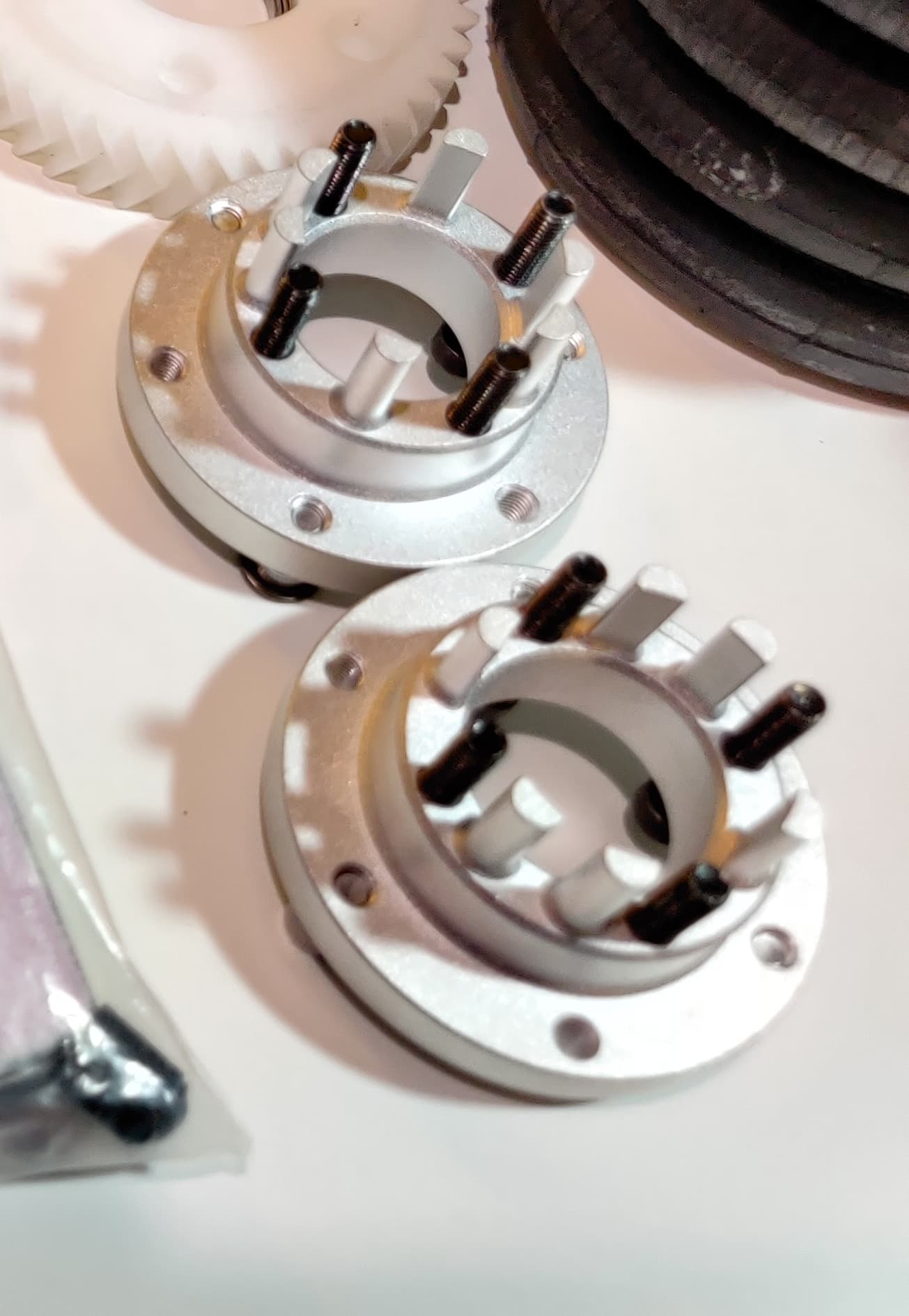

should be fine as long as spokes goes in enough the core
my fucking chrome won’t let me upload pic…for some reason
Yeah it’s the same except I don’t have the black spokes
So probably gonna break after 10 km :joy:
the black spokes are just regular cap head screws, they are needed for one of the two cores (and of course i don’t remember which one :joy:

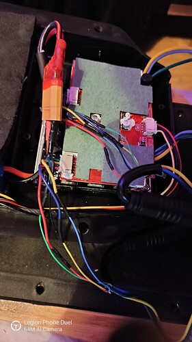

Just a quicky to say my small wires have two switched. Blue and yellow were swapped. Maybe just to get it spinning the right way with the dumb esc. Im sure i read these multi pin higo connectors are only rated for 700w so best to ditch them.
I fitted the esc they sent me even though it has no antenna plug. They say its not needed. Just waiting for the glue to set. There was no thermal paste between the heat sink and some lumps of stray iron made a nice air gap instead.
Fingers crossed this might work now. The battery labelled 25r cells are pink so probably BAK cells not samsung lol

As long as the spokes of the drive adaptor fits into the wheel well enough :man_shrugging:

I’m more concerns about motor/axle length actually
But I’ll have to try, for science at least

Yeah its only the sensor wires that are switched. The rest looks run of the mill. New esc hasnt fixed it and I heard a funny click earlier. Think i got the motors hot and undid the magnet glue maybe
