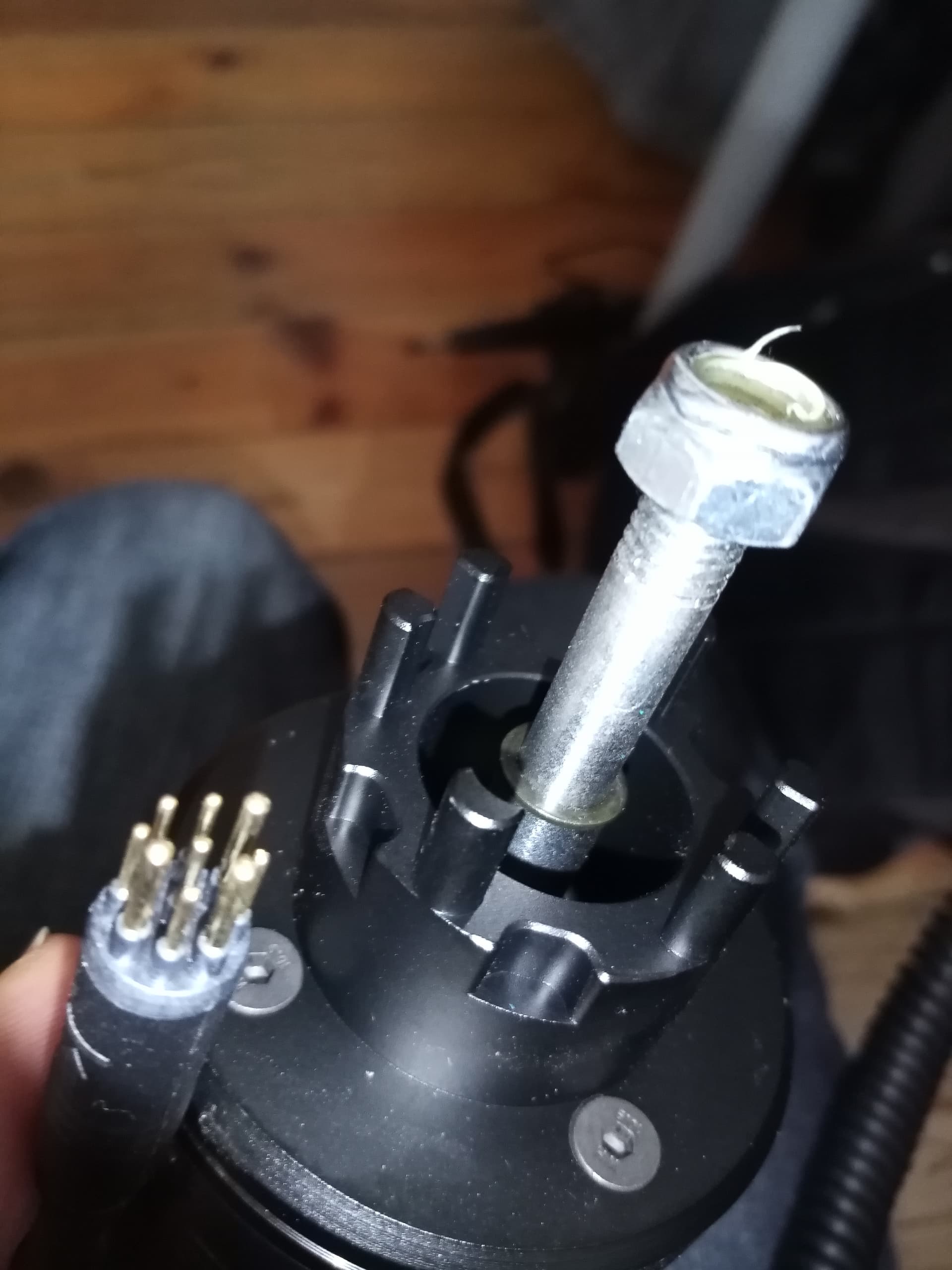

Do you know those adapters? Looks like they are hybrids kegel And ABEC

Also who knows what is the schematics of this plug? It’s phases + sensor?

Thanks, now let’s pray they respected the standard… :stuck_out_tongue:
If you chop that plug off, chances are good that the wires inside will be something like this:
3 bigger wires:
  • Phases: Color/order doesn’t matter if you’re running them on a VESC.
6 smaller wires:
  • Red: 3V or 5V to feed the sensors.
  • Black: ground.
  • White: temp sensor
  • Blue/Yellow/Green (maybe): These three are your hall sensors, color/order doesnt matter if you’re running them on a VESC.

And what about this adapter?
Have you ever seen this?
I swear theyr came with ABEC wheels but my TB110 seems to also fit :sweat_smile:
certainly looks like a hybrid adapter, mainly question would be does it fit all 3 type of core, real abec / fake abec and kegel
You know for a fact or you suppose?
I didn’t push my kegel wheels too much but even if it seems to get in, the wheel was not as close to the drive as the ABEC core one
i know another hybrid adapter exist, but it was a gear drive, and i have that drivetrain, so i know it works for both core (either real or fake abec, i forgot)
this dd adapter could have just implemented the same pattern on their adapter to make it work
