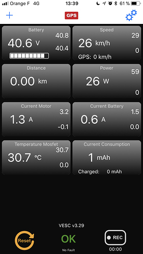

You can try this one
Last time I used it the log file read out wasn’t possible anymore, but live data should still work and it displays you pcb and motor temp as well.
Thanks Andy, just downloaded and it also doesn’t show motor temperature
I think I will just hook a display to an Arduino and tape it to the handlebars
It does show motor temp! Maybe not by default but I have it on.
One thing about temp measurement I found out is, that the closer the sensor wires routed to the phase wires the more the values jump up and down. Like 10-15 degree. If you want accurate measurements it might make a sense to shield the sensor wires or route them away from the phase wires.
Thanks
I didn’t realize you had to be connected to add more stats
