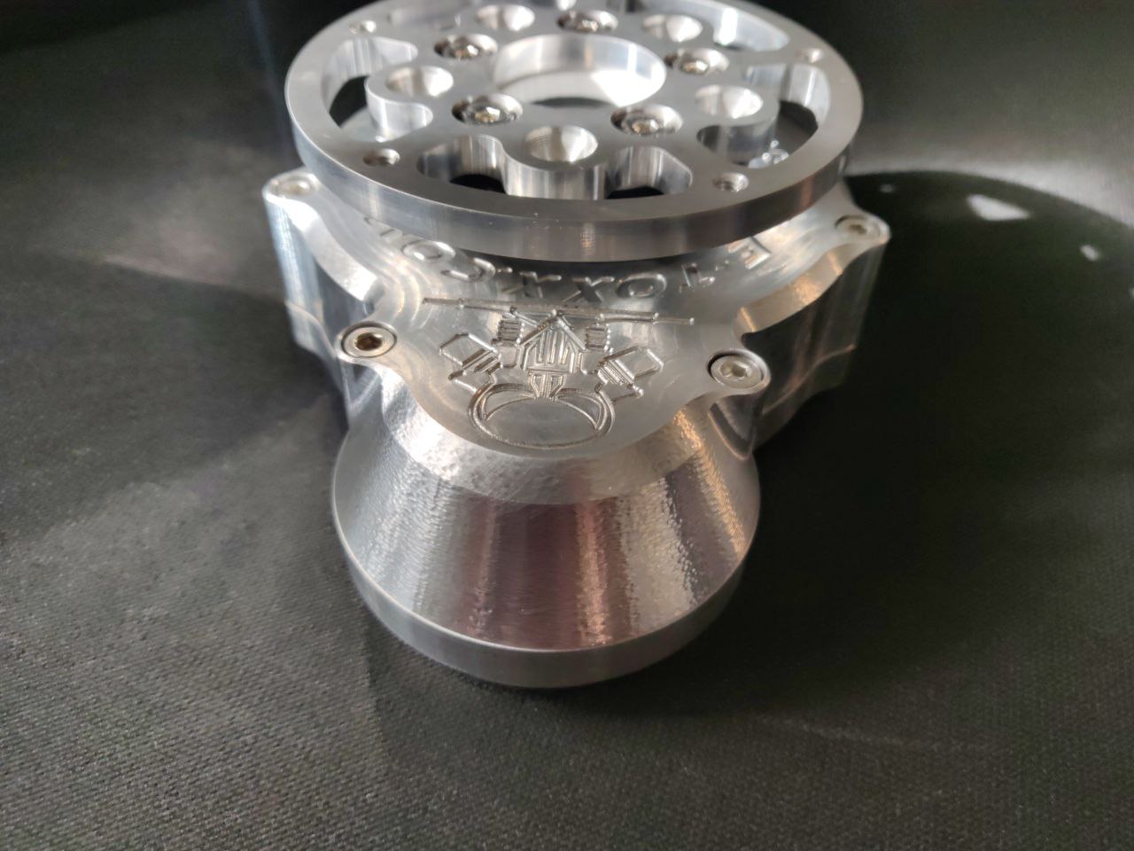

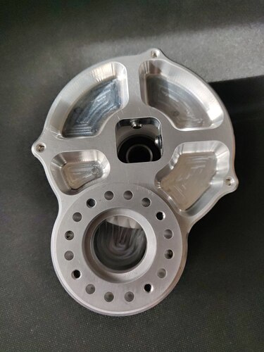

My E-toxx helicals are whisper quiet.

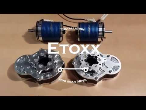

I assume u put them together like in this video.

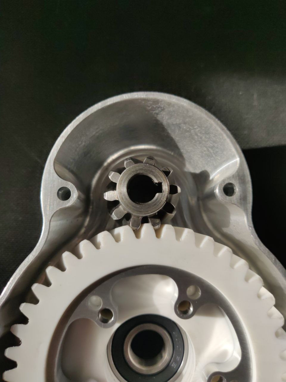

Is the black gear metal?
Is the axial load on what I imagine are small motor bearings within their rated load ability? Maybe they use some specific motors. I don’t know anything about them but interested
They are POM. The latest version uses White POM and a 2 piece body, not 3 like with the older design.

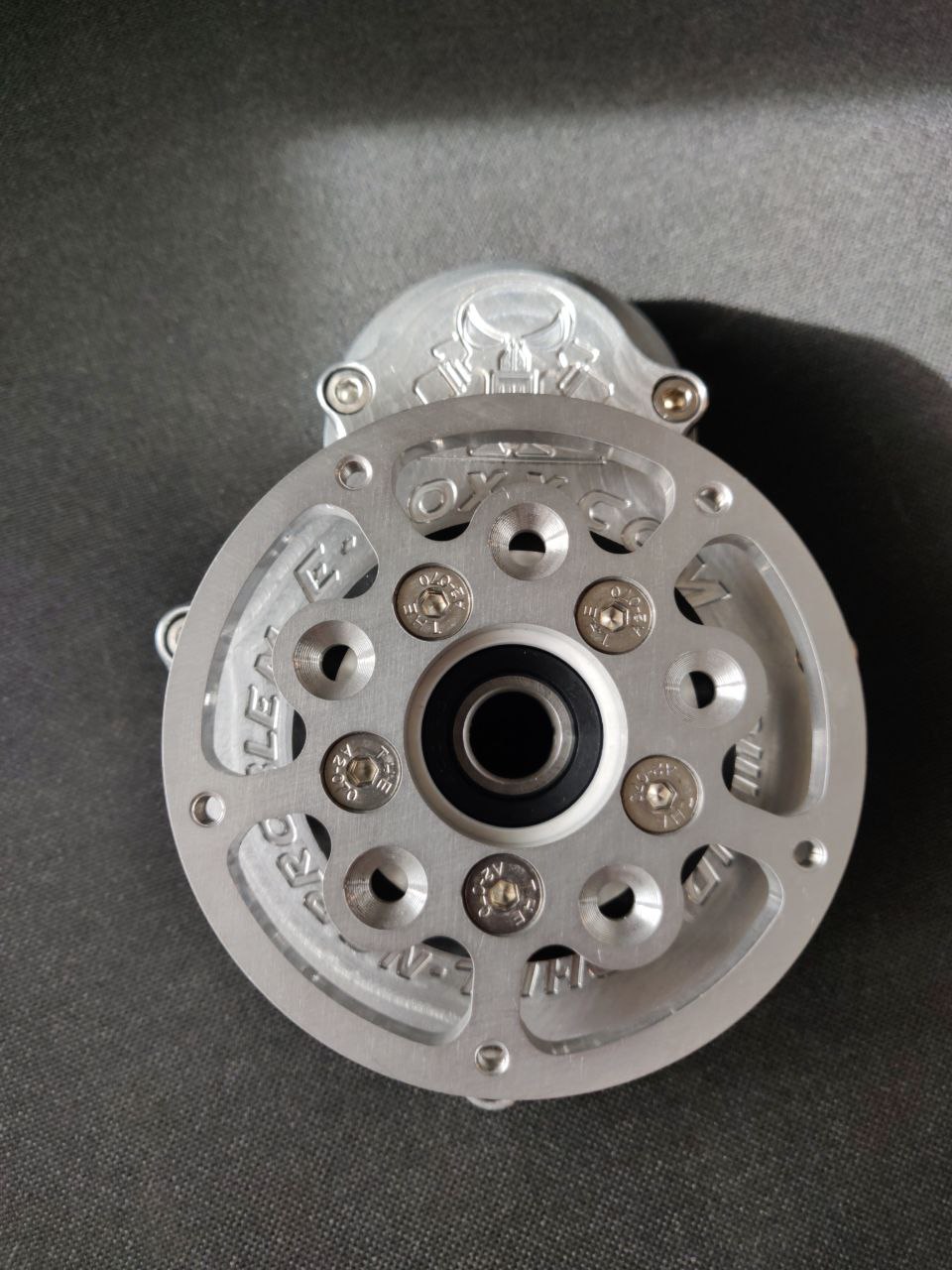

i believe you only have a bearing in the big gear. The Motor gets shimmed. No additional “anti helical load” measures.
The hub plate gets bolted to the big gear and is separated by a V-seal
