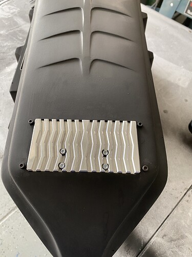

I’m interested in your anti-sink plates and ESC heatsink. Two questions for you:
  1. Do you sell screws for any of these?
  2. Any recommendations for how to make sure that an ESC mounted to your heatsink has a watertight seal? Usual M5 flat heads with some loctite? Maybe grommets on the ESC side?
Thanks!
@goodmove We can provide the screws and lock nuts for the antisink plates. For the heat sink, it only fits the xenith and focbox unity just to let you know. For that, we provide the m3 screws with rubber washers to seal the sink to the esc. From there, you need to seal the heat sink to the enclosure after the cut out. Some might use butyl tape, silicone, etc.
That said, I machined a groove in my heat sink to accommodate for a square ā€œo ring groove to seal to the enclosure. I’m still testing this out though.
I’ll post pics of it tomorrow
That all sounds great! I’ll reach out about one or both of these soon. Need to take inventory. Looking forward to seeing the pics too.
Square o rings like these?
What’s the size of the groove/what size ring do you recommend?
@goodmove, I tested the square o ring groove milled into the heat sink. I don’t think it is a good option for the following reason…
The inner surface of the enclosure can vary in flatness, which would require tightening the screws that secure the heat sink to the enclosure to tight. I thought it might be a viable option, but no. Just being honest.
Just seal that surface with silicone, butle tape, or any closed cell rubber/foam You don’t even really need to use the holes provided to secure the heat sink to the enclosure. The heat sink can become one with the enclosure.
If anybody would like to chime in on this, please do!
@Savage1 Thanks! Here’s the plan so far: use sealing screws (screws with o-rings) to mount the heatsink to the enclosure with a neoprene gasket (or just four strips), between the heatsink and the enclosure. Alternative butyl tape or silicone strips instead of neoprene. I’ve also thought about using sealing washers on the inside of the enclosure, but it might be overkill. Thoughts?
Also, what did you want to do about that outline/overlay? Is it something I can print on paper and cut out?
I used 2mm thick sorbothane strips (pricy, but I had a roll of it) I also laid a bead of silicone around that
PM @RideNebula and he can email you a the stencil to trace around. Word of advice when cutting the enclosure… Cut inside the lines and have a flat and round file to bring it in to fit. little extra work, but even small gaps look like crap
