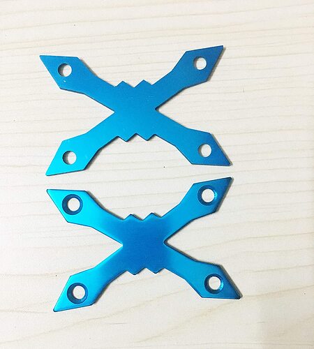

Would it be wise to get anti sink plates especially if im going to top mount on a drop through deck? I was looking at these. Cheap and will come overnight
For those who dont wanna click a link i attatched a pic of what im talking about

Janux has better ones that are much thicker

You don’t need a deck protector, but I’d definitely recommend running one if you can, realistically anything will work just fine and it’s a matter of personal preference, getting some fender washers or the decorative colored aluminum washers would be enough to keep it from splitting
But the X ones look stupid on top mounted drop through decks because you can just see right past them

To be fair i could just get cheap aluminum plates and just drill the sink holes myself
You can just ride without them, order what you think will look the best and ride until then
Sucky part is i cant. Ive got torqueboards tb40 deck and the holes dont have that little groove around it to sink the screws. Just a straight hole down and i dont wanna force a screw in and risk cracking the deck
Just use a washer or a pan head screw
3d print ? Not sure If You have printer but this is faster solution. If You doubt about quality, You can later go to aluminium solution. Just 3D print give You time to buy something robust. By the way Iam riding on 3D printed from Petg and no issue. https://grabcad.com/library/anti-sink-plate-by-facko-1

Ive actually got a cr6-se and a bunch of petg. Would petg be strong enough though?
O crap nvm i read the rest of what you said lol. Thanks ill definitely print these! What infill % did you use?
Definitly 100% infill. Petg will works great. Iam recomending so accurate print, as is for You possible. Printing position on printer need to be same like mounting position on board. Printing time is not an issue, quality is a target.
