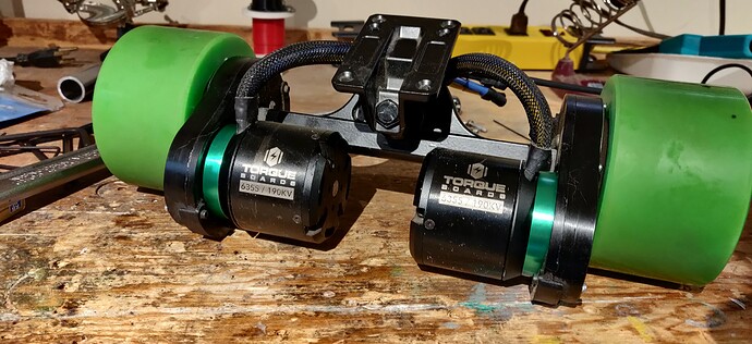

I installed my 10mm aluminum spacers onto my longboard gear drive. They fit a 608 bearing for extra support too if needed, and could probably fit a 6800 with a 3d printed insert.
Pretty slick I think :sunglasses:. I think I could have gone with a slightly lighter shade to match the wheels, but I like it.
They’re really good if you don’t want to cut down your shaft so much, or if you want to attach a 50xx motor instead of a 63xx motor.
Should fit any gear drive and I’ll probably make a bunch more in several different colours if anyone wants some.
Ps. Sorry for my filthy gear drive. I haven’t cleaned it yet :rofl:

I think you would be hard-pressed to find a drive that could take 50/50s without incurring significant damage over time, if not immediately. I will definitely design bash guards for them to help mitigate any cosmetic damage from stone chips and such. The case is fully aluminum though, so I expect that it should hold up well over time.
The gears themselves are steel on steel herringbone gears, which should provide excellent performance over time, as well as preventing the plastic gear damage that has been observed in other gear drives (albeit at the cost of a slightly higher weight). Additionally, I don’t necessarily like the idea of using loctite to hold gears onto the motor shaft, and since the shape of the gears cancels out thrust forces, loctite will not be needed between the pinion and the motor shaft. I also wanted to be able to change gear ratios with very little equipment or downtime. Since there is no loctite to remove, it should be simple to change ratios from a 4.58 to a 5.5 with very little downtime or headache.
