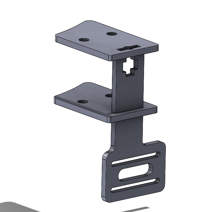

The problem with aluminum is doing the bend unless a generous radius is used, if done like the drawing on the first post it will crack while bending
40 degrees is a lot, Im thinking 15 for my apps.
If youre gonna bend that far you need to heat it
Thatā€™s a valid point.
Given the bend is done without cracking, the material will hold
But if you get a T6 aluminum and heat it to the point itā€™s easier to bend, youā€™ve ruined all the heat treatment, which is what gives the high tensile strength
hmm fair point, materials was never my strength.
do ou think a 15 degree bend will cause it to tear? with a large radius? say 1.5" or so

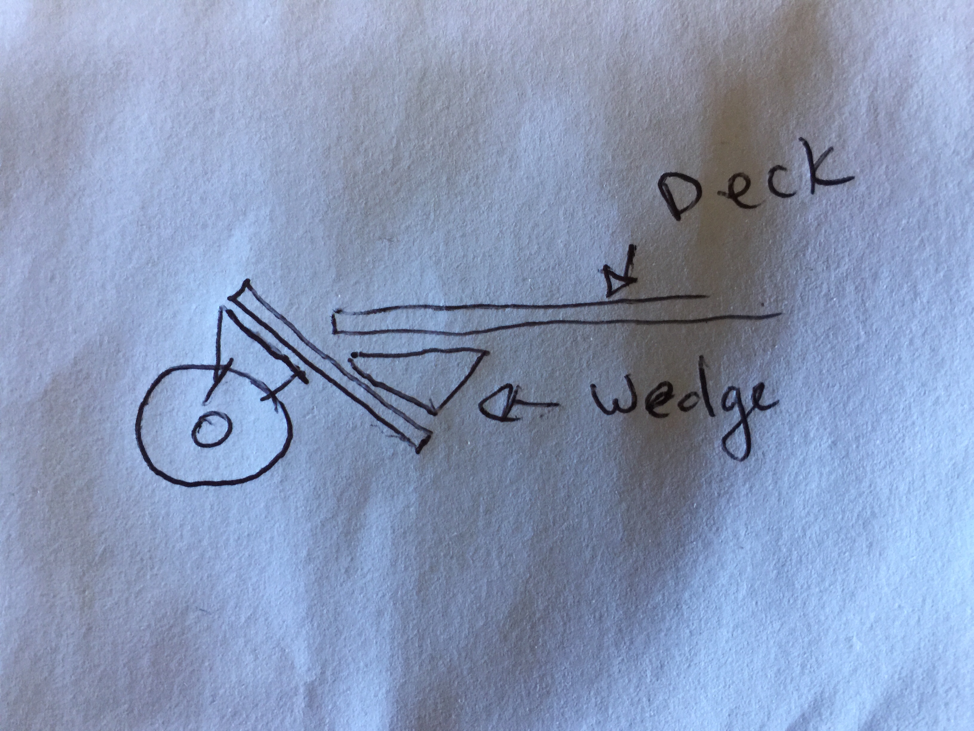

Instead of bending could we make a wedge out of metal and bolt the plate to it?
Behold my 2D rendering

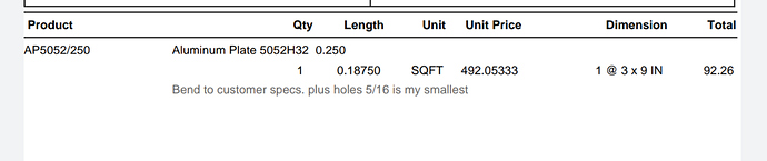

Turns out aint so cheap around here lol. Also the only metal they stocked and could bend was 5052
Did you try quoting in steel? This is something I forgot to mention, I couldnā€™t find a single place that would do aluminum since the cut finish turns rough and they refuse to do, for it itā€™s better do go water jet cutting, but that is expensive
Just to give you an idea for these 3 pieces I paid R$ 18, would be a bit more than $4
If you want I could quote here, but international shipping is crazy expensive
You mean they wont cut aluminum? I though it would be easier to cut than steel. They said they didnt stock steel in the thickness I needed. But the price seems to be mostly in the bending or holepunching bc earlier they quoted $15 for the same size 6061 piece without mods.
