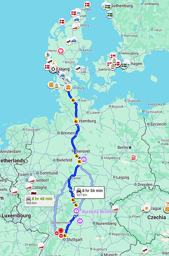

So, to the transportation part. The machine is in south Germany while I live in Denmark.
A 9 hour drive away, right? Very wrong… With a trailer, going slow, taking breaks to regenerate the my brain cells that I lose every moment driving so slow… it’s an insanely long drive. So I went to pickup the trailer:

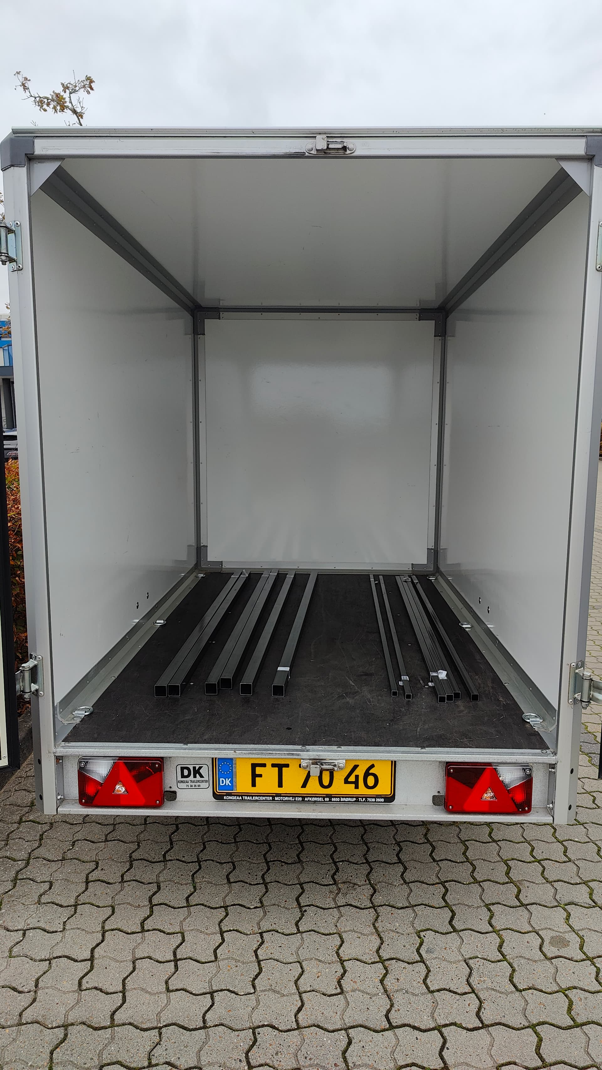

Turns out the company didn’t have the pallet lifters that their website said they have
Which is what I was counting on to load the trailer. When I found this out, I was 23 hours away from the discussed time to pickup the machine. So that meant I went to buy some material to build a ramp:

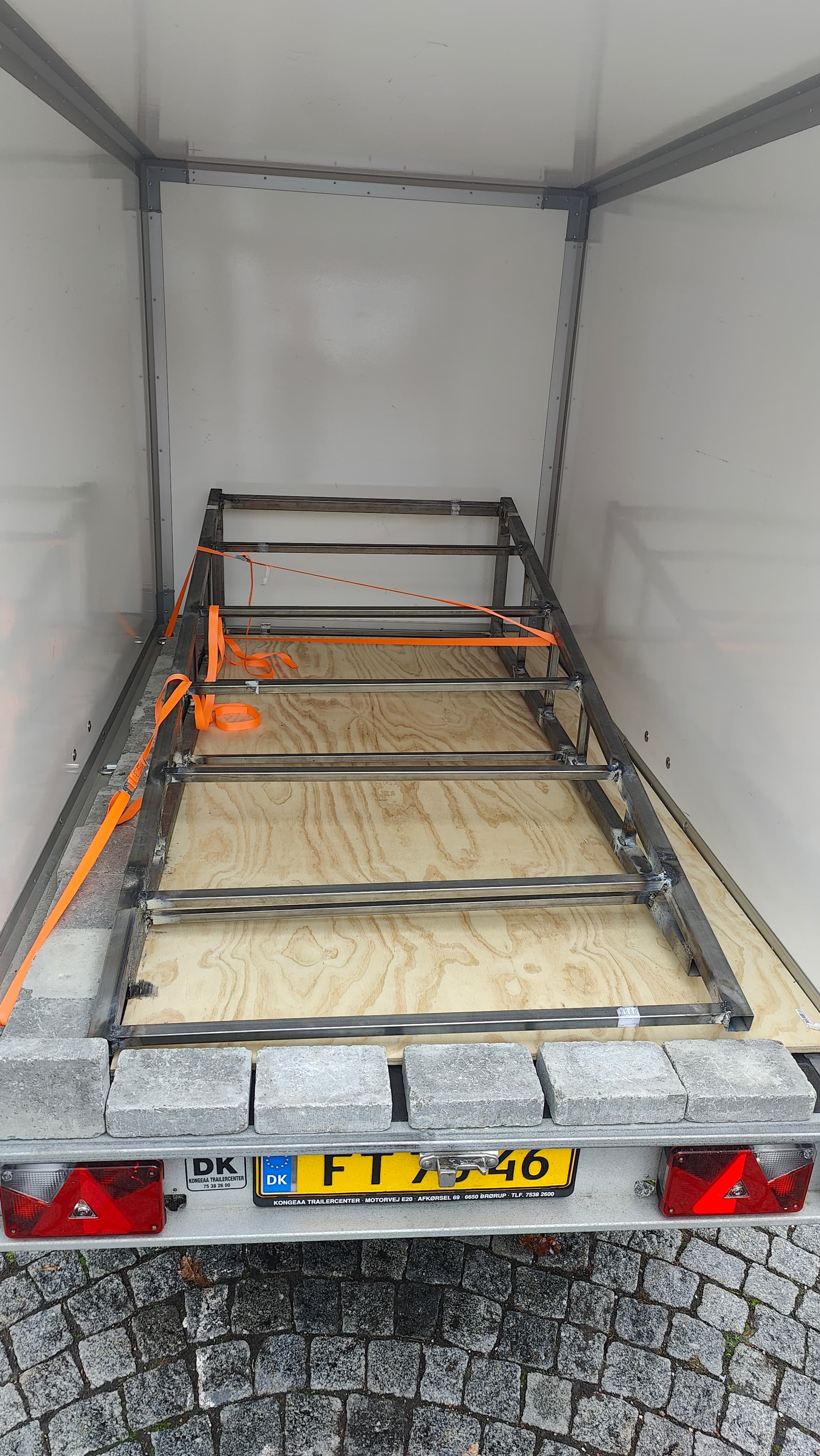

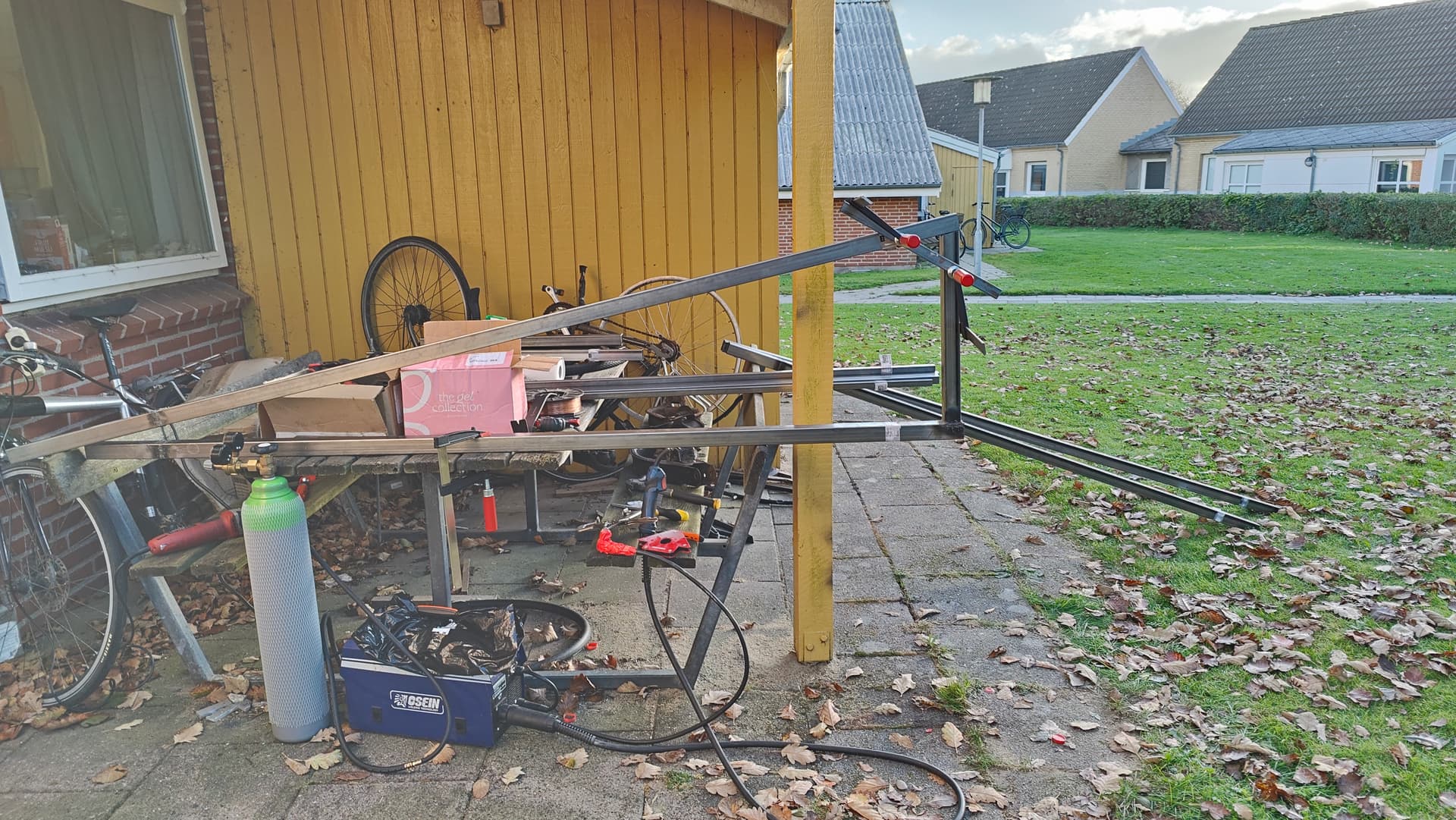

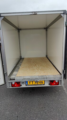

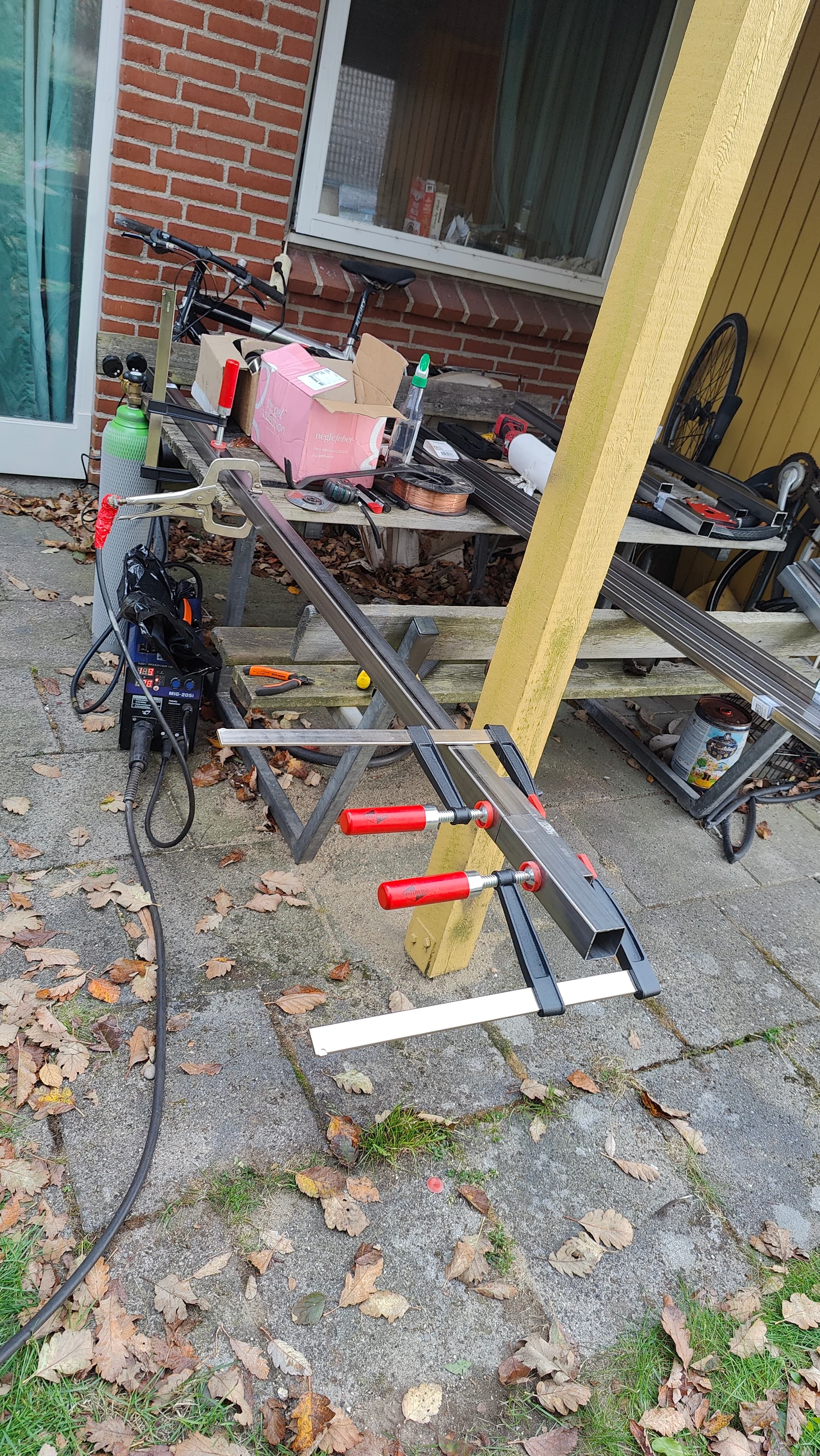

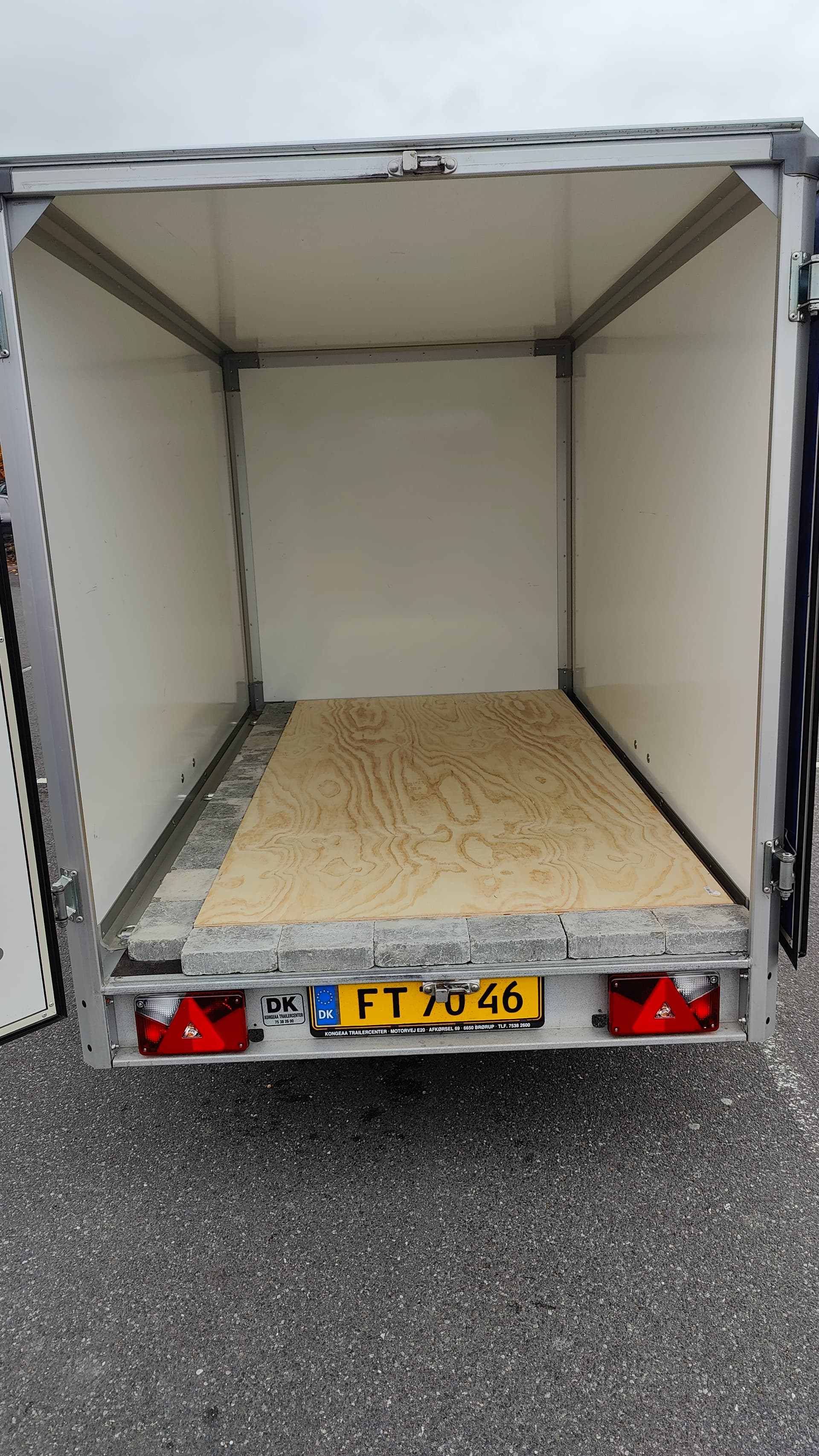

24m of square steel tubing
And a full sheet of plywood plus bricks to put under the trailer to support it while loading, so that it doesn’t flip.

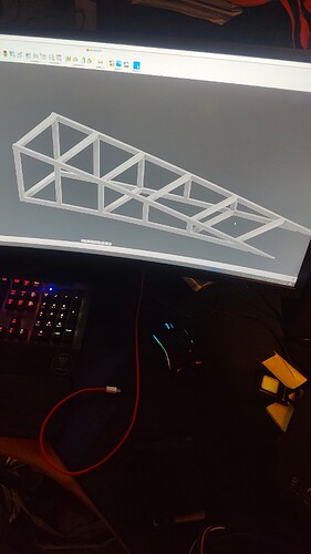

Here’s the rough plan:

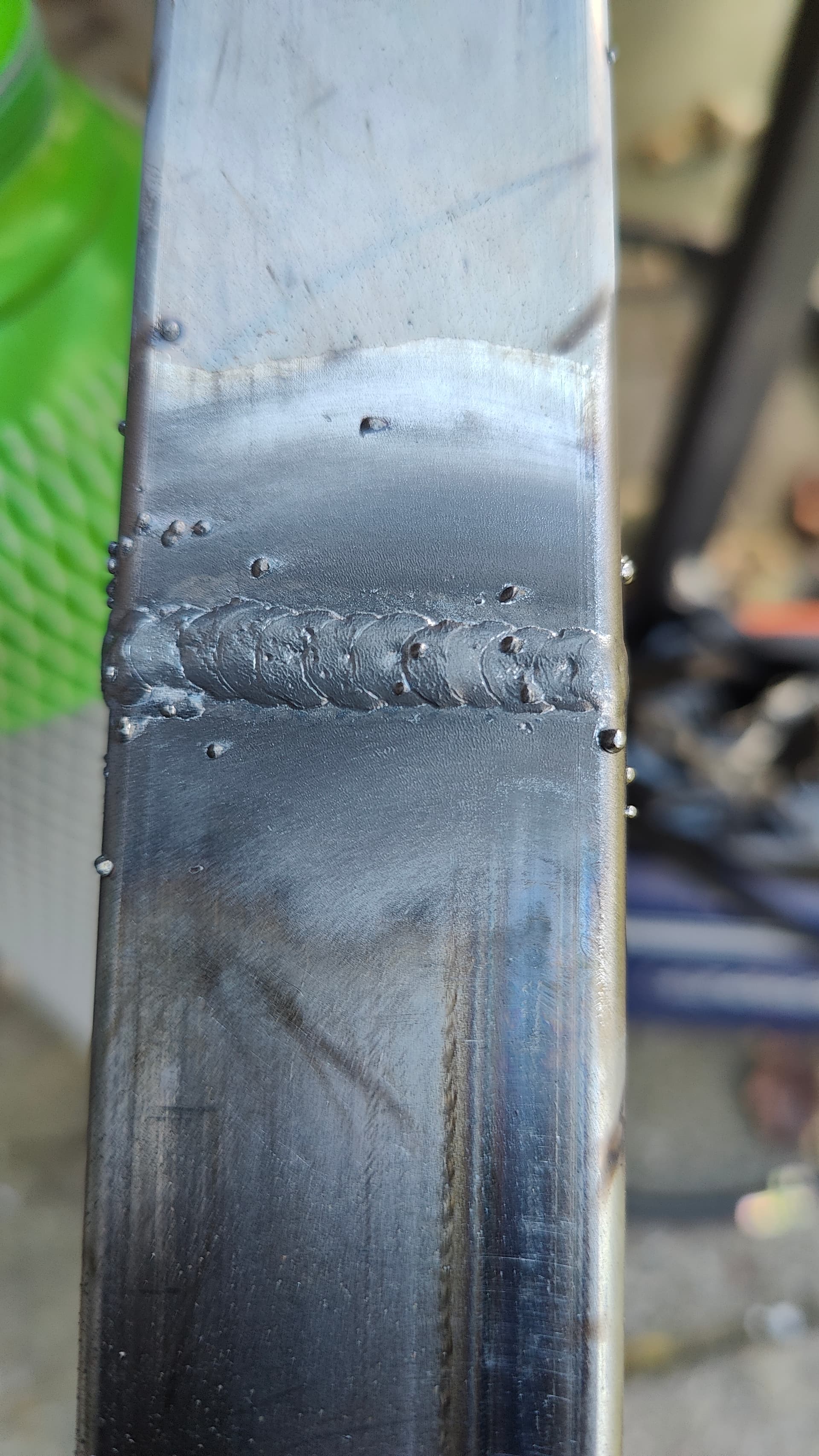

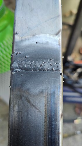

Now onto welding.
Yes I know right outside the house isn’t the perfect setup to weld…
But the weld quality turned out decent I think when I was actually paying attention. The ramp turned out a bit crooked, which isn’t an issue, though it definitely shows that at least having flat ground would be really great…

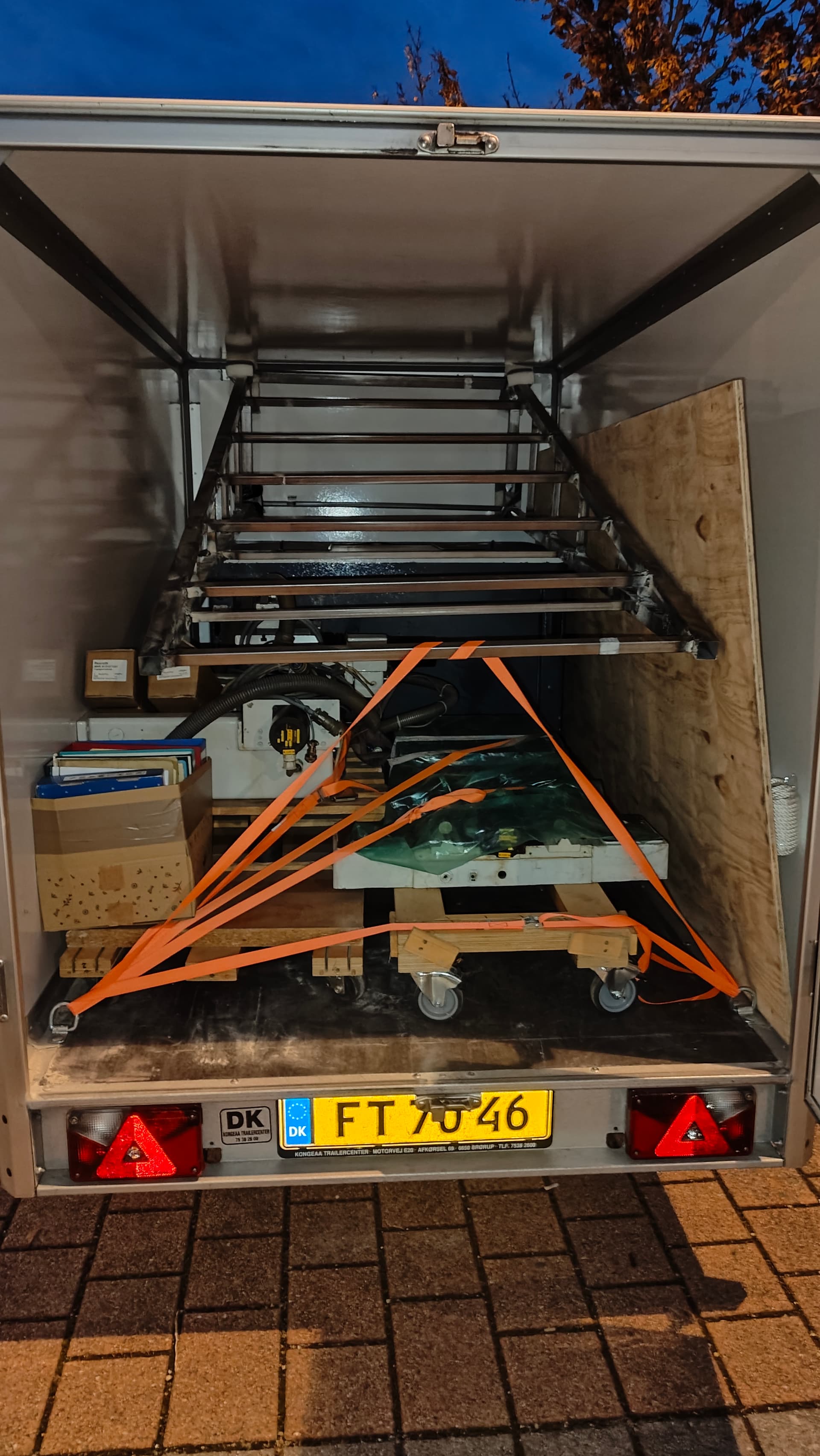

Now to load the ramp into the trailer and start driving:
We are at T-8 hours and no sleep. Remember google maps saying 9 hours? Well that didn’t think about the slight inconvience of a trailer.
So I arrive at T+6.5 hours, taking 14.5 hours on the drive that way, with one hour sleep halfway on the side of the highway, just to reset my body clock. Then we load everything, it took 4 persons to push the wheeled pallets up the ramp, but it was doable.
The rear suspension sits a little low with around 1.3 tonne of trailer weight (most of which is supported by the trailer wheels, but still. It’s within the limits of the trailer and the car, but barely.

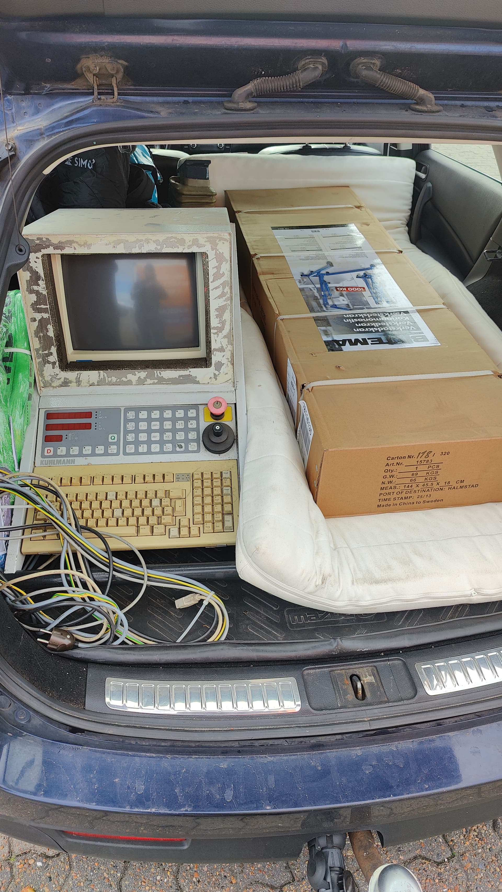

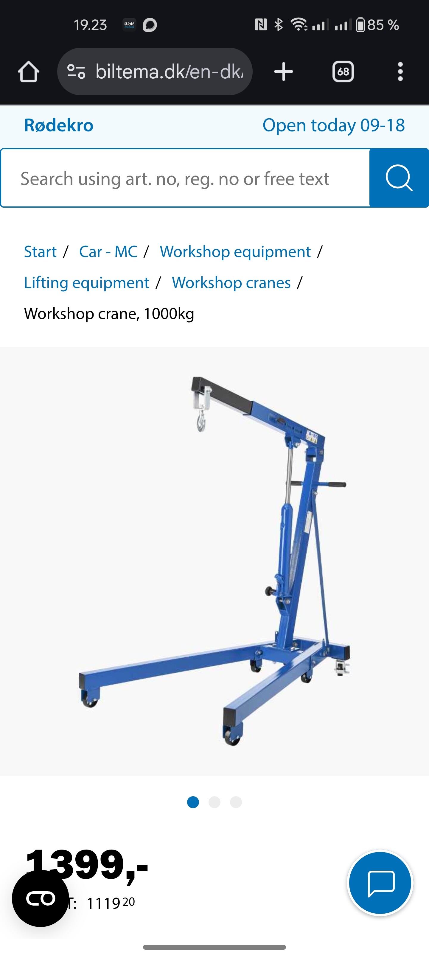

Here’s what I bought at biltema. The engine crane is required for assembly, and turned out to be required for moving the parts of the machine into the house also. With the engine crane and trailer rental and fuel and ramp I paid around 800€ on transportation! That’s actually quite significant and I was expecting around half of that.

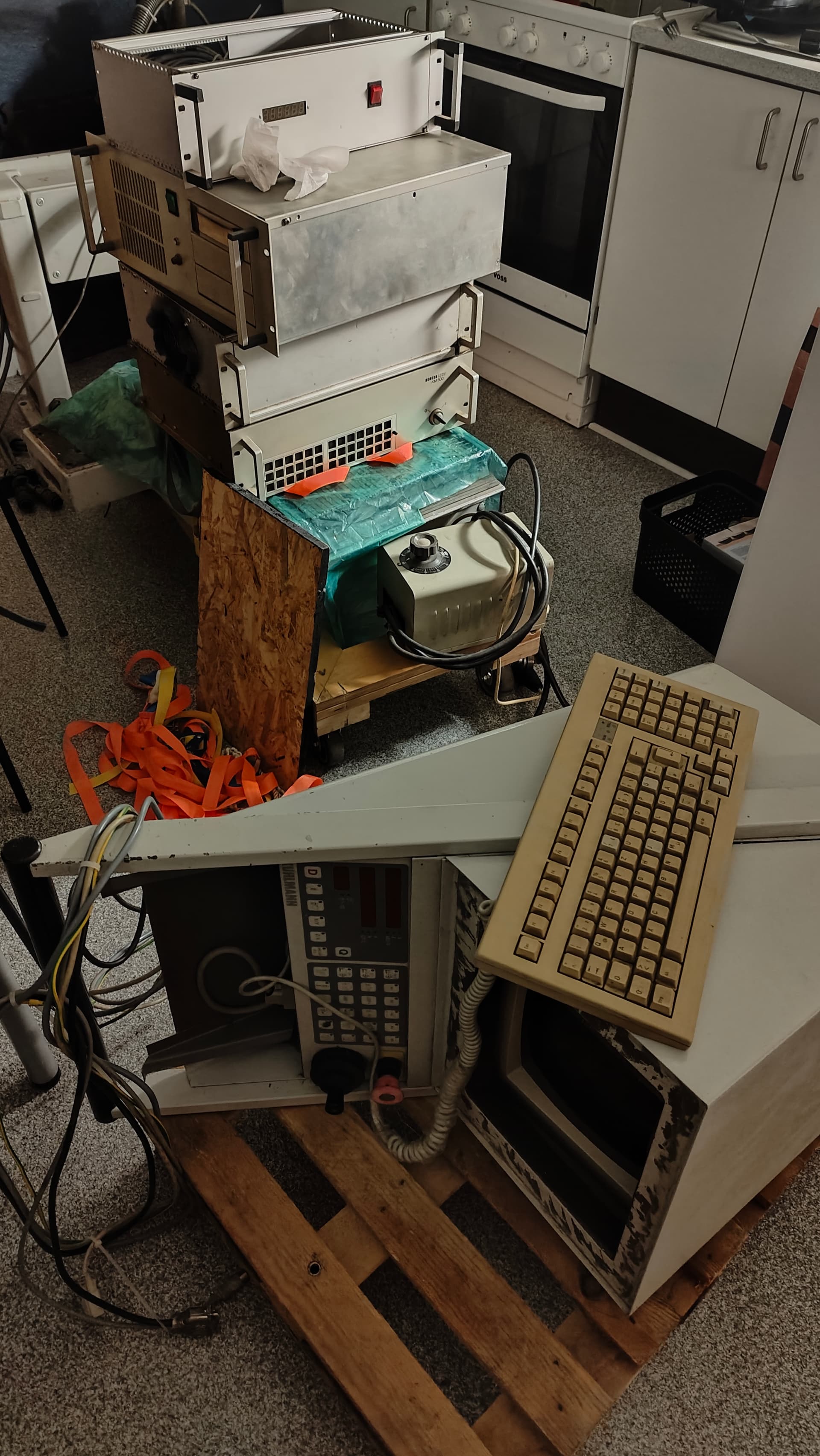

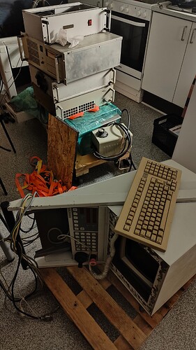

Also look at that electronics:
It’s ancient stuff! The keyboard and the joystick for the controls feels suprisingly nice, definitely keeping that. I guess that’s what 65000€ of late 80s money gets you, keyboard that feels nice after 35 years. :laughing: The rest of the electronics setup I want to go through and take a deeper look to find out what’s usable and what isn’t really.

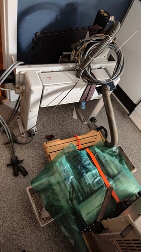

Then onto unloading, which I needed to do right after arriving home. So I started driving to get the trailer 10am wednesday and was going like a machine until saturday midnight, that’s 62 hours. Expecting to wake up to return the trailer by 7am, but I slept through all 10 alarms I set, so I returned it 5 hours late around noon. Then came home and slept again until 6pm.
For unloading we used the ramp and some straps, it wasn’t a big issue. Then we took the parts inside, the bridge and the huge table we needed to flip 90 degree to fit through the door, which we did with the engine crane. Given that I was up like 2 and a half days, I wasn’t really in the mood to take a bunch of pictures.
At this point I left the parts resting inside the kitchen area, I had a long sleep, and we continued 2 days later.

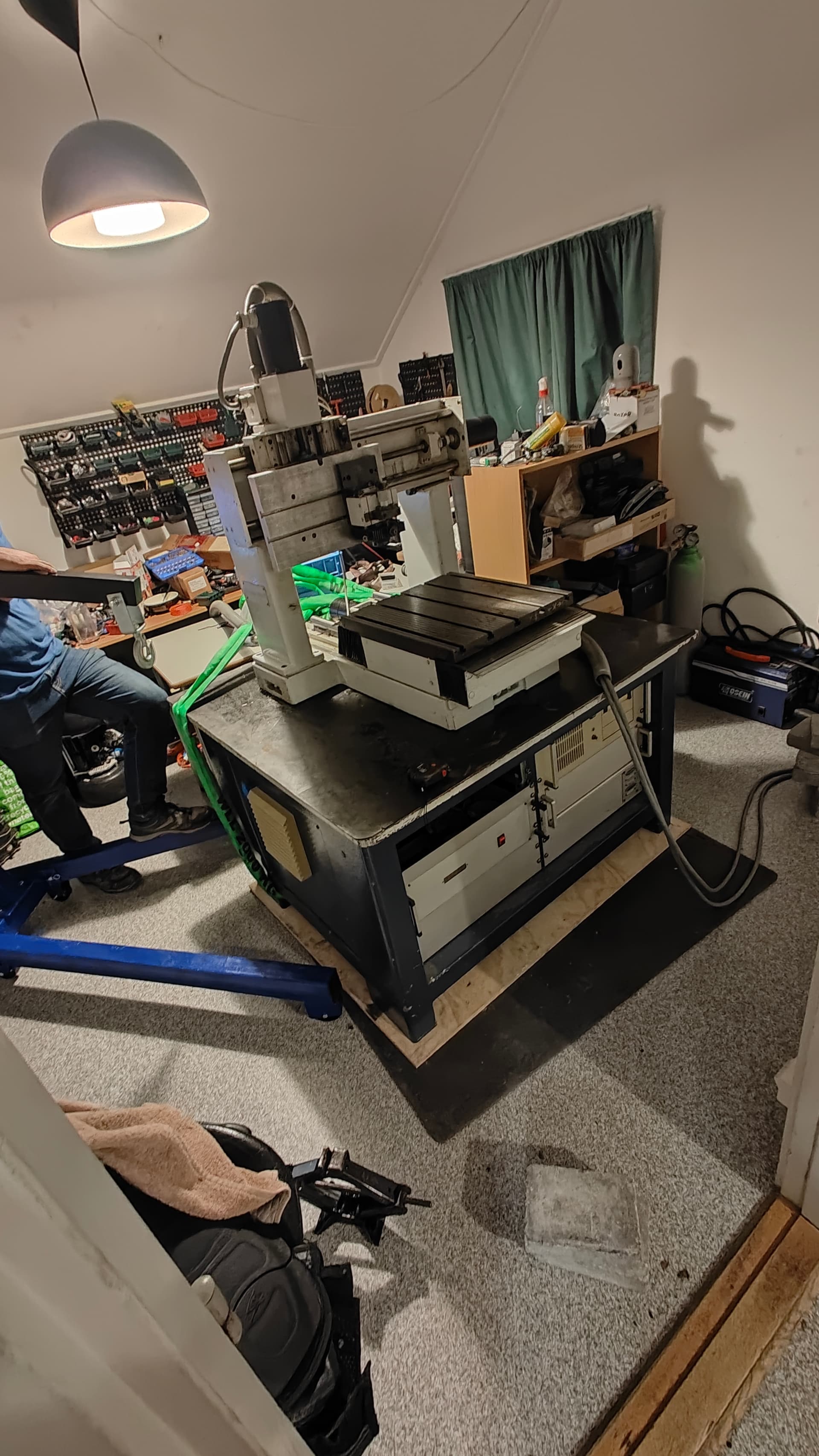

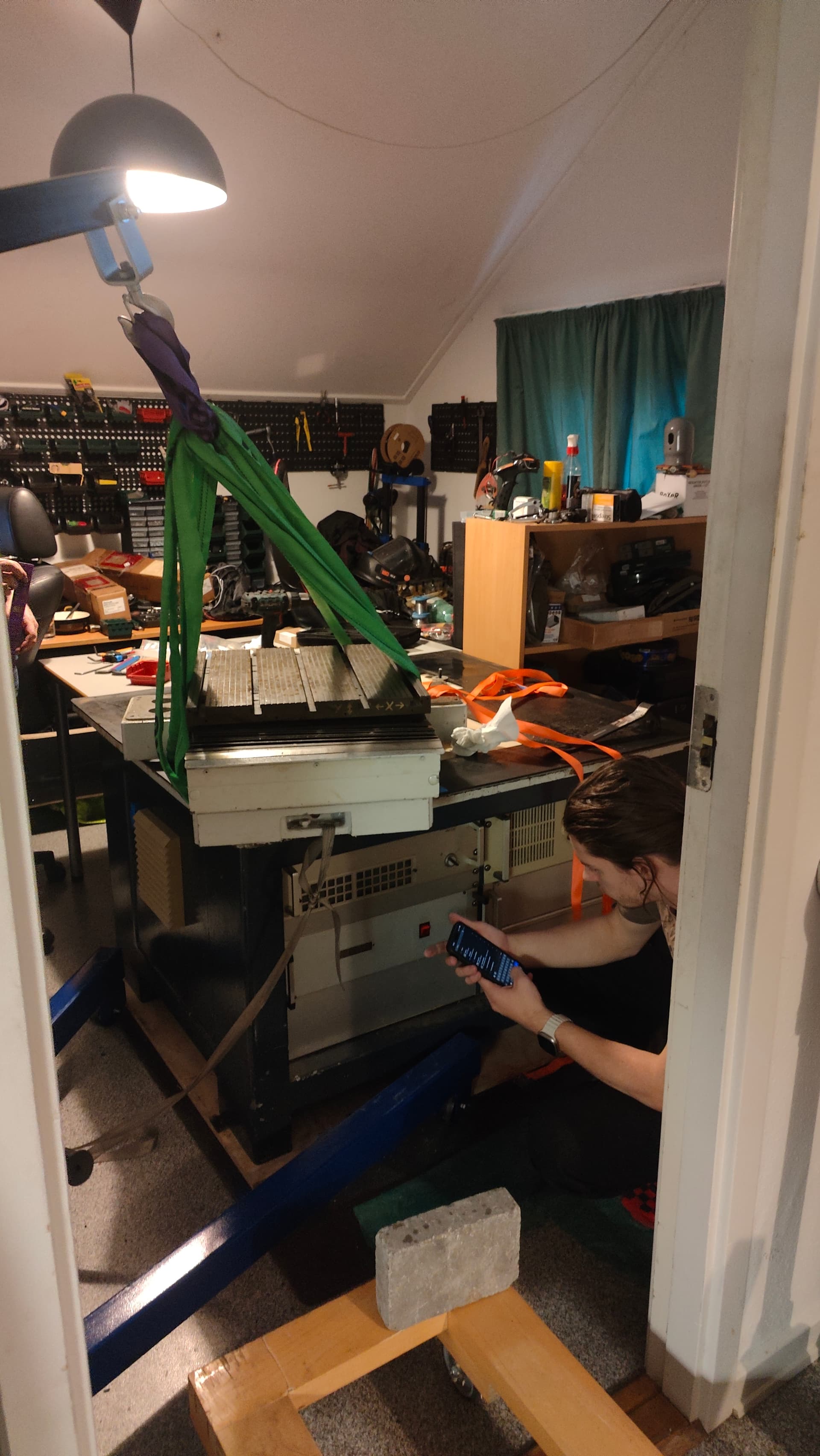

Next up was putting the lower half of the CNC onto the table.
The way we did this is that we used the 1 ton engine crane with a bunch of straps under the cnc’s lower half and we pushed the part sideways onto the table. We realised two things: we need to get the straps out somehow. And the crane like this doesnt allow us to move it far enough onto the table. The solution: jack up the table and put bricks under each leg. That way the engine crane can move in closer to the center of the table.
The next challenging part was that we didnt just need to put this on the table, we needed to put this exactly on 3 studs coming out from the table. Because this needs to be bolted down, that way the table’s weight is also used to dissipate the vibrations that cutting forces make. We first put on end on one stud, lowered it the whole thing down, very loosely bolted that part down, then we lifted just the opposite side. We pulled out the now unused straps, then placed the now lifted side onto the two studs coming out from that side of the table. Then lowered everything down and bolted it down onto the table tightly.
Next up was lifting the bridge up (the higher part of the mill). This was relatively simple, we just moved it over the the base with the engine crane to roughly the correct place, muscled it to the exact place, then bolted it down. I used 8x M10x20 bolts but I should use M10x25, for better thread engagement, or maybe even M10x30. I’ll be changing them out one by one wherever I go to the hardware store next.
Now it finally looks like it’s mostly in one piece! Up to this point was the hard part in terms of logistics, now comes the hard part in terms of actually getting to know the machine, tweak stuff, figure out what needs adjustment, etc.

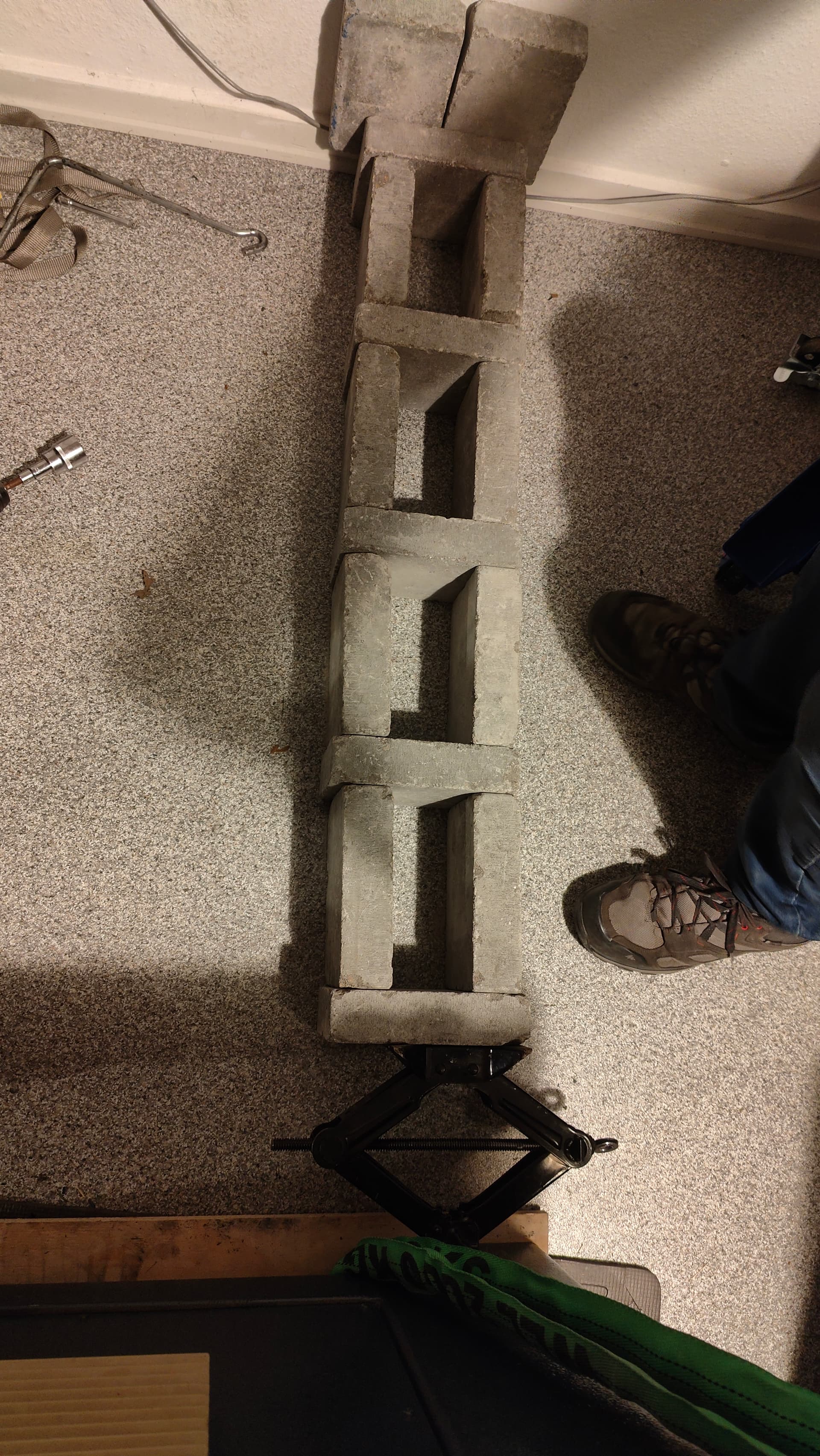

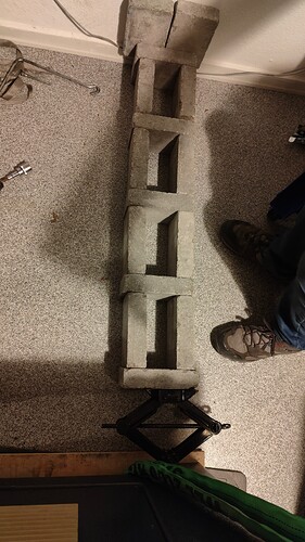

After the machine was in one piece, we needed to get the bricks out from under it that’s relatively simple, lift it up with a low profile car jack and just take the bricks out. Except one small problem, when we did this, the aligment became quite a bit off, we were overhanging from the wood quite a bit.
Then we jacked one side up with the engine crane and sort of muscled it into a usable place on the wood with all our strengths. Now the machine was in the wrong place compared to where it should be in the room, so much so that it was in the way of the door. So we had to get creative.
Good thing we have brick walls! A couple bricks, some hope, and car jack later, the machine was in the correct place in the room! The rubber mat slides on the floor, so everything moves together. So I can move the assembled machine around in the room now, what a nice surprise :grin:

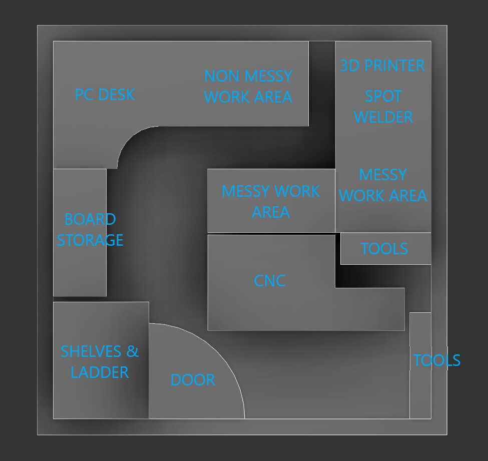

The next thing I found out is that the planned room layout:
Didn’t work out because the wood tabletop of the mill was overhanging 15cm backwards from the base of the table (the steel part) which took away so much room that the table which was supposed to be behind it didn’t leave enough space for me to sit in a chair behind it… So that table was moved to the area marked as board storage. Given that there’s no longer a table there I’ll be moving the CNC a bit further away from the door to give more space for comfort. And need to figure out something new for board storage.

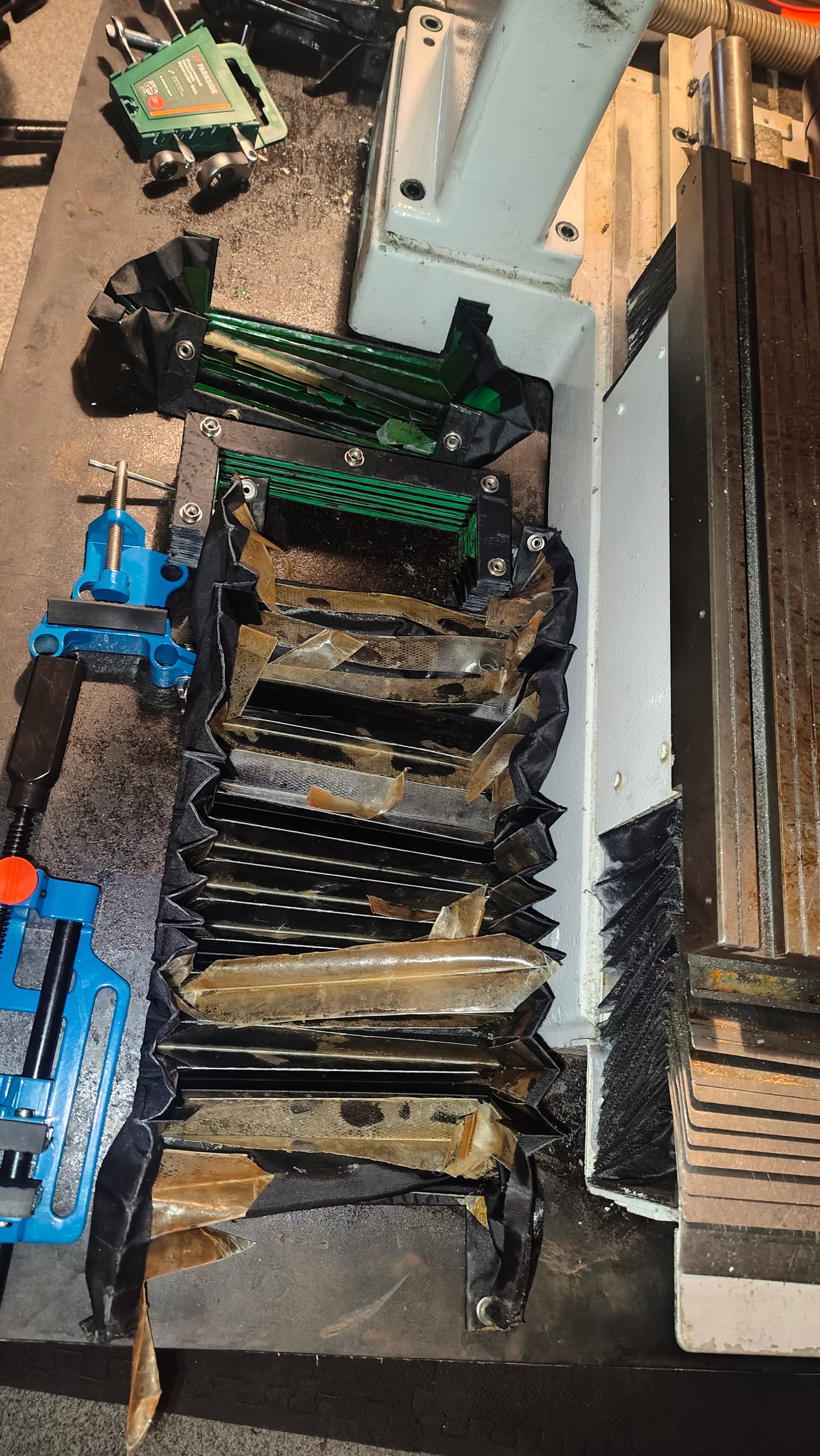

One sideproject before I’d get to the point where I’d be happy with the machine:
The bellows/ way covers are falling apart… at least the ones that I touched… well, they are 37 years old…
Apparently 3d printing replacements from TPU is a thing!
I kinda want to invest in a new printer soon… Thankfully the worktable waycovers are still in one piece (I was careful not to touch those…) the rest I should in theory be able to print on a small printer. I’ll try and fix up the current ones for the short future but now that I discovered it, 3D printed waycovers is something that I want to make for this machine later down the line.

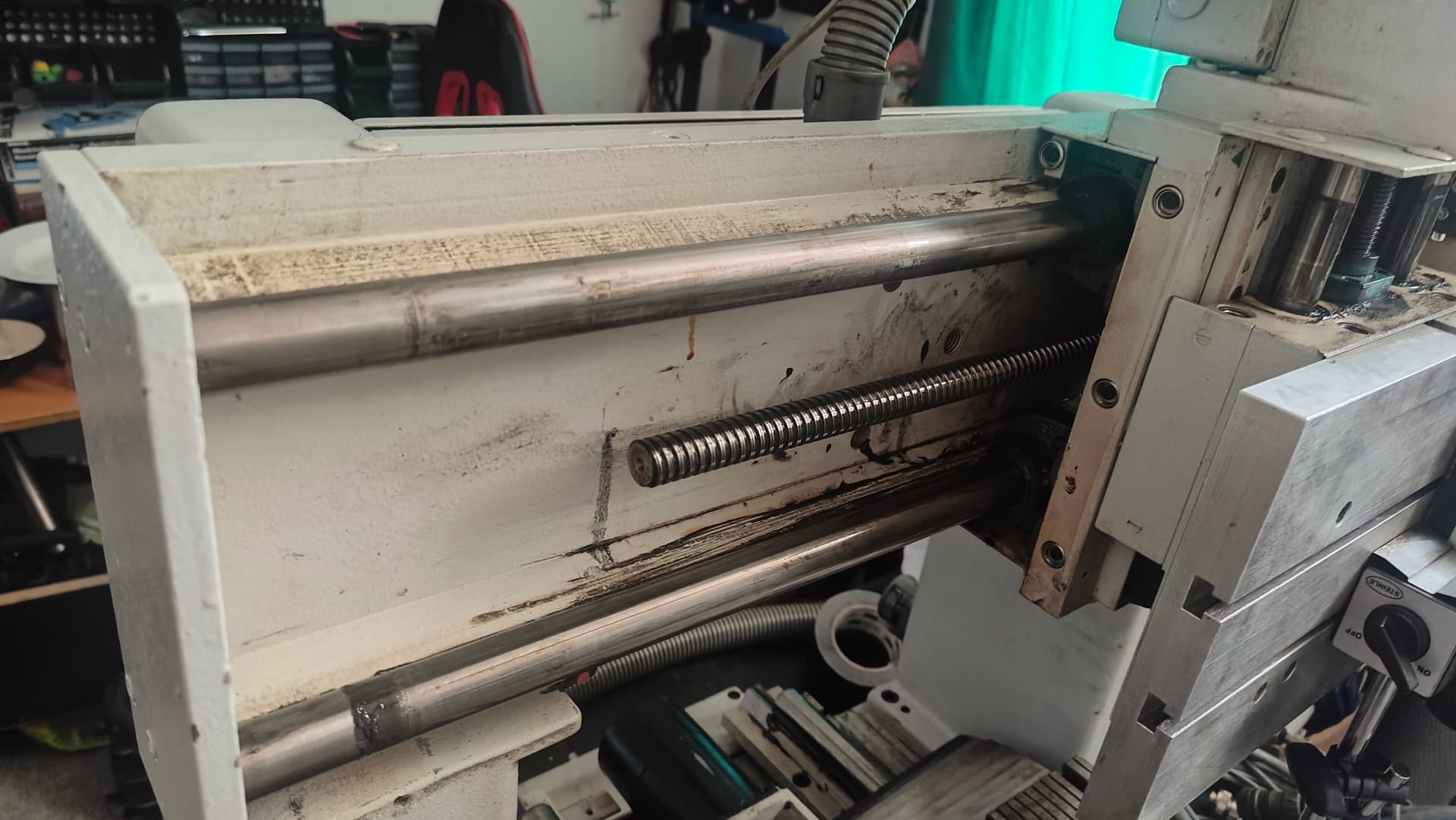

Apparently only one end of the ballscrews is supported. I think that’s a weird design… thought it would make sense to support both. Something to look into later.
Just measured table flatness with my dial indicator and it seems to be within around ± 10 micron for the whole table. That’s actually really damn impressive.
On the other hand, there seems to be around 100 micron backlash on the X axis and close to 150 micron on the Y axis. 0 on the Z axis.
This could mean anything from worn parts to parts that need adjustment. I did get brand new replacement parts for the X and Y axis ballscrews and ballnut, so I should be covered as far as parts go, but I need to find the source of this play and fix it. I am aiming for a backlash in the 10-20 micron range. That balances wear with accuracy. Then have the software apply some compensation for that. I’ll take a deeper look at this backlash after the Brno race which is this weekend.
On the Z axis however the 0 micron backlash also isn’t good. I’m guessing that’s the reason why the Z axis leadscrew looks really worn. Good thing I was planning on replacing the whole Z axis from the start to allow more travel!

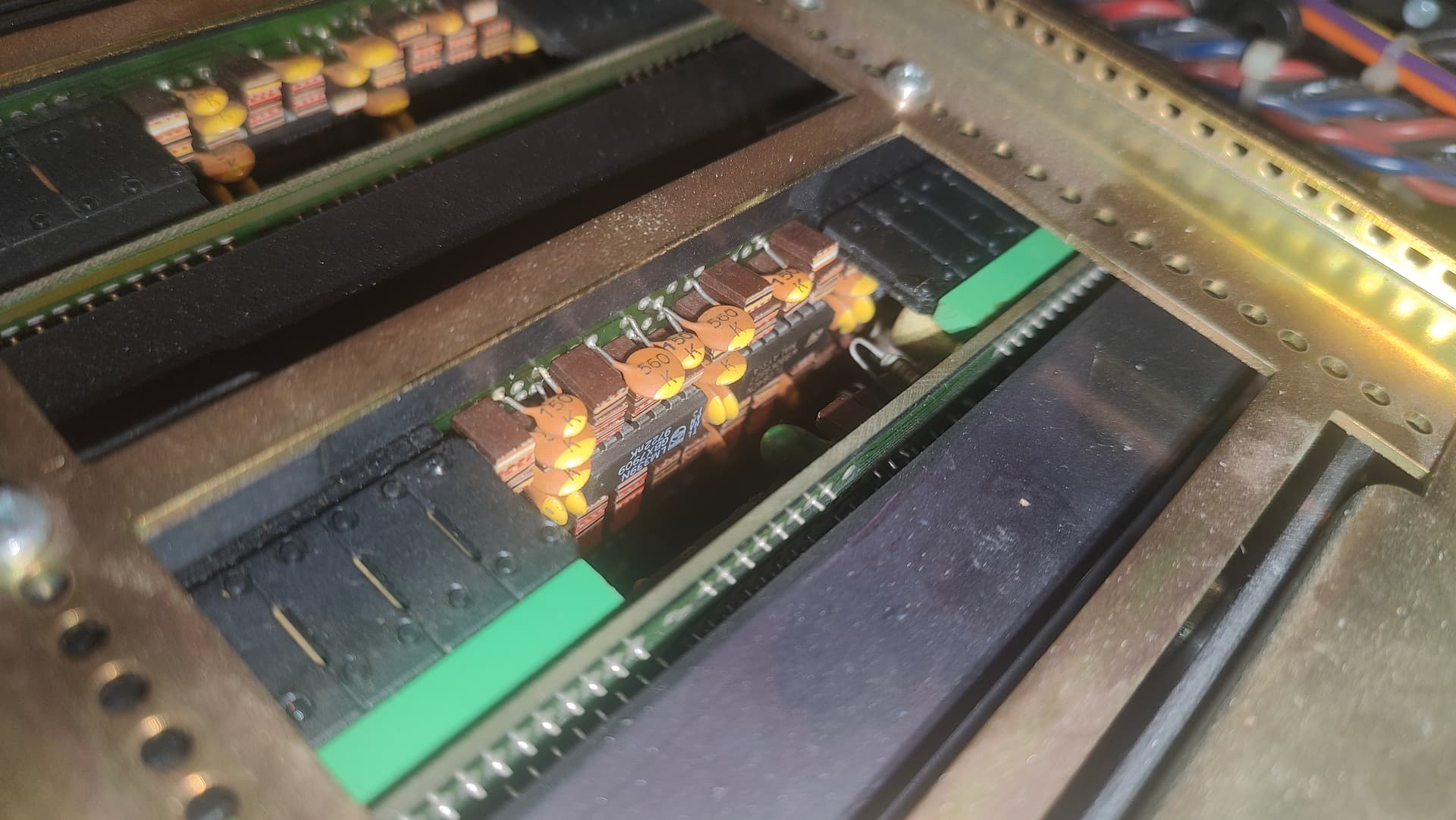

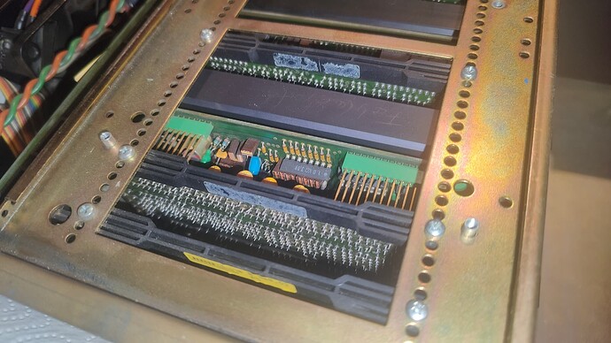

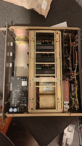

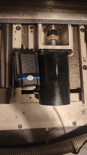

Stepper motor situation:
The Berger Lahr steppers that are on the machine now use a nema34 bolt pattern and they are huge. They were great quality at the time.

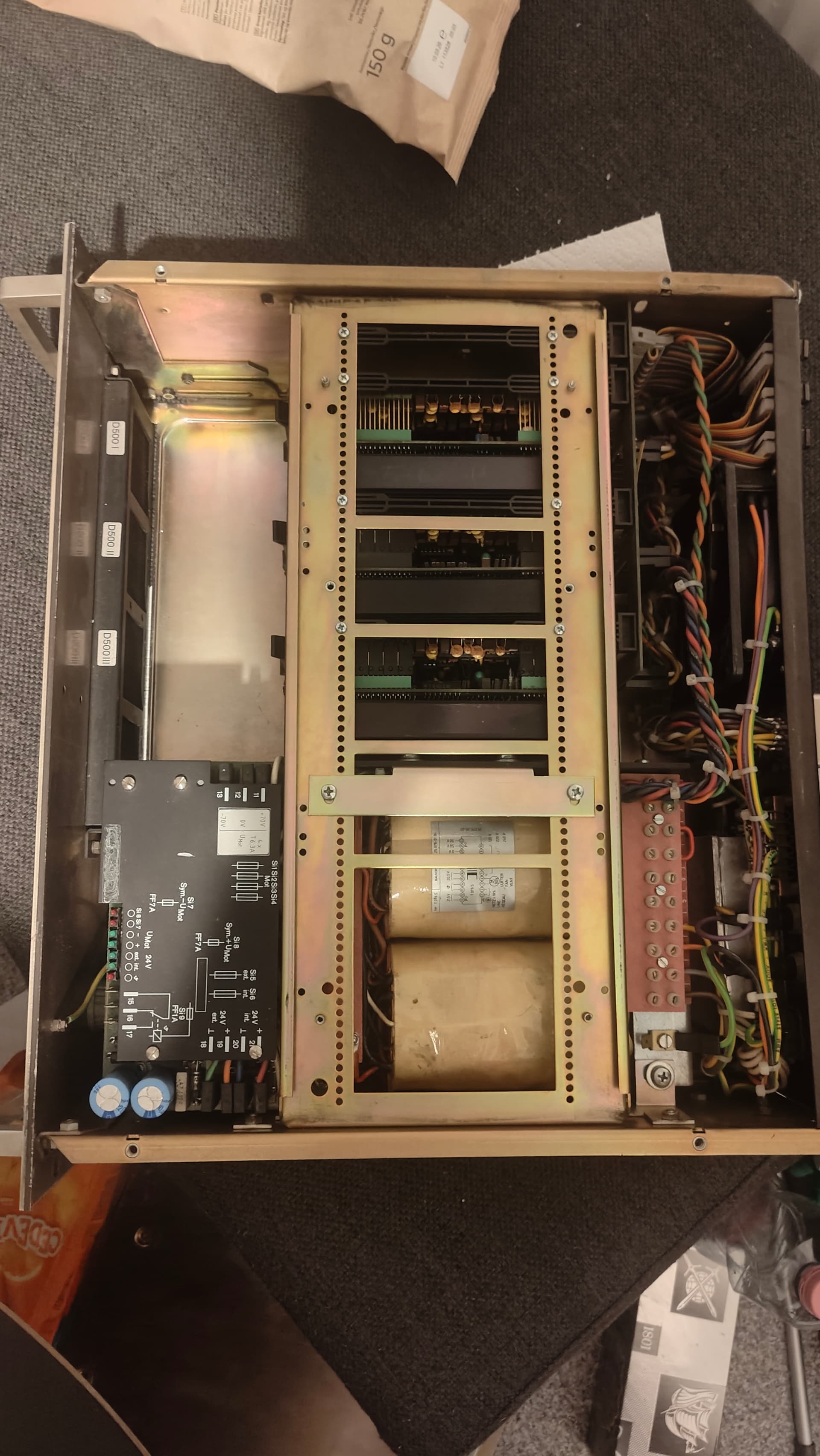

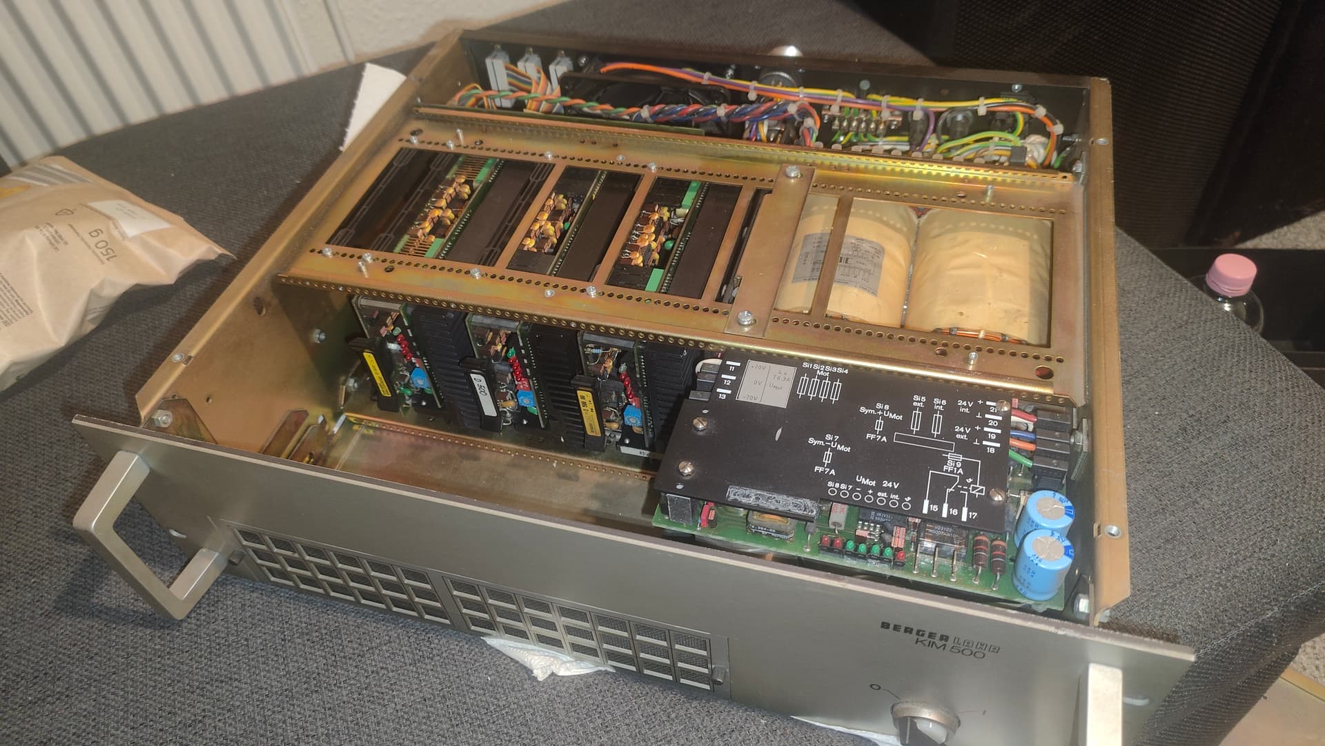

They also have a really damn heavy 3U rack driver board
Which is like 10kg in itself, quite crazy.
I had some nema23 closed loop steppers on hand from a previously cancelled cnc project, and they look tiny compared to these.
But. The nema23s actually are more powerful and more accurate, which I guess is achieved by being 3 decades newer. Not to mention closed loop.
The old steppers definitely need an upgrade, but it isn’t really a very urgent upgrade. The accuracy is fine for esk8 parts really (even if I wish they had more), and the power, I can just be mindful of. That said, a new nema34 servo set does look attractive medium/longer term. But with what that costs, it won’t happen very soon. Need to run these motors to see how they actually fair cutting material. If not well, I can make nema34 to nema23 adapters and mount my closed loop steppers. Otherwise, whenever I decide it’s time for a cnc router too, I could use the nema23s on there.
I was actually originally planning on having to use my nema23s for the medium term, then saw the size of these and become optimistic, then saw the specs of these and become much less optimistic, but I still want to give them a chance.
Crazy how dense that is, and yet how big it still needs to be.
Engineers 30~40+ years ago were next level.

As I suspected, the X axis backlash was just the ballnut not having enough preload. Easy to adjust; remove the screws that hold the ballnut to the block on the axis; rotate the ballnut out to an accessible area; tighten the adjustment screw. After multiple steps I went from 100 um to 50 um to 30 um to 0 um where there’s static friction if I give it a thwack (too tight), to 0 um where the dial indicator reads oscillation then always settles to 0 after the thwack. According to chatgpt that means I nailed the adjustment.
Next up gotta do the same thing in the Y axis. The ballnut is much less accessible there so it won’t be fun.
In other sort of related news, I just got my business tax number today, so progressing on the bureocracy front as well, since this machine is meant to cut parts for sale for esk8s soon enough.
After thinking I nailed the backlash I decided to check other spots too along the axis, and there seems to be significant wear on the ballscrew in the middle. Side backlash is zero now (both sides) but middle is 50um… that’s not good. I got replacement ballscrews and ballnuts with the machine so I guess I might as well install those right away then.
I checked the fixed ballscrew thrust bearing near the motor and that has 3-5um play on the X, that’s as expected, good.
I also checked some roll rigidity to try to find out the conditions of the linear guides and the rigidity of the whole machine and I’m blown away. Y axis using all my weight to apply moment didn’t even bulge the dial, X + Z stack has roughly 20 N/um in the middle of travel which is actually impressive for a machine this class, that’s roughly comparable to an entry level VMC.
So far it’s looking like as soon as I swap the ballscrews I’ll be structurally good. :crossed_fingers:
