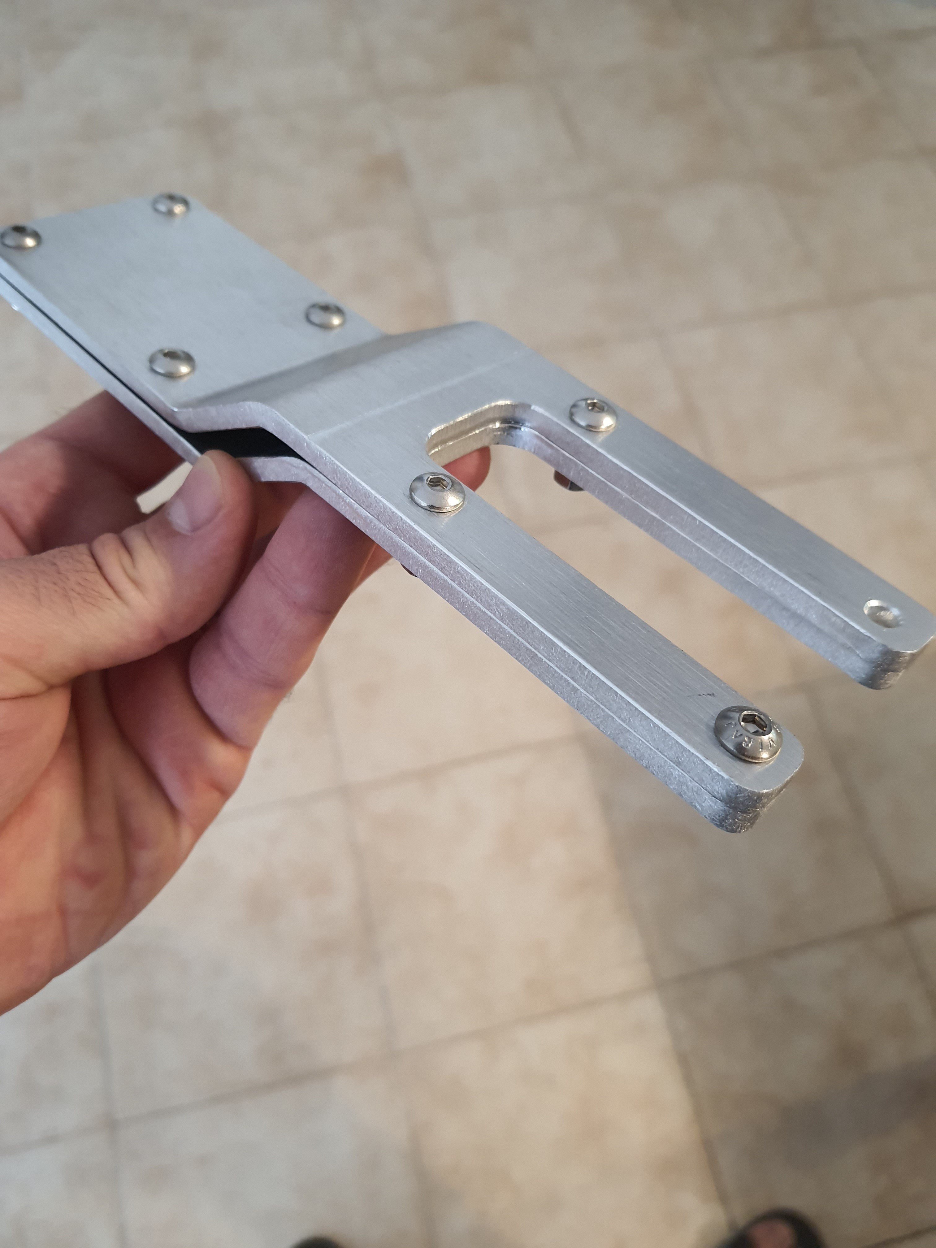

I just bought some aluminium foot lockers , nice aluminium plates, bent and drilled
was 70 euros for a set of two
I suppose, staying in the 100$ range would help selling those

Also checking an option for stainless steel
What is the preference for hole spacing? Old/new?

The sad thing is I have nothing to test it with, literally no longboard parts atm
Iโll rig something to show you (and me) the strength of these.

So for now it bends
Keep in mind this is overkill in terms of loads, but I wouldnโt want my product to do this anyway.
I will try stainless steel next before changing the design completely.
Iโll keep you posted
@DavidF @glyphiks
Does it? I canโt see it bending on the pics
Stainless steel would be ok, but quite heavy
I see now
Also, I think the front plate (where the base plate is attached) could be a bit shorter
This would decrease leverage
How much weight did you put on it?
Iโm 90kg, so all of itโฆ
The design loads were 60kg as in 120/2
Iโm 68kg, so I think those would be ok for me
But I get that stronger is better
Yeah but if you accidentally hit a pothole or whatever I bet the force would be bigger then a bouncy 90 kg load
