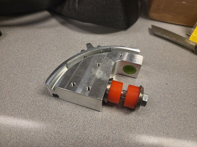

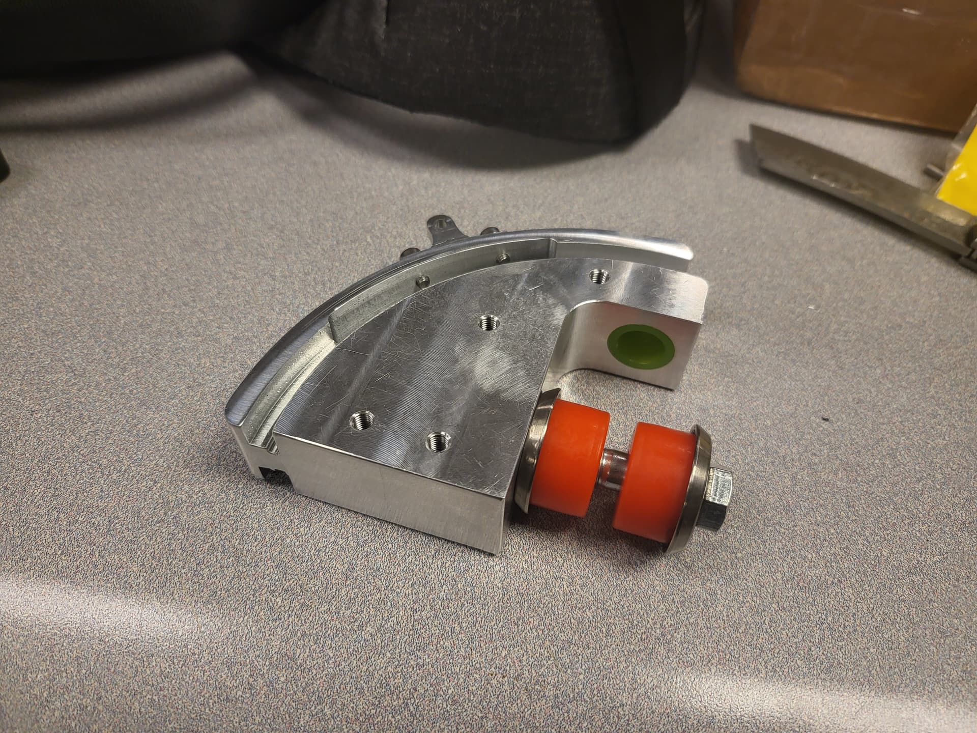

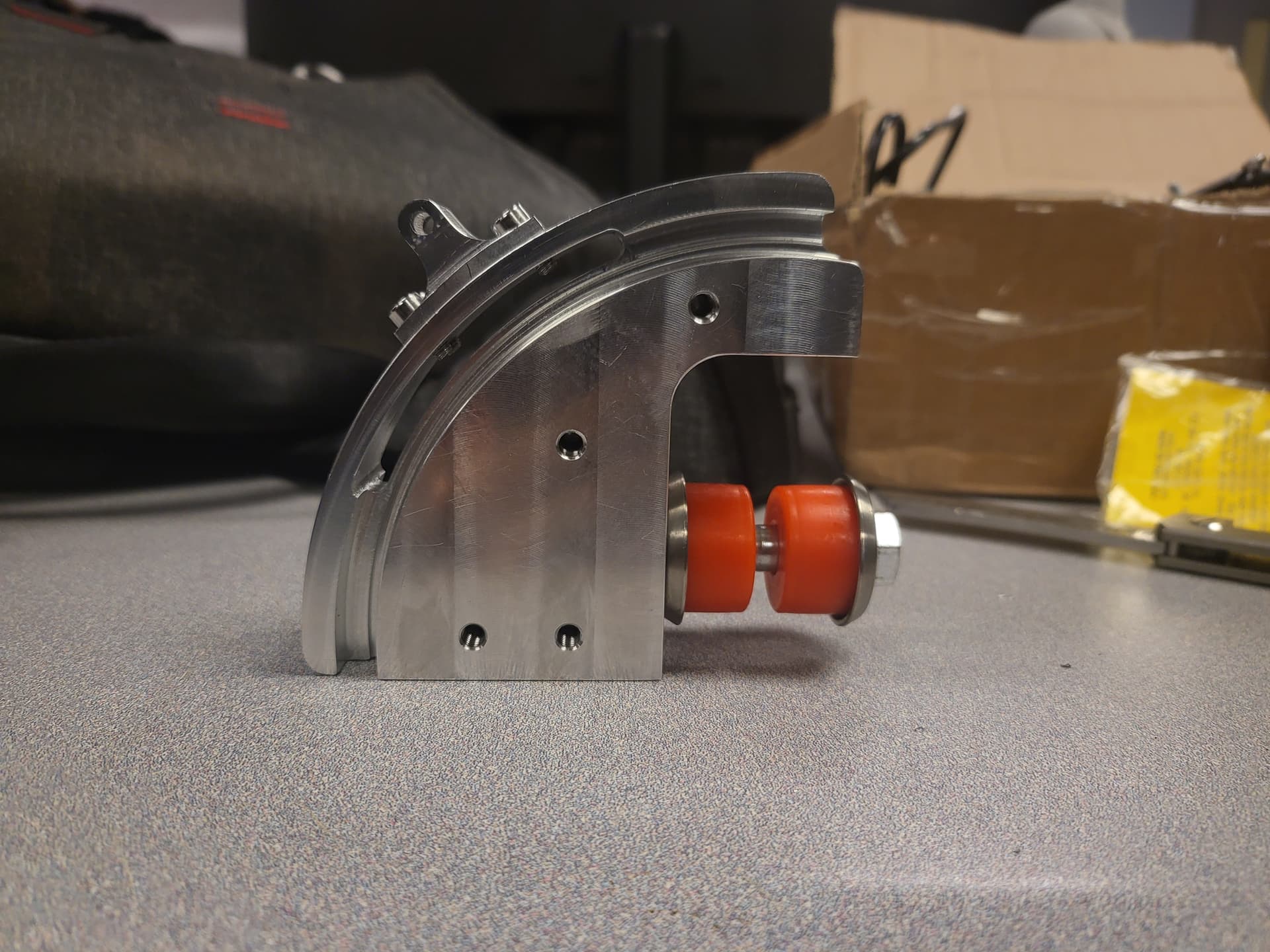

Just an update here, machining is coming along nicely for my actively variable baseplate prototype.
I too have had that idea since 2018, but one of the problems is that the motors will move up and down as the rear changes angles. For most setups I think the clearance wouldn’t be enough. In my mind its only practical with small gear drives and inrunners hugging the hangar.
Whats your plan to get past this issue?
Front adjustment only haha.
That and this being designed around IDEA drop brackets does increase the space i have to work with a fair bit.
I see. The rear truck has a much bigger effect on stability but maybe with a low enough front angle you can increase the operating window of the trucks quite a bit.
I’m mostly curious to know if you find it intuitive, or if it throws out your balance having the trucks steer differently at different speeds.
Glad to see someone trying this. Good work!
probably many setups could accomodate 30° of motors movement, if they get to stick out the back?
rear seems more important.
Rear would be more important, but im just gonna have the rear truck biased for a very low angle and have the front sweep through a range of 30 to 60 degrees. Its much simpler.
I think this could end up with a good feel. it’s odd getting all your steer from the front at low speed but you get used to it. ( had a proto setup at like 50/10 ) 60° should turn well.
