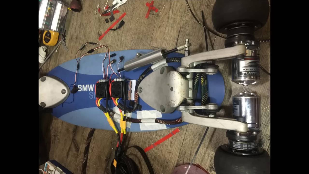

A 3 link with bushing linkages?
unclear if that is a rod end but it kinda looks like not, very well could be though.

This is like a spherical bearing formed from attaching two bearings together at 90 degrees. Then the small links from the SRB NKP.
