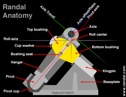

-Center of gravity
On this one, what you want to think about isn’t center of gravity, its the roll axis.
I’ll bring back this graphic, and a new one.
randalanatomy.b
Roll center is the point on the pivot axis directly below the axle.
And the roll axis is the line connecting the roll center between the front and rear truck.
The roll axis is the tightrope on which you are balancing.
What’s actually important about the roll axis is its distance in height from the foot platform.
If you’re running a ton of risers, its like you’re trying to balance on a tight rope while wearing platform shoes. And if you’re running a double drop setup that puts your foot platform below the pivot axis, thats going to make it a lot easier to balance.
However balance isn’t the only thing at play here. The distance between the foot platform and roll axis is also a lever arm which helps give the rider a leverage advantage, and control authority over the setup. Because of these leverage advantages it also has the effect of making bushings feel and act softer the taller you go.
