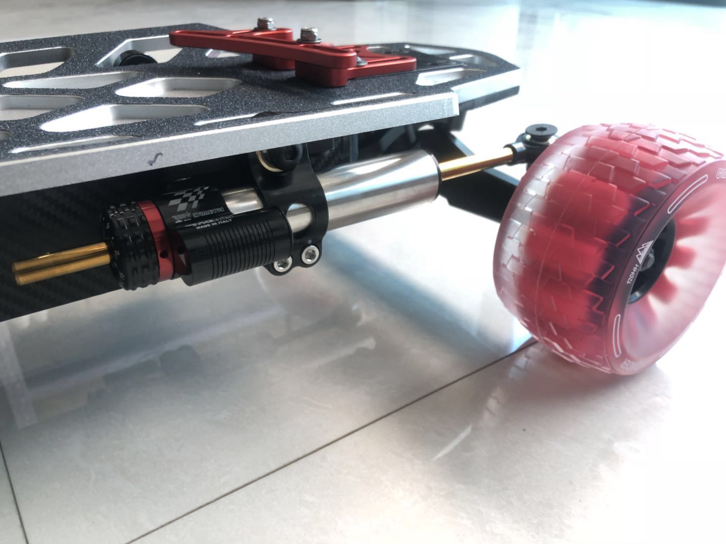

Seems that gear drive would be in the way, @NoWind could you tell me if I can fit this on the rear axle with a trampa gear drive ?
FX Steering Damper dont fit between Geardrive, not on standard truckwidth
What about adapting rotary type of damper with printed /cnc parts? Should also work with classic truck and not only channel truck?

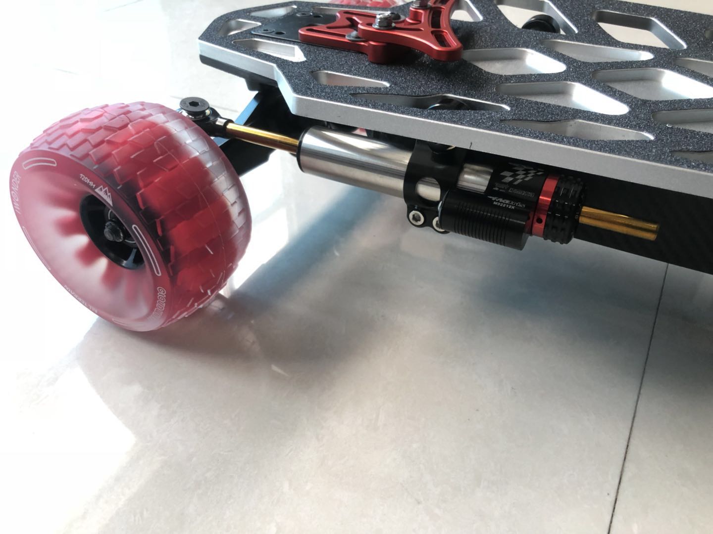

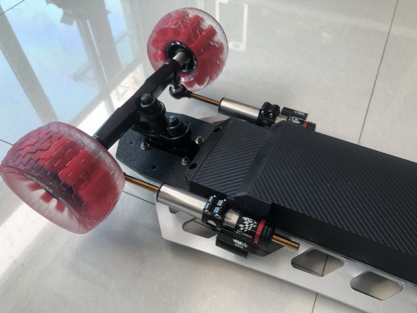

I need to see those mounted
stole these off taobao
These work ^^
I think we would like to see it do such
@BluPenguin use to run them
Seems like you wouldn’t be able to carve with the dampers situated like that
:man_shrugging:t2: there are always some weird build
Had a buddy who ran with one. Prevents sudden jerky movement but you will still be able to carve
At what angle though

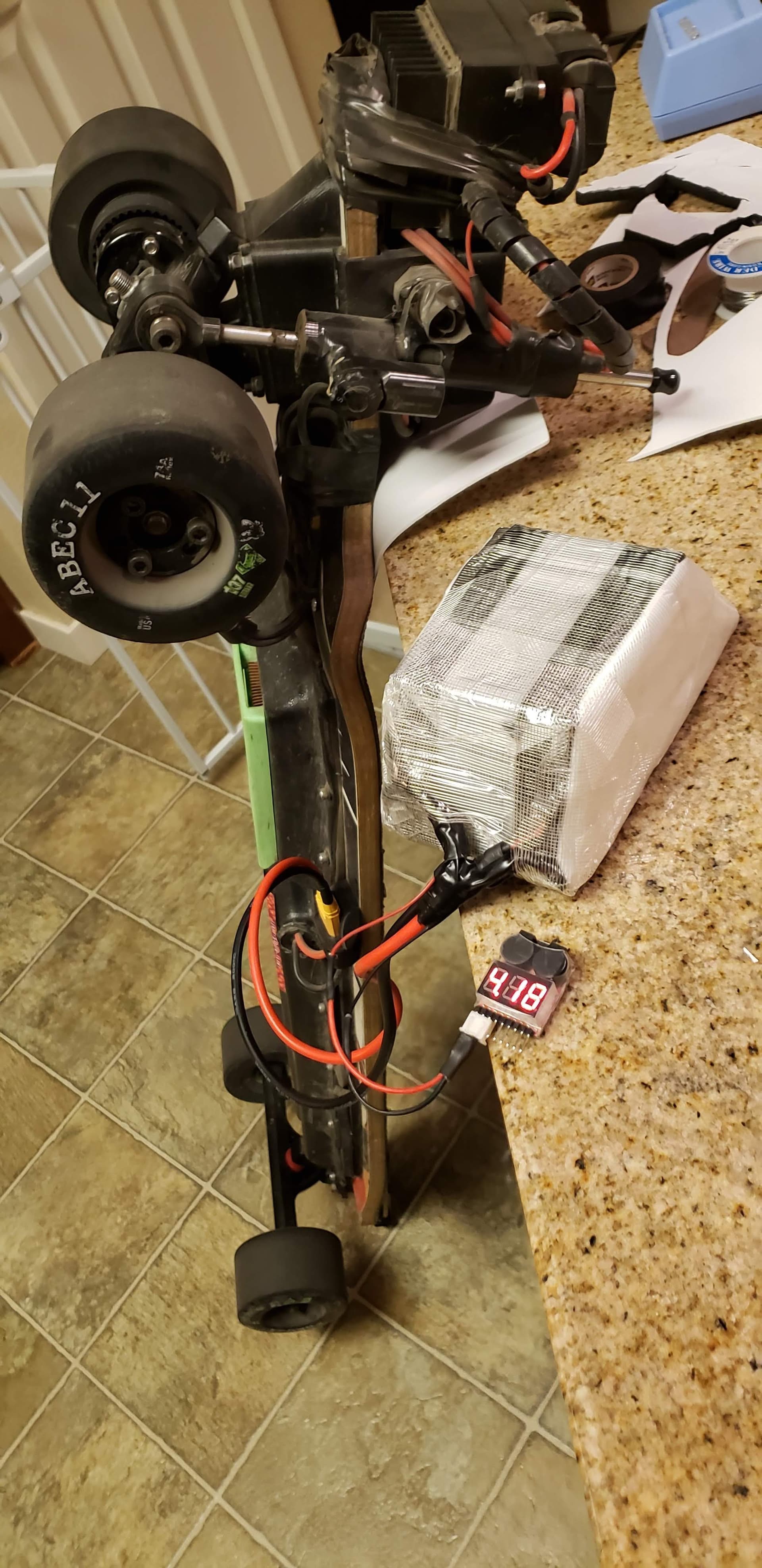

Here’s how mine was mounted.
That a wild setup
