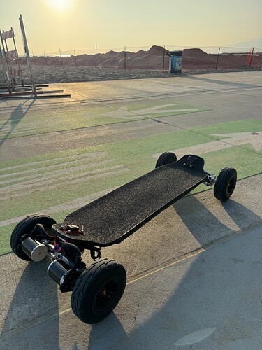

I’m running 180A total battery @20S, really depends on what you are used to. I am actually wanting more. Not sure if this pack would be comfortable with more than 50 per side though. Maybe 70 per side if you really don’t care about the cells

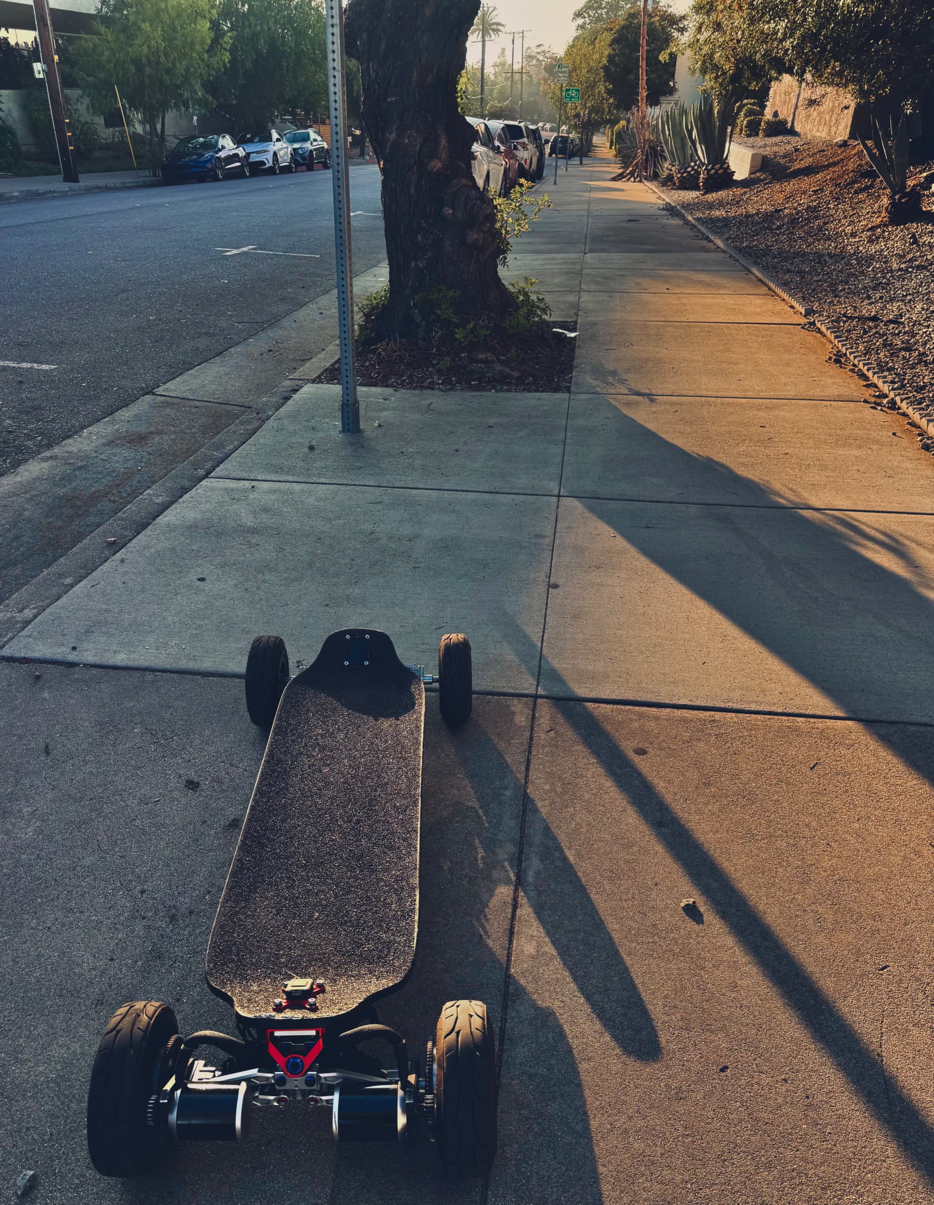

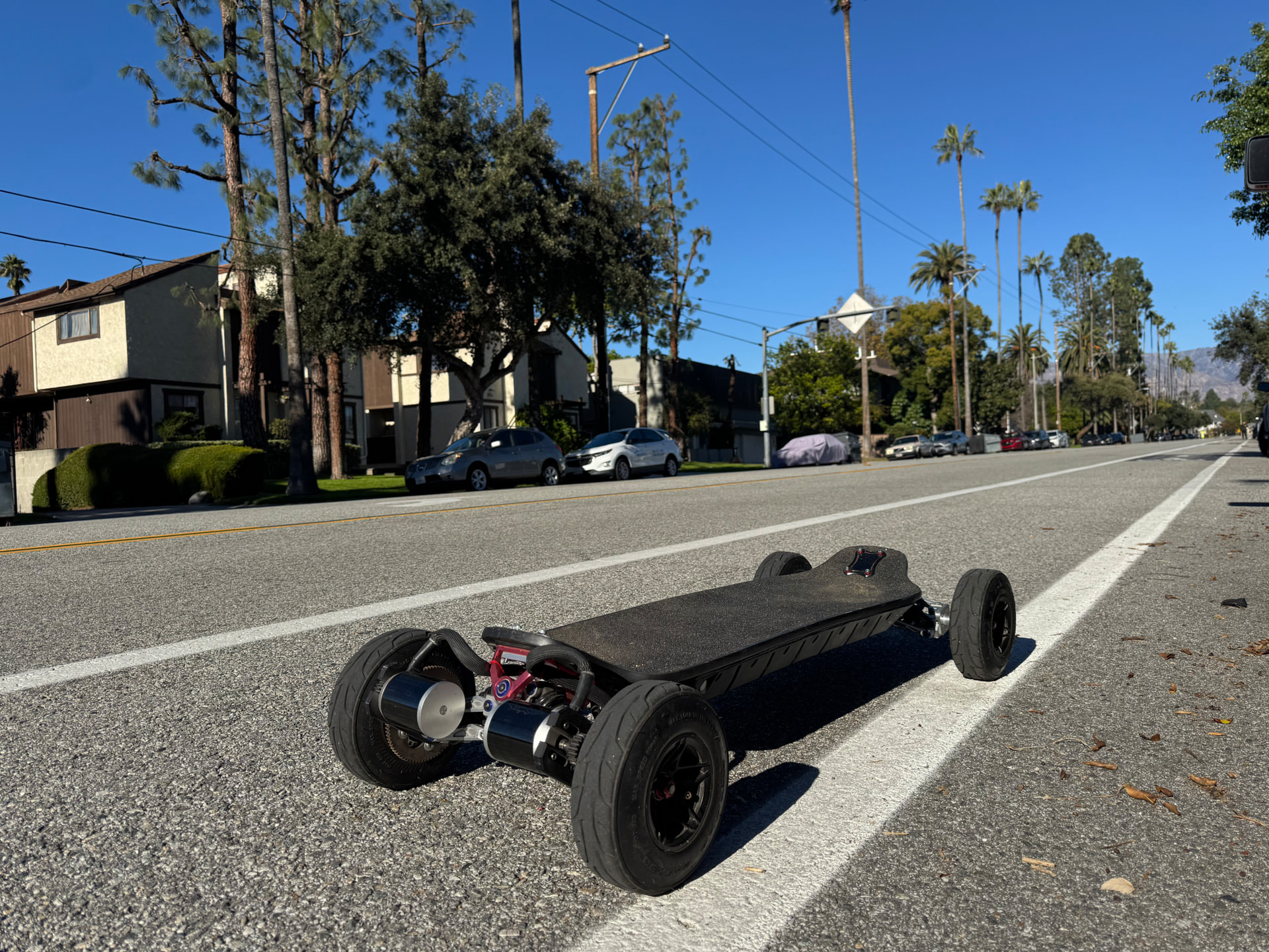

Board was successful in street riding down Abbott Kinney which is a very busy street among much more.
Didn’t fall apart on me.

It’s seemingly is running fine aside from it cutting out on me last night

Hmmm this ol girl might be moving up from 12s
12s is pretty nice as it’s running but
Some filthy part of me wants this thing to be 20s
I love 20s on my v5 and would be great to use my spare little foccers on this board with a 20s6p or something along those lines.

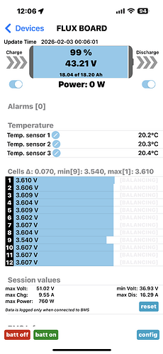

I might be ripping the battery out of this board due to
what it looks like damage of group 9
I may harvest the rest of the pack to make a powerbank
maybe …
Will then go for a top mount 12S6P p45b
because those are the cells I have on hand
At this point I wouldn’t be worried about the pack yet, just balance it out well and supervise it a bit closer
verify the pgroup directly before trashing. sometimes it’s just the balance lead.
also check the pgroup for bad spot welds, sometimes it’s one cell disconnected.
