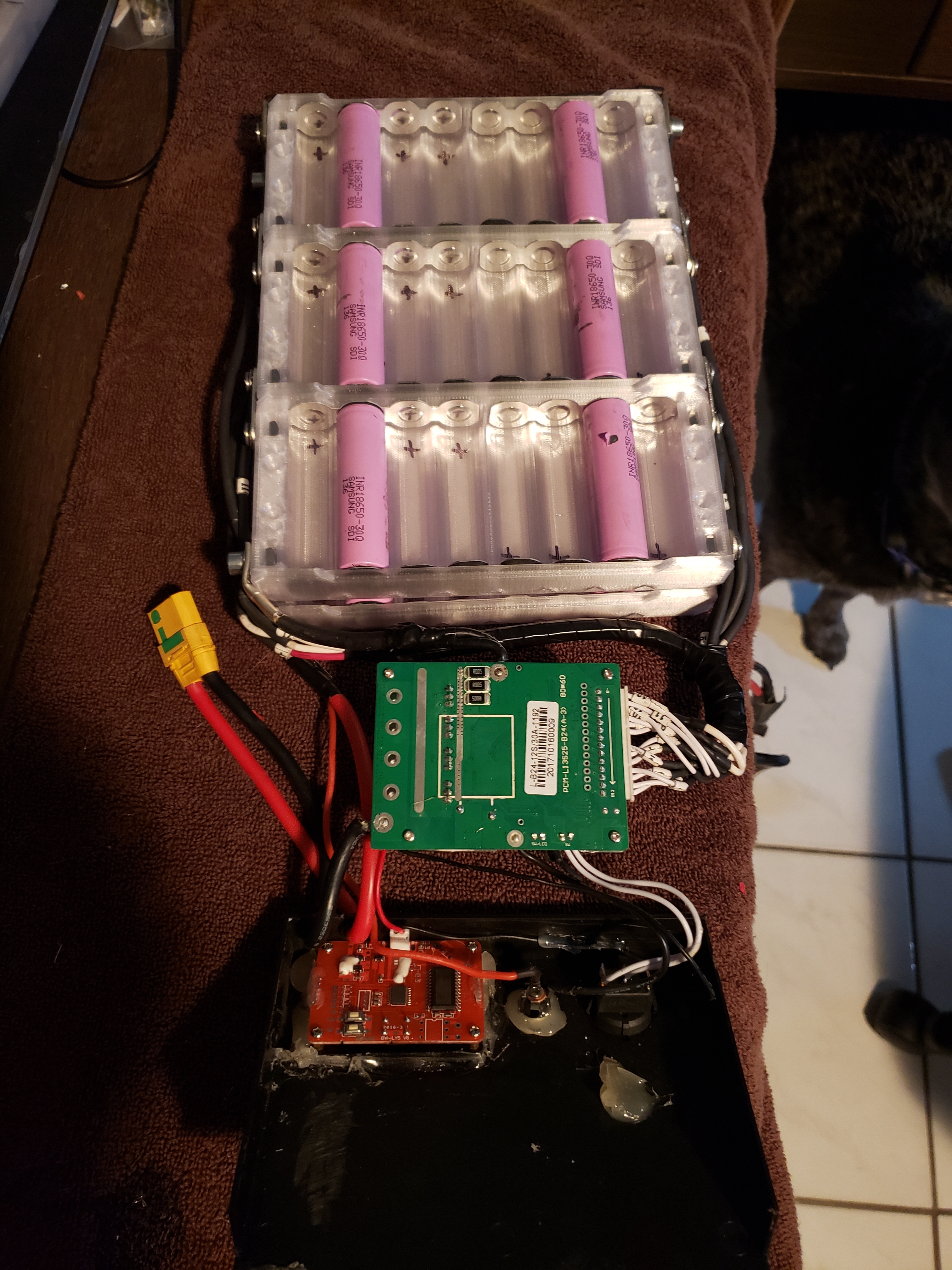

Ive completed my NESE 12s4p build!
I decided to do a doublestack version.
Ive got it all wired up in the enclosure with jst connectors for the charge/LCD display/ and power switch. All modules are labeled, as well as balance wires and their locations.
Just got through security with 5 2s3p NESE modules full of cells. No questions asked :slightly_smiling_face:
