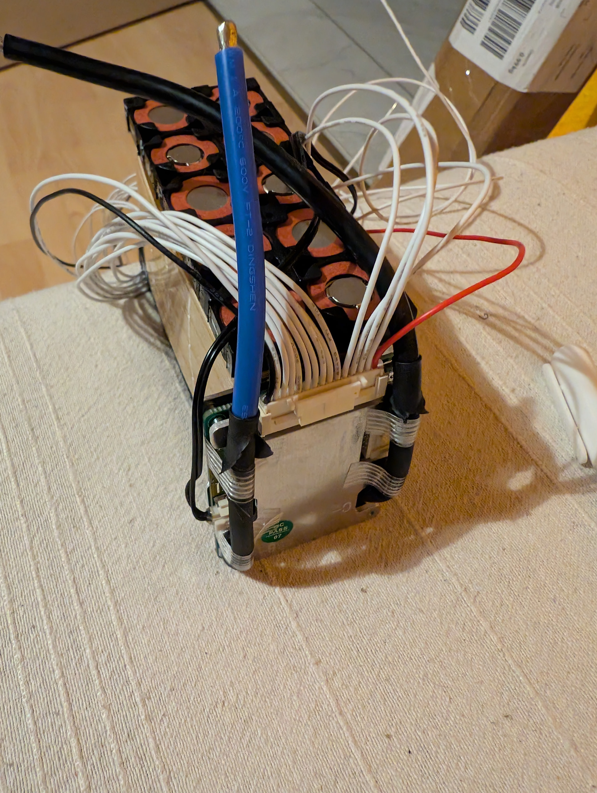

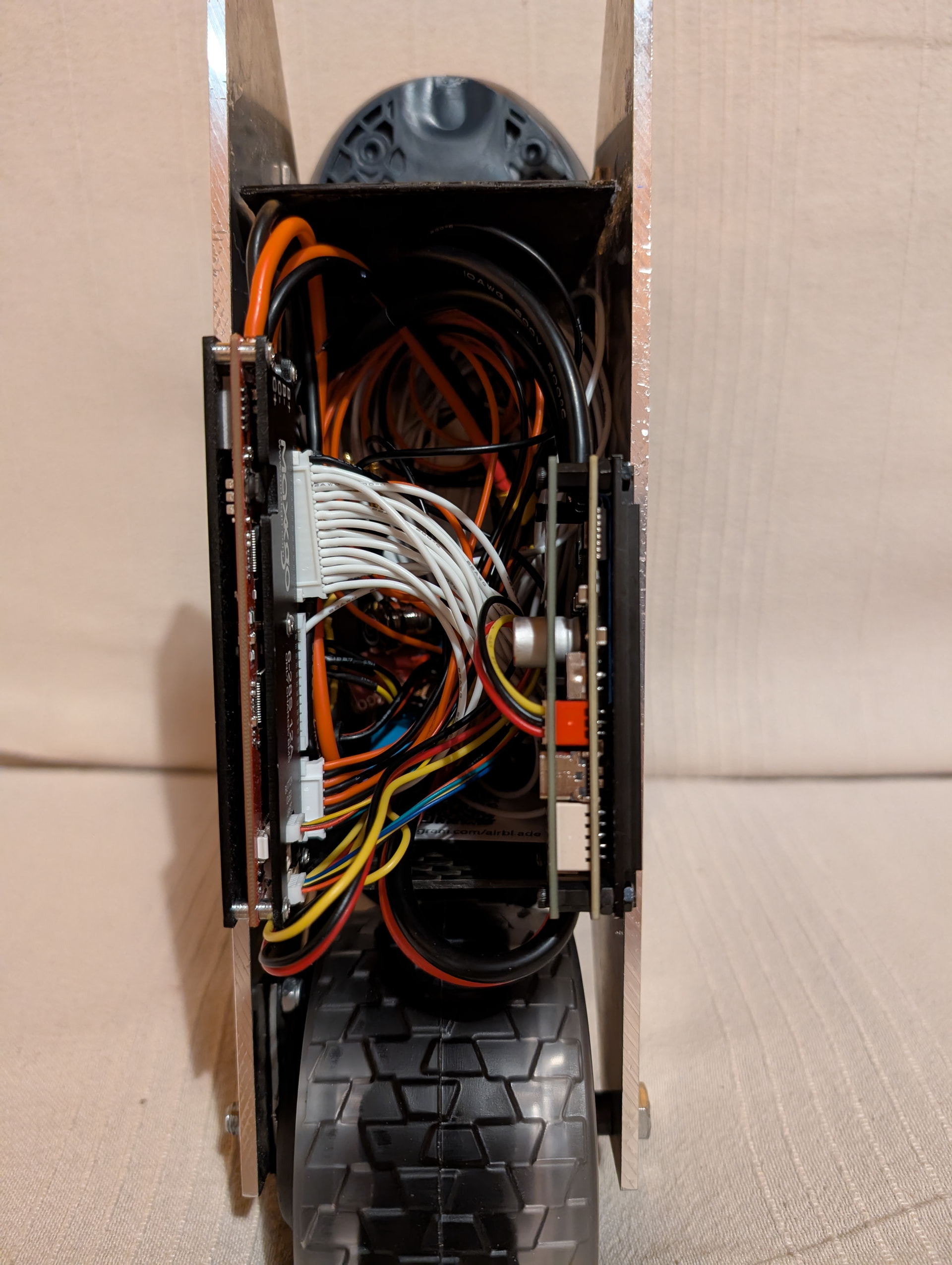

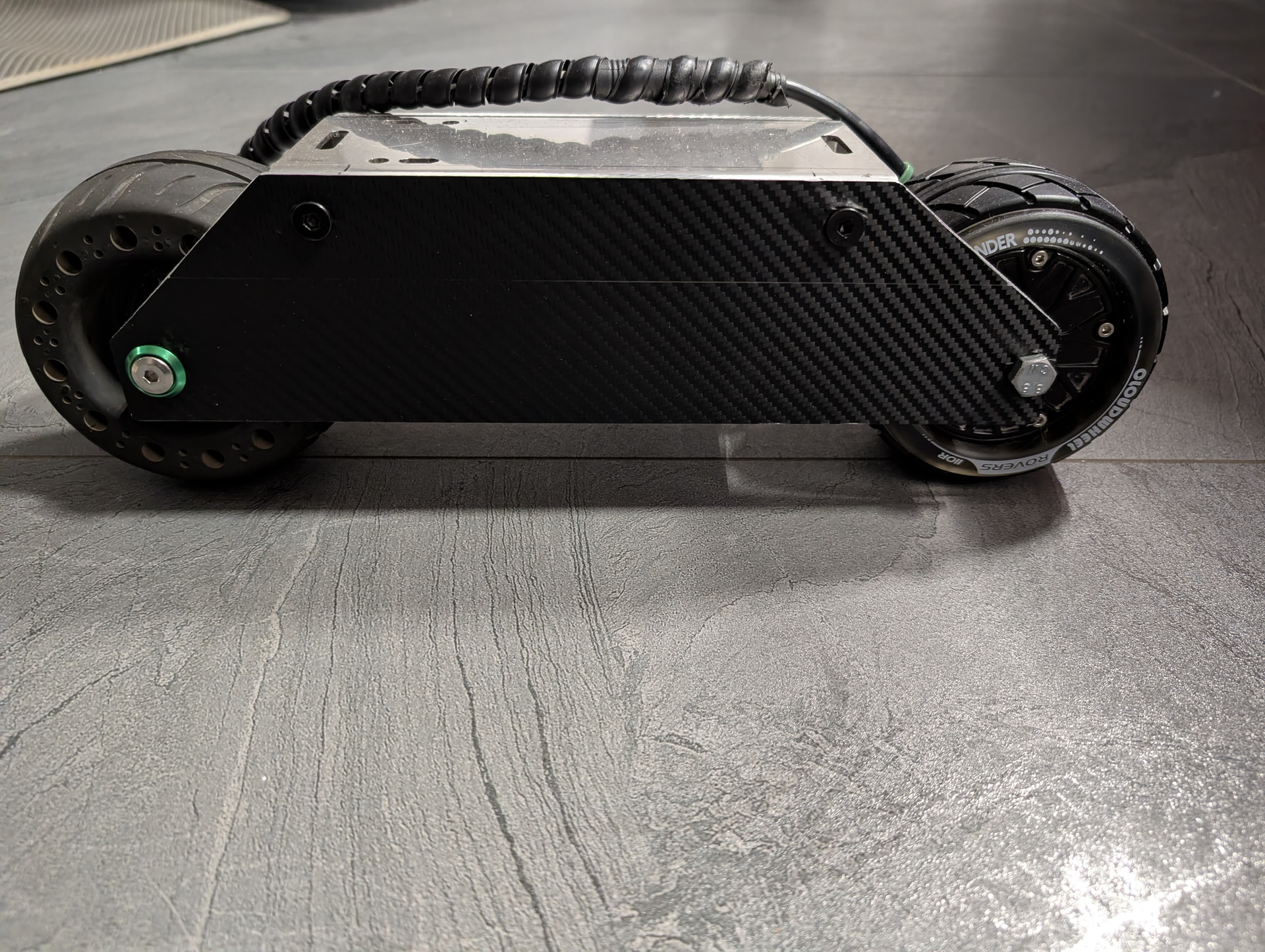

Hello, i been Building and Testing electric Inline Skates and now the Ride feels smooth and stable, ITS time to share some Details! I use one 21700 P50B 10S 1P pack per foot! 2x5.0Ah The range is about 35-40km at 25-30km/h

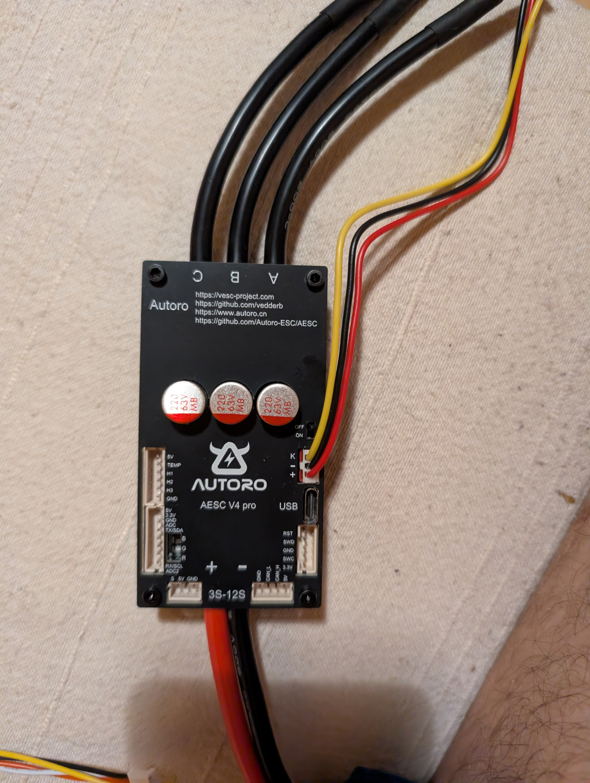

At Moment i have the hobbywing Controller in a Backpack, but Upgrade to Vesc without wires! And i found in this Forum the best Remote to Start with the Vesc Controller. The GB Remote
Airblade Platforms for your Boot
