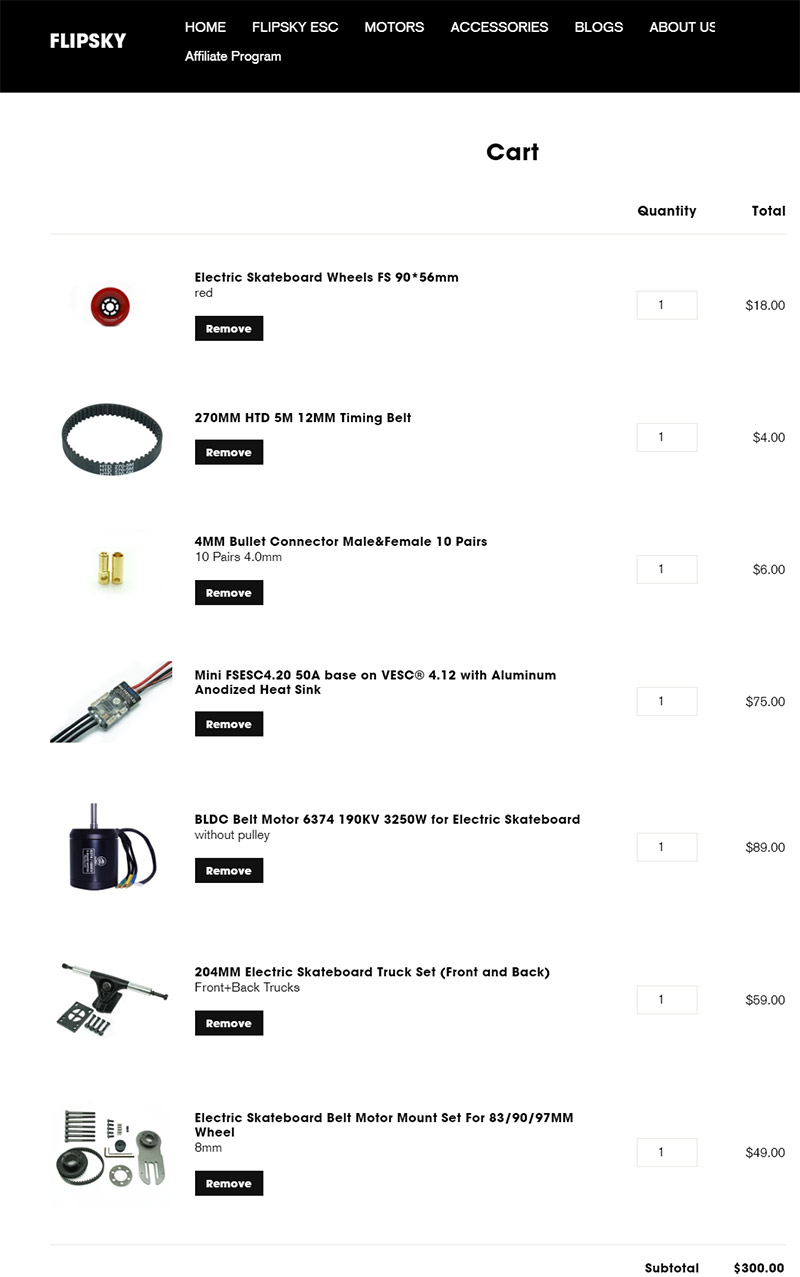

i’m building a new board for commuting: streets, around 10 km real range, train, subway… I already have the deck, a VX1 remote and i build a 10s2p battery pack using Sony / Murata US18650VTC5A I don’t need speed, but enough torque to move my 90kg/200lb around the city and a “as light.as possible board” I did this list for the missing parts, what do you think ?

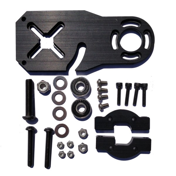

buy @dickyho motor mount. It’s a lot cheaper than that motor mount you’re getting. I own that exact same mount and it sucks. Btw do you have an bms for your battery yet?
If you’re getting dickyho’s mount. Might wanna check the belt width and the truck. You’re also missing an enclosure.

The dickyho Mount is cheap and appears good quality. However, it does have its down sides. If set screws become lose, mount will drop your motor on the ground. Make sure you use lock tite if you go thus route. There are some mounts available which even if they become lose, it won’t necessarily drop the motor all the way on the ground, I would probably look into these instead of dickyho mount for this reason.
Gee is right.This will work, but you won’t be pleased with the trucks or the mount. For a single 6374 build, get Caliber trucks (clones fine but genuine much better) and either Dickyho or Boardnamics mount to stay in the same budget range. Also, those wheels are not great. A used set of Abec would be much better and still not be too expensive.

At 200 lbs and a single motor, how fast do you expect to go? Not saying it won’t work, but a smaller battery and a single motor like that may leave you unimpressed

Nice to have you here! Also, I would suggest getting at least a 3p, maybe even 4p. Having only 2 parallel will give you about 50 amp and only 5200mah. 50 amps isn’t too bad, but you’d have to choose either between torque or speed, you won’t get much of both

Take everyone else’s suggestion and get different trucks/motor mount, and pick up a cheap, charge only 10S BMS from dickyho while you’re at it. The charger will be another $40, but it’s worth it.
I think the jury is still out on whether the 4.20 singles have improved enough to be the better choice over a tried and true 4.12, but you won’t be pushing the full 50A your battery is capable of through either of those, so maybe just plan on blowing it up and going with something better down the line, or just get a 6.x from the start.

As everyone else said. Get just about any mount but that one. Dickyho, boardnamics, Bkb anything but the one you have listed.
You’ll save money on other mounts too

Thx for all the good advices, changes to my list:
Caliber II Forty-Four 10" Trucks :
https://www.sickboards.nl/en/reversed-kingpin/6101-caliber-ii-forty-four-10-trucks.html#/225-color-raw
Motor mount:
or
(but seems to be backorder)

I have a single boarnamics mount used I can give you if you pay for shipping. Non-idler version
