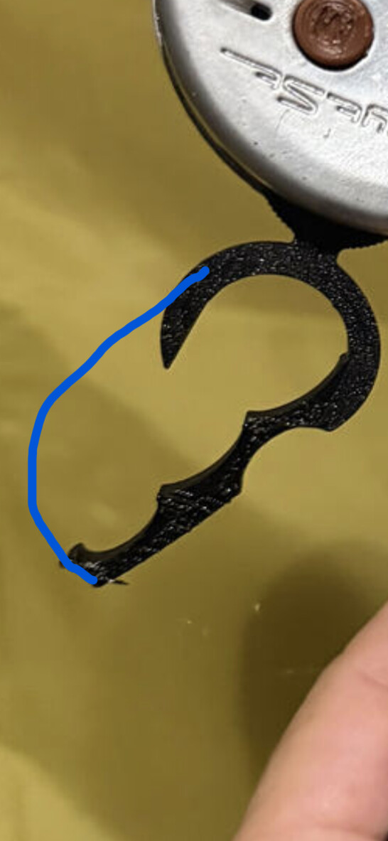

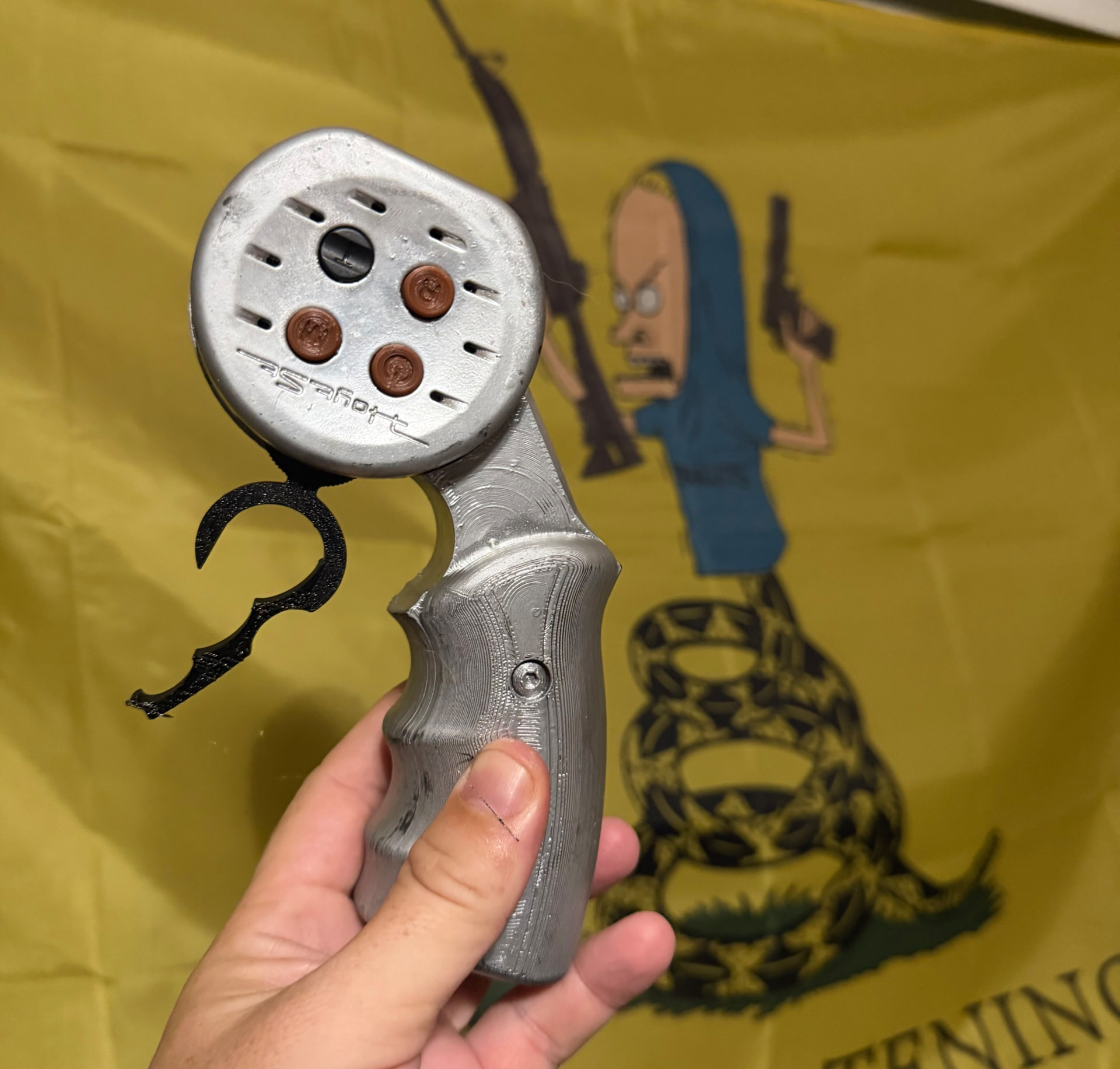

Extended Trigger prototype in the photo, also working on finding stiffer springs for the puck. .55 is good. But needs just a little more resistance

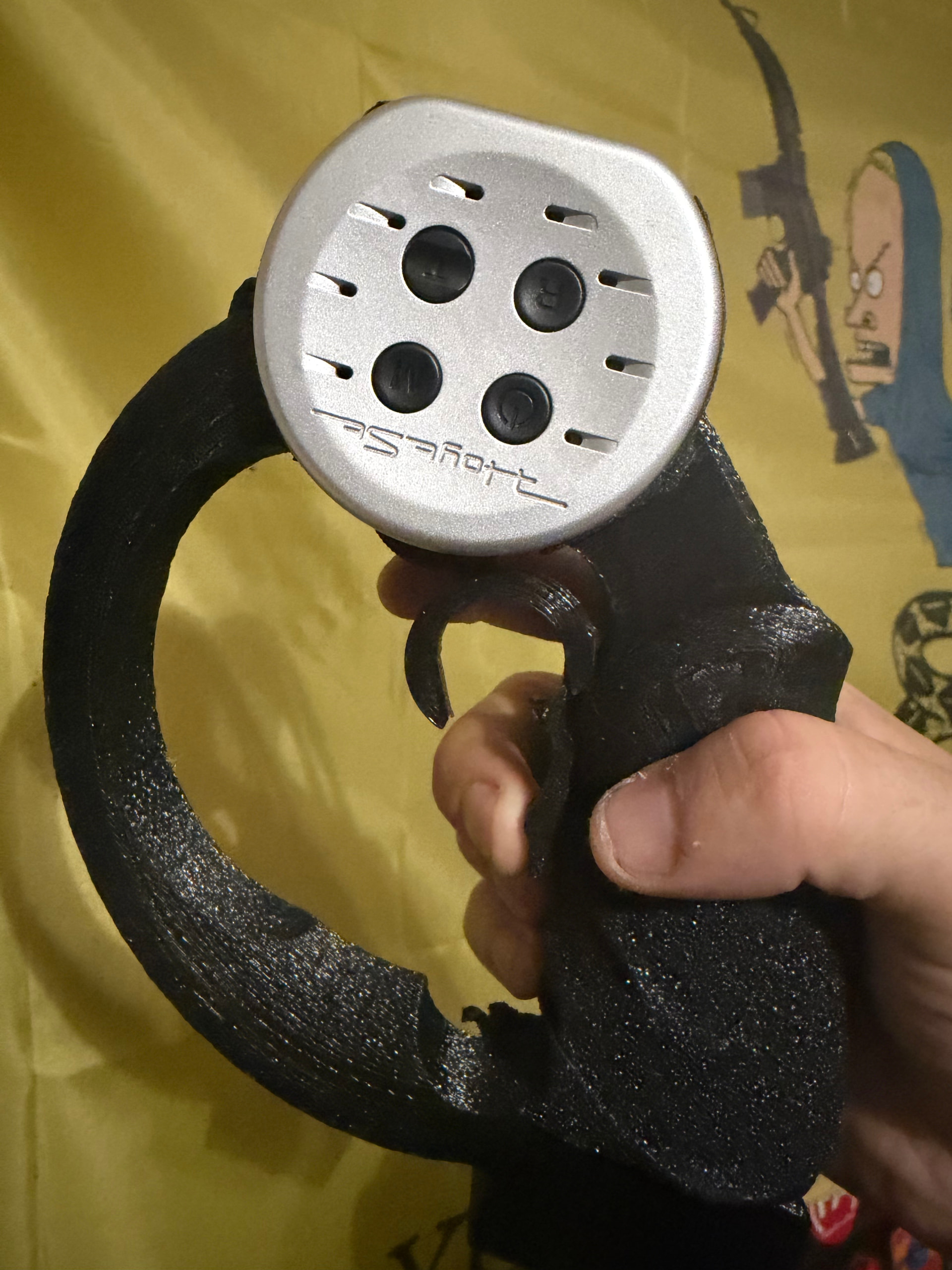

Interesting idea. I could see it being a fully enclosed loop so you have the same control braking
I see kinda like a lever action rifle. The one pictured does work for braking like this as well as normal push from the pointer finger. Because it’s so long it’s quick to reengage from the photoed position
I have the concept in my head for a progressive resistance pull. So at like 50% pull it it becomes stiffer so less chance of over pulling at high speeds where you really notice the difference in power it takes to go from 35 to 36mph and beyond. Gives that nice easy modulation in corners and then when a high speed straight comes up you can smoothly get to top speed. Less chance of tire spin/ chatter

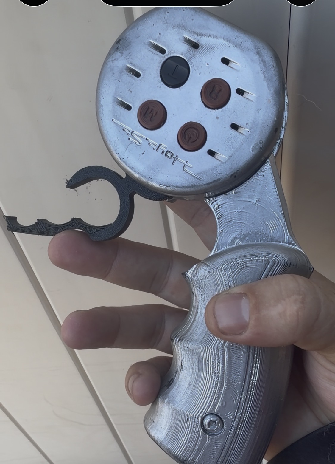

So far results are looking good using two fingers to pull and one to resist on the three finger trigger mod. It does require three finger tips to be cut off of any gloves you’re using instead of 1 or 2. I noticed it quickly taking away that feeling of having to babysit the throttle position and replacing it with the feeling of holding something. The throw feels longer which tames high powered set ups. Slight over pulls of throttle that happen naturally don’t come on like a startled animal.

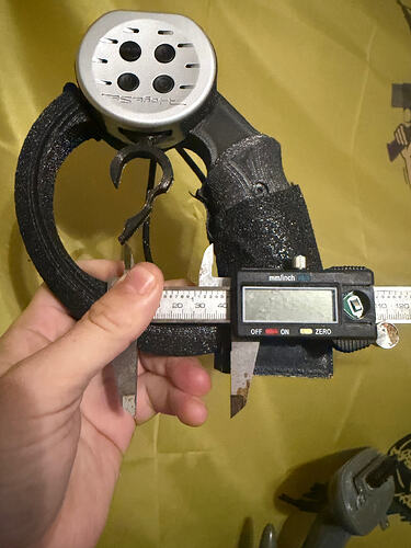

The throw on this is very comfortable. Almost feels like I built two-stage mechanical throttle curve built into the geometry. at Low speed when you need punch, you can pull from the pointer finger for 18mm of travel, when you’re flying and want to avoid pulling too fast so that when the power multiplies you can avoid spinning the tires you pull from the middle or ring finger for closer to 40mm of travel.
Also worthy of note it’s been pretty good at resuming power, like braking into a turn and accelerating out of the apex I feel like there isn’t that moment where you’re searching for the power.
