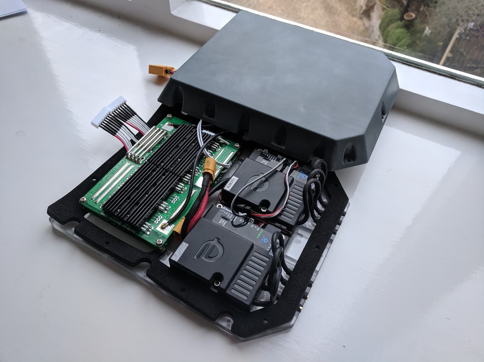

I do believe one or both of the enclosures available at propulsionboards.com should work for your given dimensions. I’ve been using the fishbone one. It doesn’t feel particularly impressive, but it’s held up just fine.

I almost went with one of these for my space invader build but didn’t like that they didn’t have black. Wonder if dyeing is an option or how friendly it would be to sand and paint.
https://www.polycase.com/wc-series
