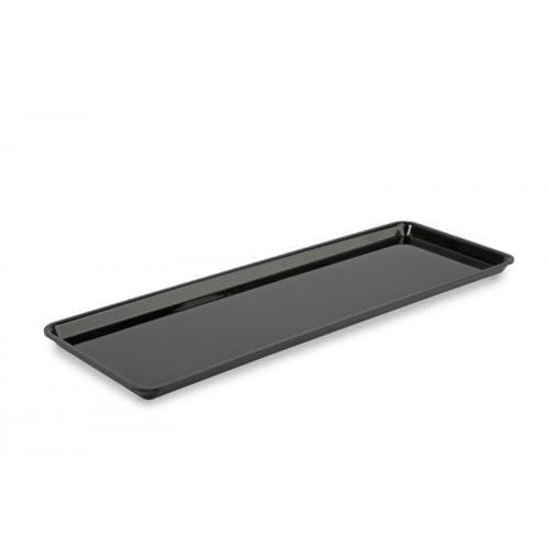

Question: is the acrylic (plexi) enough durable for the enclosure? I thinking over my DIY enclosure options and I’ve found this beauty:
500_500_productGfx_5531
It’s exactly the right size (length/width), I would just need to construct some 3 cm raiser on the edges to get 47 mm nice case.
What do you think?
Hmm well the main material property issue with acrylic is that it tends to crack easily
If you find a good way to join it all together without creating stress concentrations, and use the right thickness, it could be quite cool.
Use polycarbonate (name brand is Lexan), way more durable
True Lexan is great stuff - I still think it could have issues with bolt holes but thickness and design make a big difference
We used to use lexan on our robots back when I did FRC
I agree with @ShutterShock and @ZachTetra, acrylic is much too brittle. Polycarbonate is a much better choice but still might need a verrrry thick wall to not crack at bolt holes and other stress-concentrating locations.
Yeah something meme worthy like 0.3125 in+
It could be cool, but it would be heavy.
I could see something interesting like 3d printed walls, with an acrylic bottom plate, bolted all the way around
I don’t know what any of these stats mean, I just like to throw weird materials into the ring.

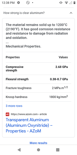

Al oxynitride (ALON is a brand name) is incredible but I bet it’s a couple hundred dollars per cubic inch. :slightly_smiling_face:
Wizardry or alchemy, I think.
It’s a transparent ceramic with about a 1/3 aluminum content….hard as hell, great for armor and crazy durable windows (for sensors, etc). Used instead of sapphire windows in some applications.
As far as realistic options, polycarbonate, a simple sheet of it, with loooong bolt holes that run all the way through the height of the enclosure, could work.
