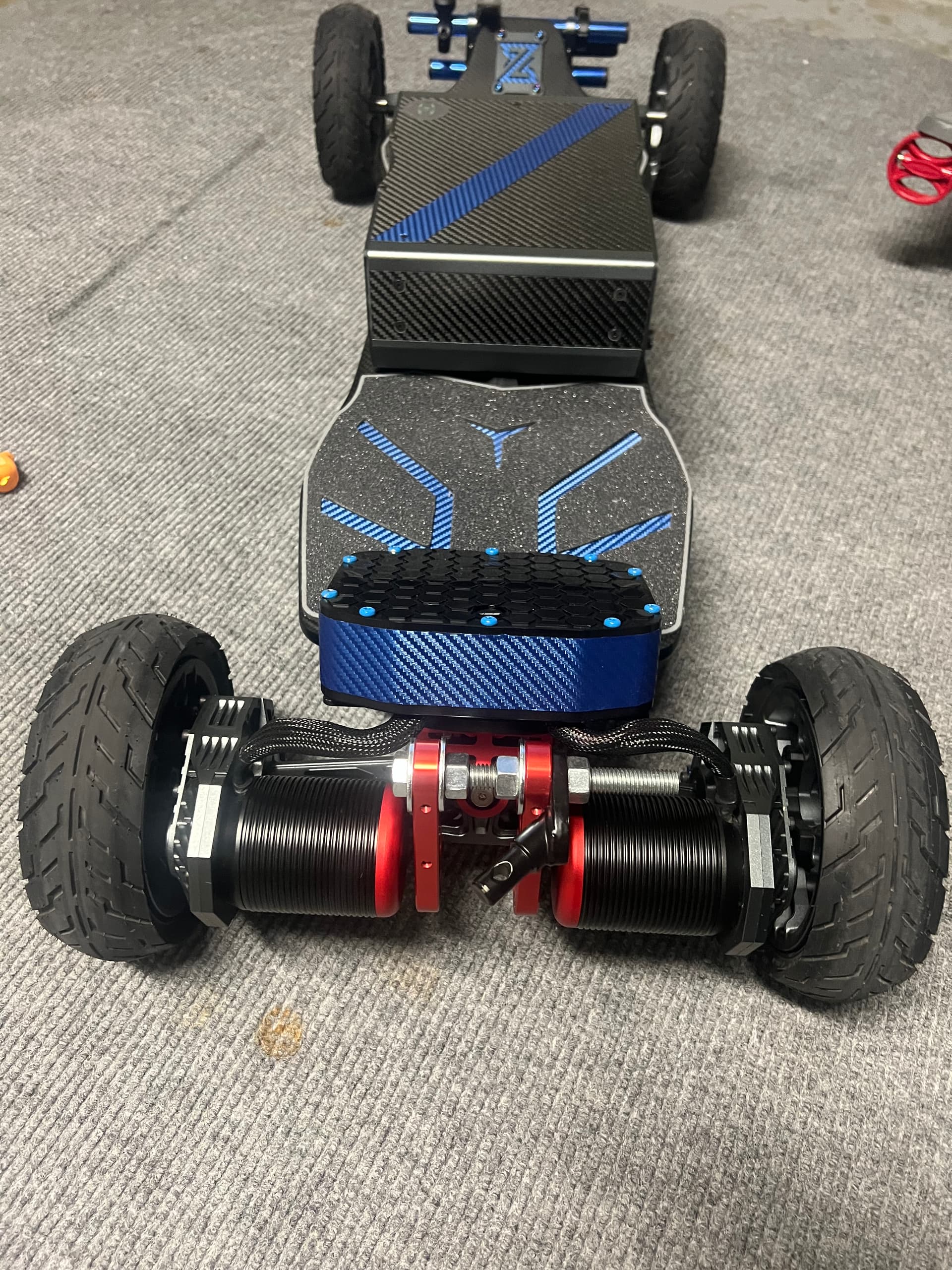

I made it !!! I currently use the solo esc and I will also include the BMs information here, but you also have the option of sending your battery to SKP and they will exchange the BMs for you with a smart BMs
Cut-off voltage: 44.8v
Maximum voltage: 58.8v
Maximum discharge: 120A
Maximum charging current: 8A.

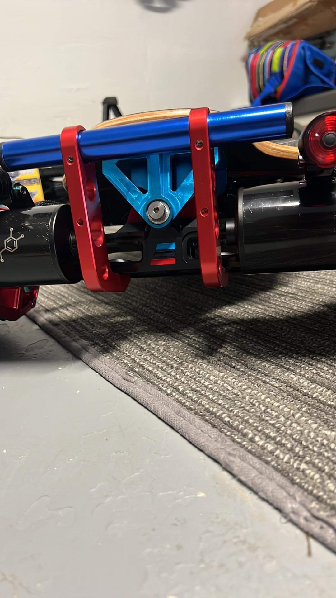

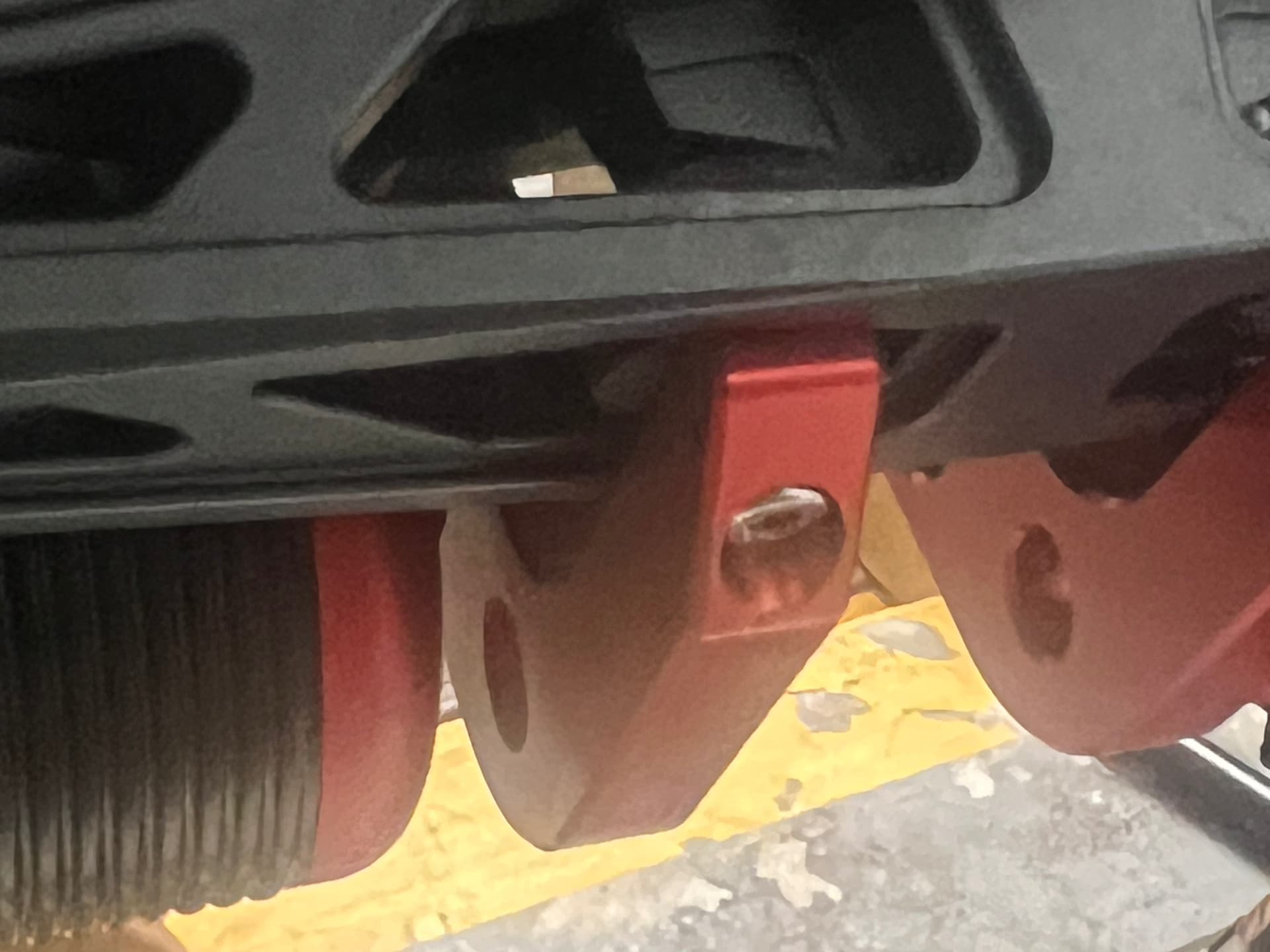

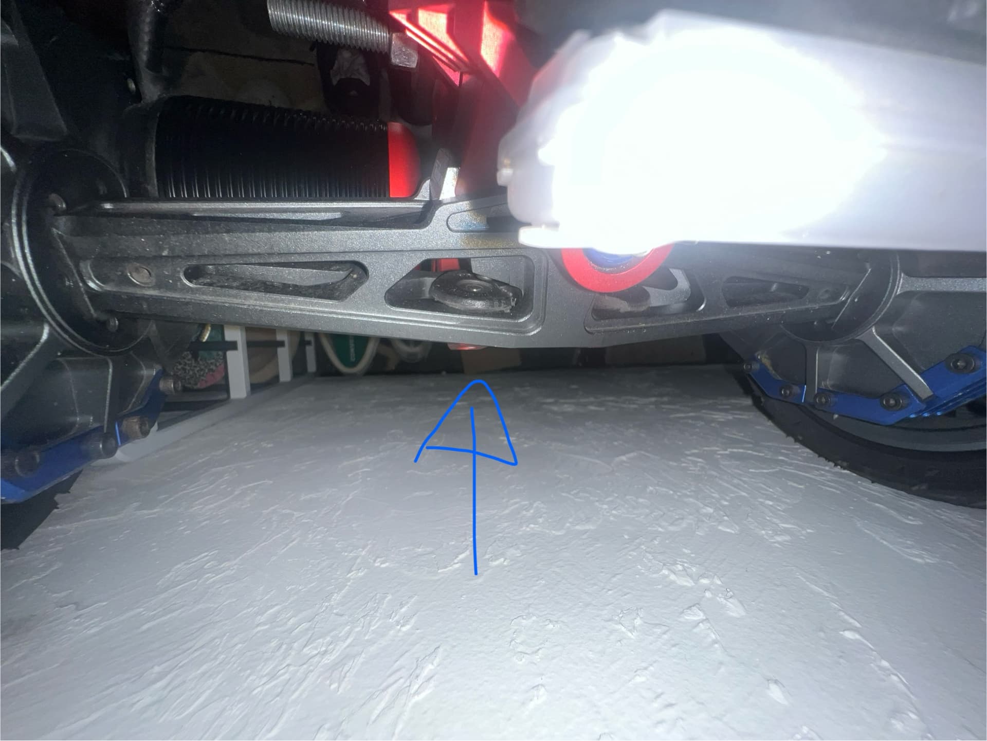

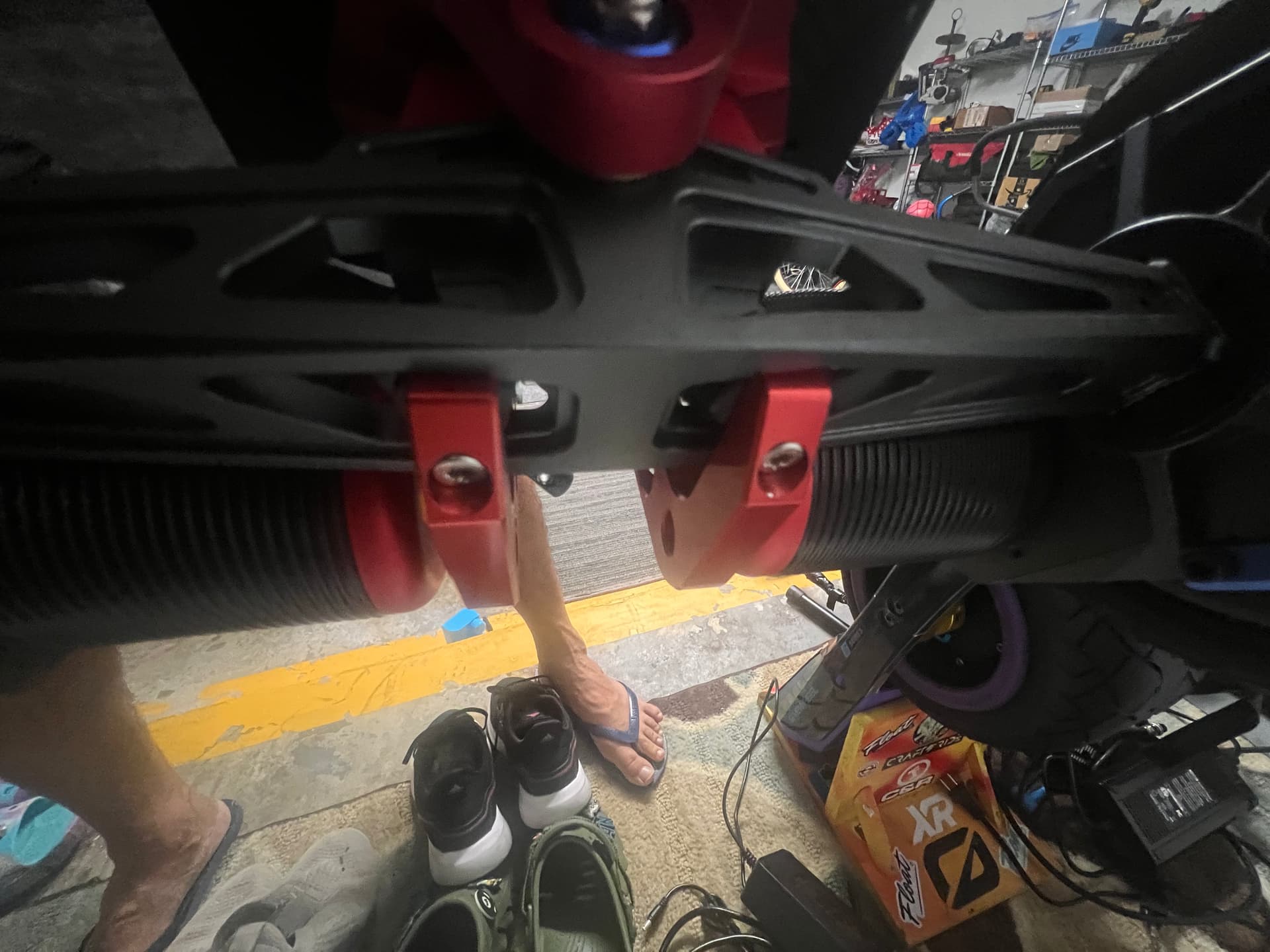

what in the world is going on here? Would love to see what parts you used to make tow attachment.
Thanks
This is made for a colored bar that looks very pretty too, but I added the screw to pull the best children
It looks great. Better than the upsideside own baseplate I used a couple years back
Thanks

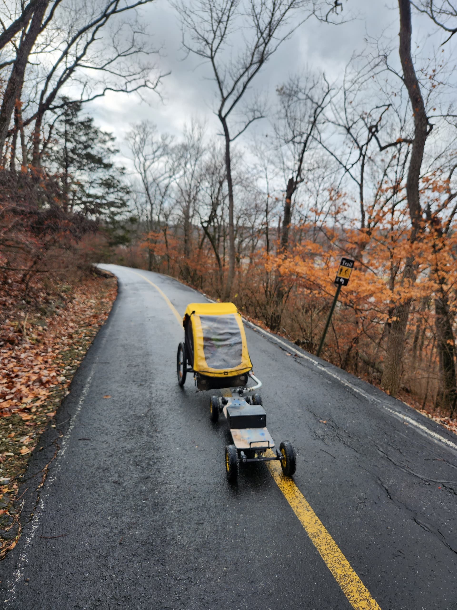

Dude. You should look into getting a Burley Bee.
They are really sweet.
Send link !!!
https://www.amazon.com/Burley-Design-Bike-Trailer-Yellow/dp/B010LLGWKE/ref=mp_s_a_1_1?adgrpid=54753352023&hvadid=580770741516&hvdev=m&hvlocphy=1020268&hvnetw=g&hvqmt=e&hvrand=2628805212408453000&hvtargid=kwd-298223270133&hydadcr=16247_13523177&keywords=burley+bee&qid=1705357385&sr=8-1
The best !!!
