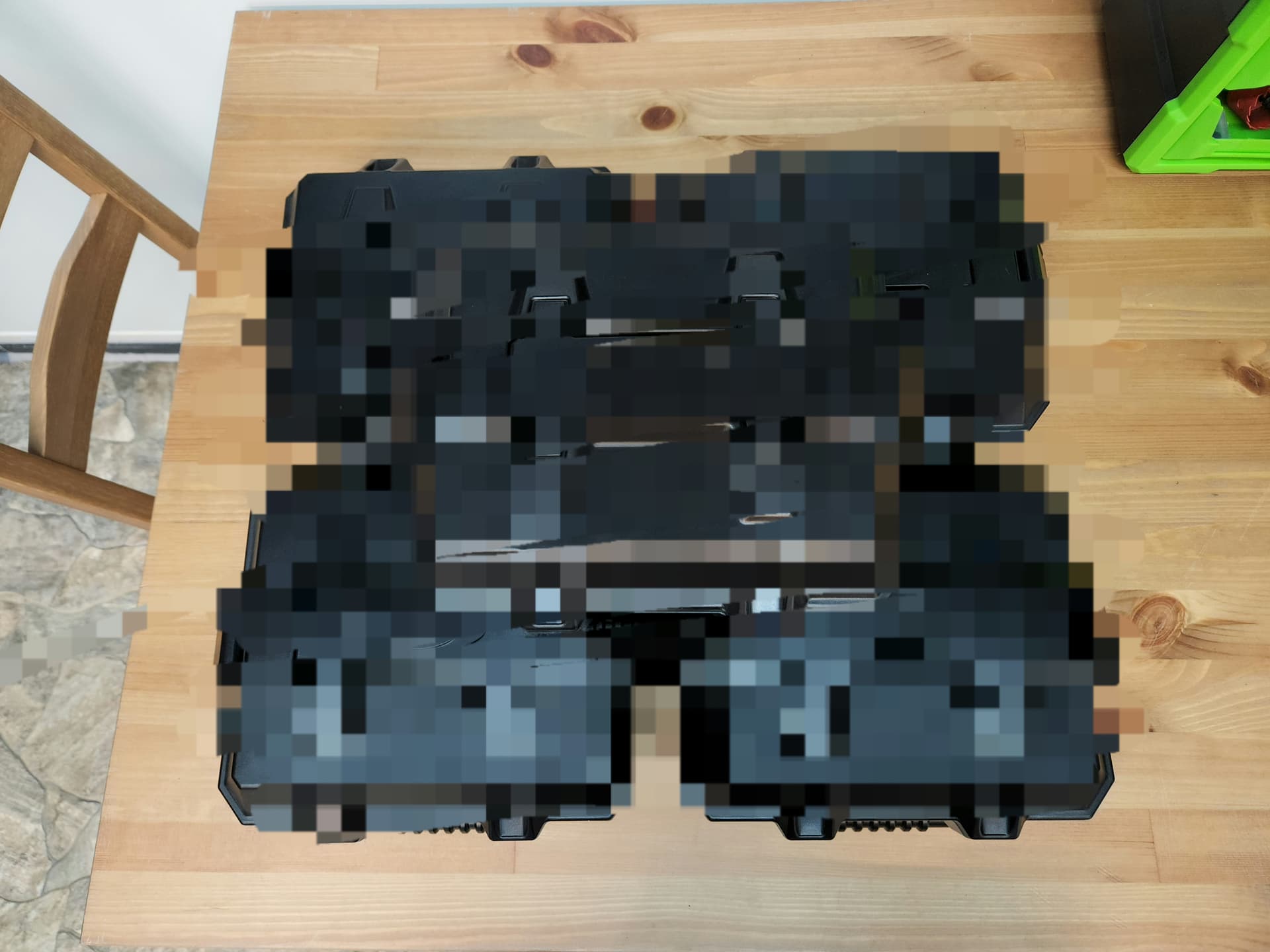

The issue is, as soon as you make a top mounted battery in any other shape than a cube, most of the time it will mean that you’ll be wasting space. It’s okay for bottom mounted battery, because you don’t have two massive feet to place on the deck, and the space is limited as is.
I’m not saying they couldn’t look better, with slopped sides, but unless you make it taller to make up for it, that means either a smaller battery, or less foot room.
TBH I think acedeck did a pretty decent job with this battery box, it’s not a perfect cube that you might see when looking at the top view.
@Venom121212 s concept is nice, but having a slightly wider but much shorter box to place the same amount or more cells seems worth the trade-off.
Also is it me or is the box slanted forward?

Pelican over square box any day
A pelican box looks better as well, like some luggage on a safari buggy. It looks purposeful.
pelican is ok, there are better looking ones
sorry i can’t show more than this, they are unobtainium rn
