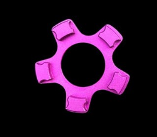

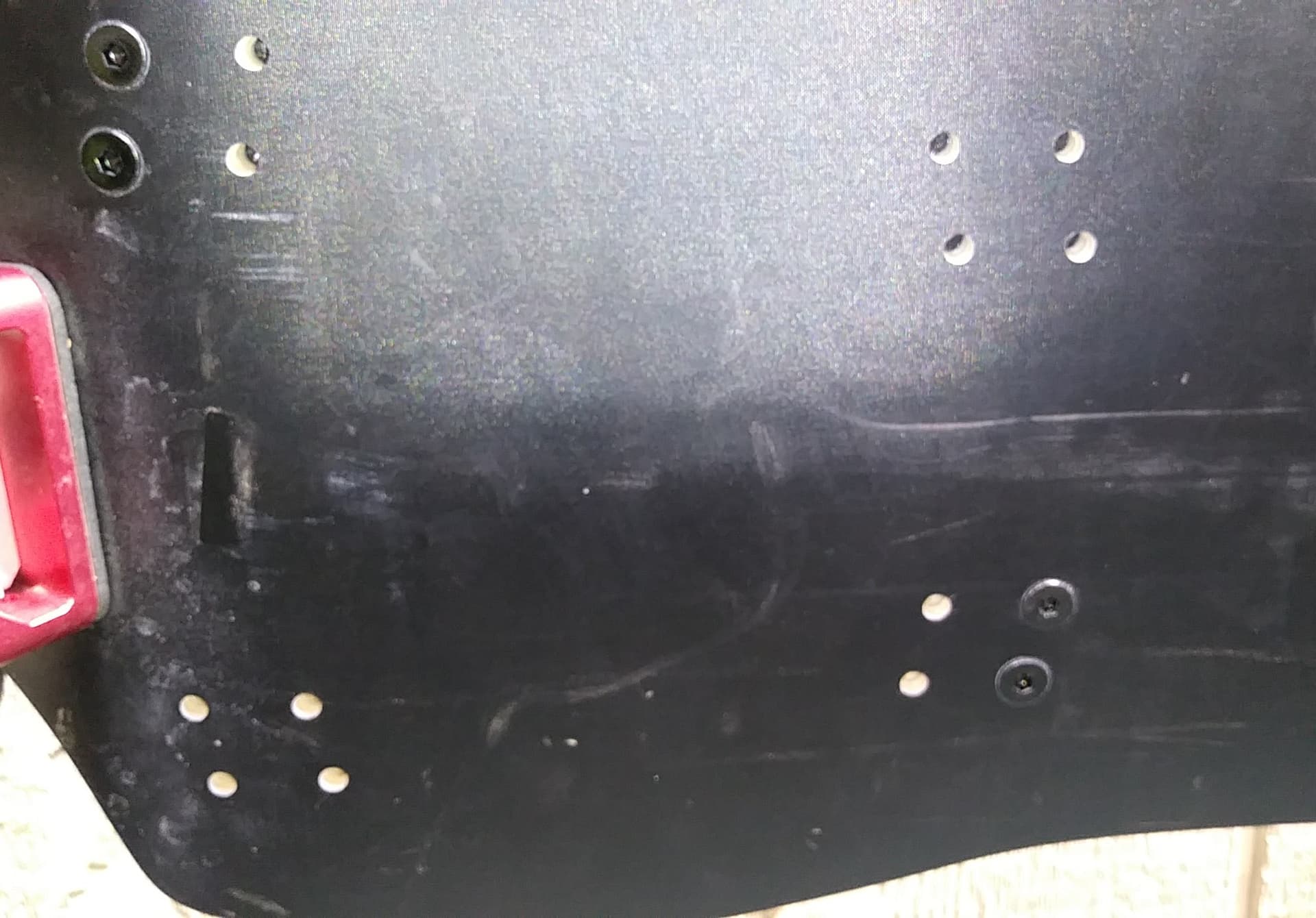

I wanted to run the wider MBS tires on my Z3 so had to make drive adapters. I’m not a machinist but a friend is, retired, and he has some older lathes and a mill so he let me use them and gave me suggestions on how to do it. Huge pain the ass to recreate the drive pattern, at least for me, but I got it done.
Original Z3 drive coupler pattern I needed to copy:
Drive Adapter
Bought a chunk of 4 inch aluminum and went at it:
And mounted:
If I had to do it again I’d take the original adapter, machine a press fit circle into the aluminum plate, and maybe tack weld it.

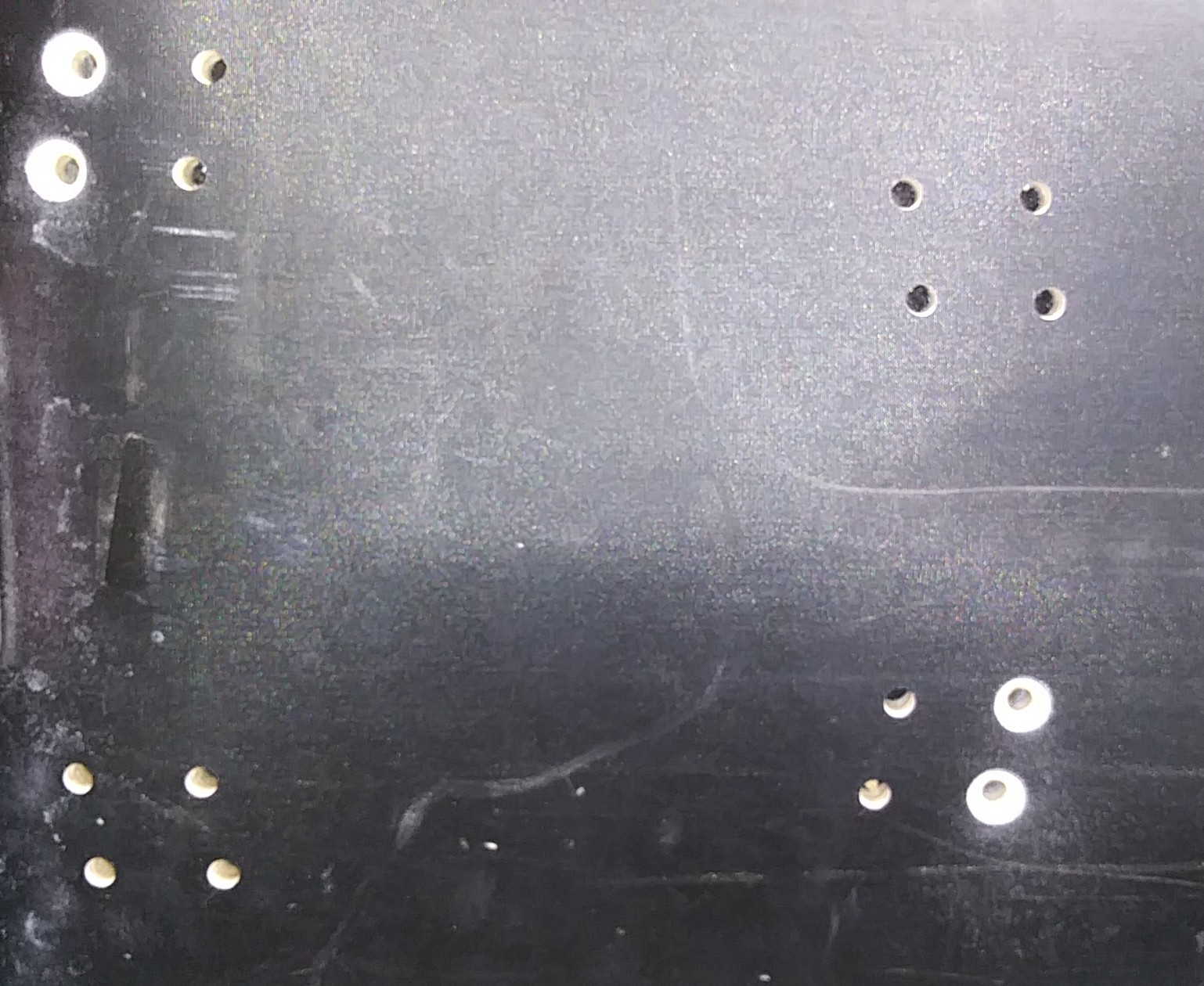

Got MBS bindings, counter sunk the holes so I could use the included hardware.

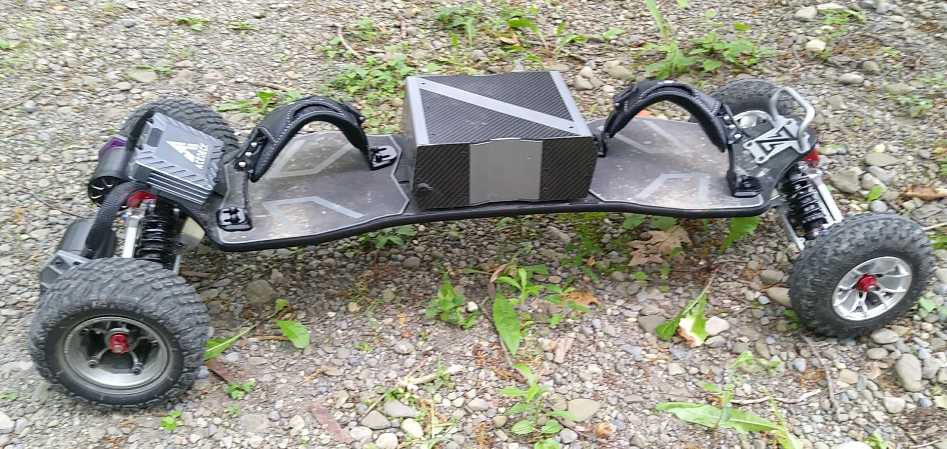

If i’ve learned anything about these trucks it’s that the suspension comes way too loose from the factory. You gotta crank those springs or upgrade to the heavier ones.
I’m thinking something more like this :grin:
For off road the springs seem good, for my 150lbs weight. Probably too loose for higher speeds on pavement.

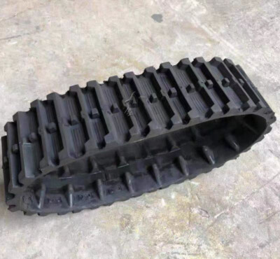

Looks as if this guy cut the sidewalls off of those and made tracks, which is actually something I’ve been considering
Starting work on a track drive system, ordered tracks and sprockets from here:
https://www.robotshop.com/products/lynxmotion-rubber-track-80mm-wide-x-1m-single

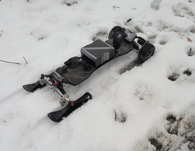

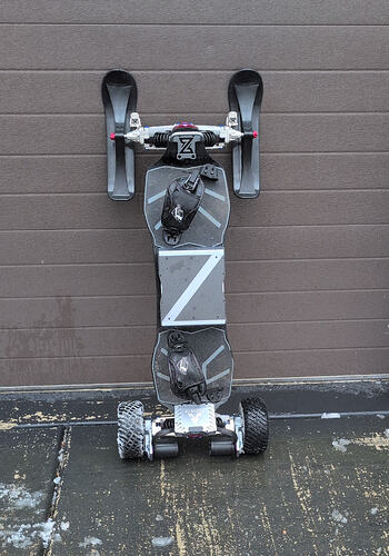

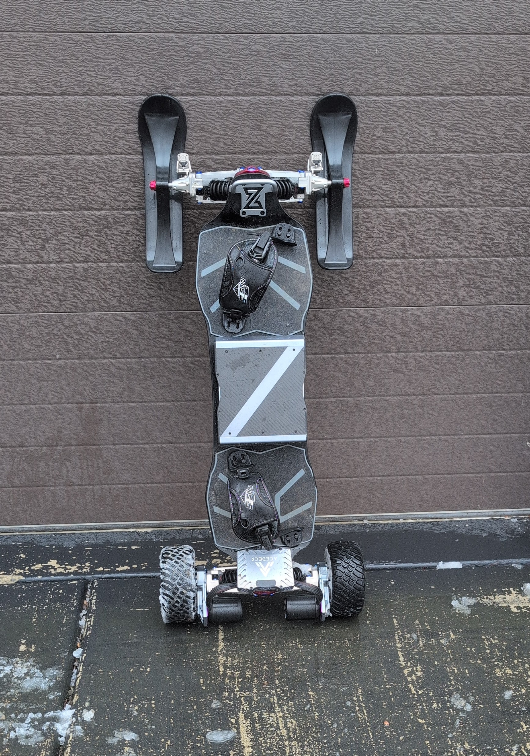

Skis came in today, gave them a test with the tires, heavy wet slush not the best conditions and the tires quickly drilled down and got stuck but the skis did stay on top of the snow better than the front tires would have:
