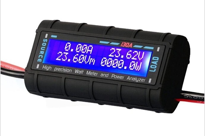

I never Charge without one of these wattmeters inline on the DC OUTPUT.
Knowing voltage is good, but only tells part of the story.
How much amperage is the battery accepting at that charge voltage, tells much much more of the story.
Though an imperfect analogy, I equate knowing only the target voltage with knowing how fast ones car can go, not how fast it is actually going, much less how far it has traveled, or how far it still has to go.
That wattmeter above can fill in most all the blanks, with pretty good accuracy and precision, but should not be trusted to read accurate under 0.1amp, and might not even acknowledge a 0.05 amp load.
But the 0.1 to 40amp range seems pretty accurate among the many wattmeters i have employed over the years.
They also count amp hours so one can guestimate how much of the battery they used, and with time and many observations get a pretty good read on the battery’s ‘personality’ as it ages.
Those observations might allow the observer to see a giant red flag, well before some other indicators might arise.
I’m looking forward to my first smart BMS and the extra data it can provide, but I will always use the wattmeter inline inbetween charging source and battery as well.

Thanks for taking the time to share your experiences,it was enlightening! I’m definitely going to get a watt meter for the DC output of my charger.
