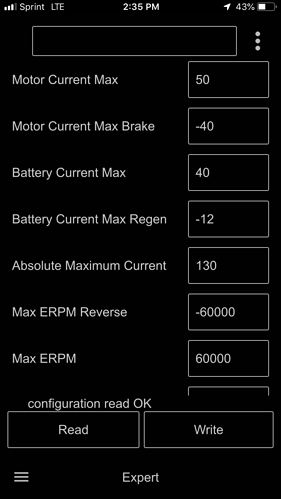

So I’ve been having an issue where when throttling hard my motors (maybe both maybe just oneI can’t tell) will engage the brakes for a split second and almost throw me off. When using metr there is no fault detected but using xmatic I get an ABS_OVERCURRENT alert. I recorded with metr and have highlighted what I believe to be the moment during which it happened once:

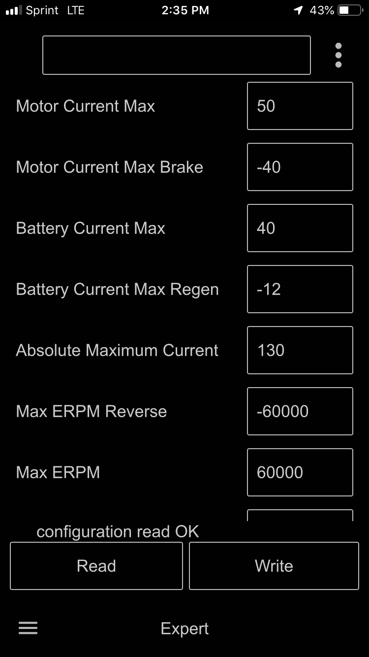

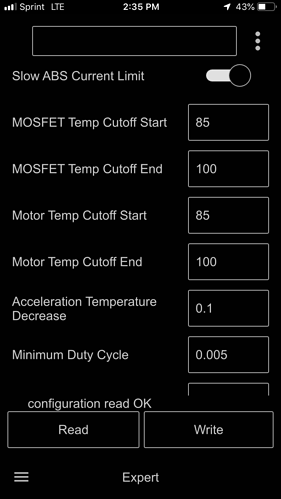

I’m running in FOC mode with the following limits:

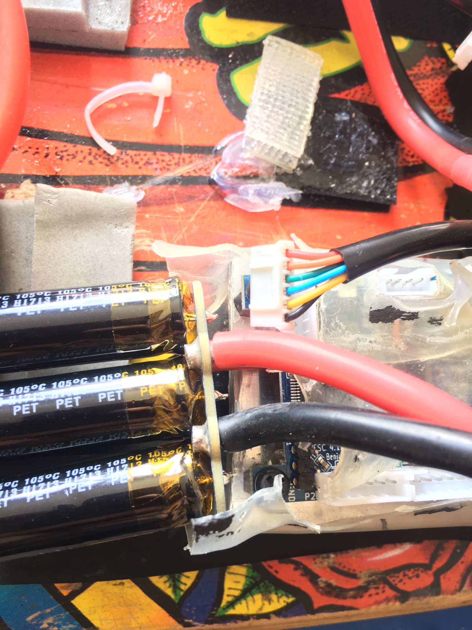

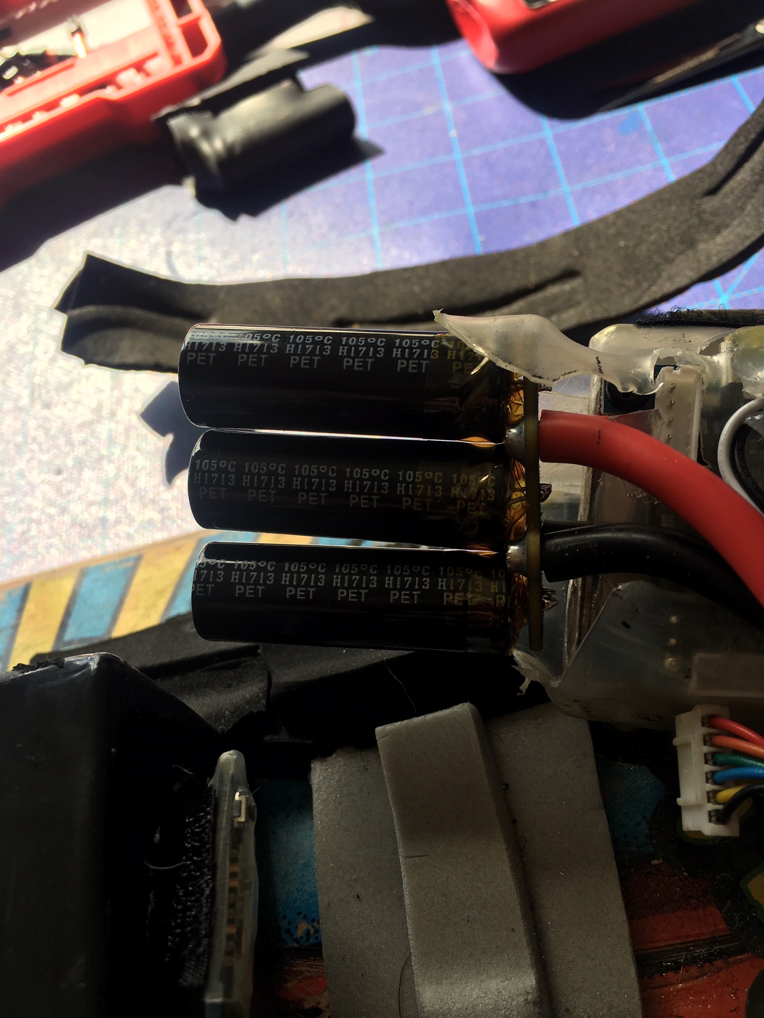

@stratoglide what’s a broken cap leg look like? These seem in order no?
hope that second one’s not too dark
They look fine but so did mine it wasn’t until I wiggled it that I could see where it had cracked. But really it could be a broken connection anywhere.

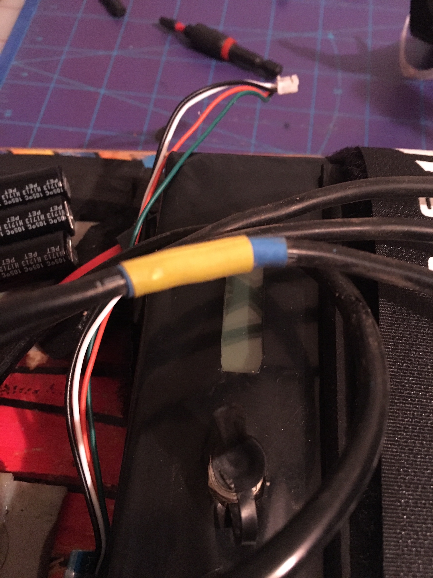

I did pinch one of my phase wires under my tunnel riser and broke the insulation - I wrapped it in electrical tape because it seemed like it was only the insulation. It’s possible I broke a few strands of the wire tho, would this lead to such a problem?
huh? you couldn’t have possibly broken a few stands of wire by pinching it, it could be the cables are under stress in your tunnel riser.
I broke the insulation exposing the wire underneath, I think it’s very possible I tore some strands. Will take some photos when I get home from work

A couple other issues I found were exposed wire. @AlanZhou this is the spot that got pinched which I covered in shrink:
first before removing shrink
then under shrink with insulation peeled back.
