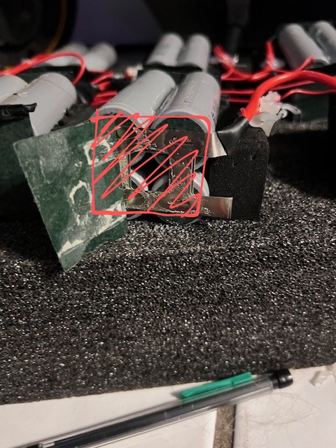

About to start my battery build tomorrow. How should I stack 2x .15mm strips on 4s cells?
Hey guys, so im trying to figure out what the best way to stack the nickel is, the board has a weird battery box so I have to either use ladder or strip, ultimately i went with strip, but i cant think of the best way to weld the nickel together, I feel like sandwiching each layer ontop of eachother would be good, for instance ( 1 3 2 4 ) with number being strip order OR would doing both layers seperate be better (one at a time but 2 directions together) for instance ( 12 34 )
heres an old for refernce so you can understand the dilemma, in either case i’ll have 4x layers on each cell
I’d suggest you just get a wider nickel strip.
hey, i did, manufacturer has .15 x 8mm ladder doubled. i have .15 x 10mm strip, but I want to see if its best to double up the connections in a patty (layered one ontop of another) or 2 together (still doubling up but doing oneside at a time

Better to not use ladder nickel at all. Buy extra wide nickel and use that so it makes the connection for you.
Stacking nickel like what you did is an outdated battery building method and isn’t used for high end packs anymore for many reasons.
sorry if theres confusion, the ladder is how the manufacturer built it. I plan on using strip, I couldnt find the proper 30mm nickel to work with the setup because the battery case is very specific. I wanted to see what the best method to weld the strip would be. should i do each direction doubled first then stack the crossover on top, or do the main positives 1st layer, then stack the crossover in the middle, then main on top, followed by another crossover
Do you have any old prqctice cells , drained to 0.0v, to test whether you can achieve solid welds through two layers of nickel with your welder?

Using thin nickel strips and stacking them for an esk8 battery in 2024 is completely outdated. You won’t find anyone recommending that you do it, and you’ll likely find it hard to garner information on how to do it because nobody does it.

Ur description of how you want to orient or weld is confusing. Sure u can use strip n stack it. Weld a layer, then weld another layer on top. If it’s thin add more
