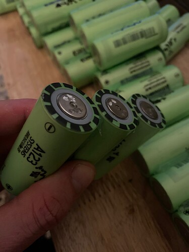

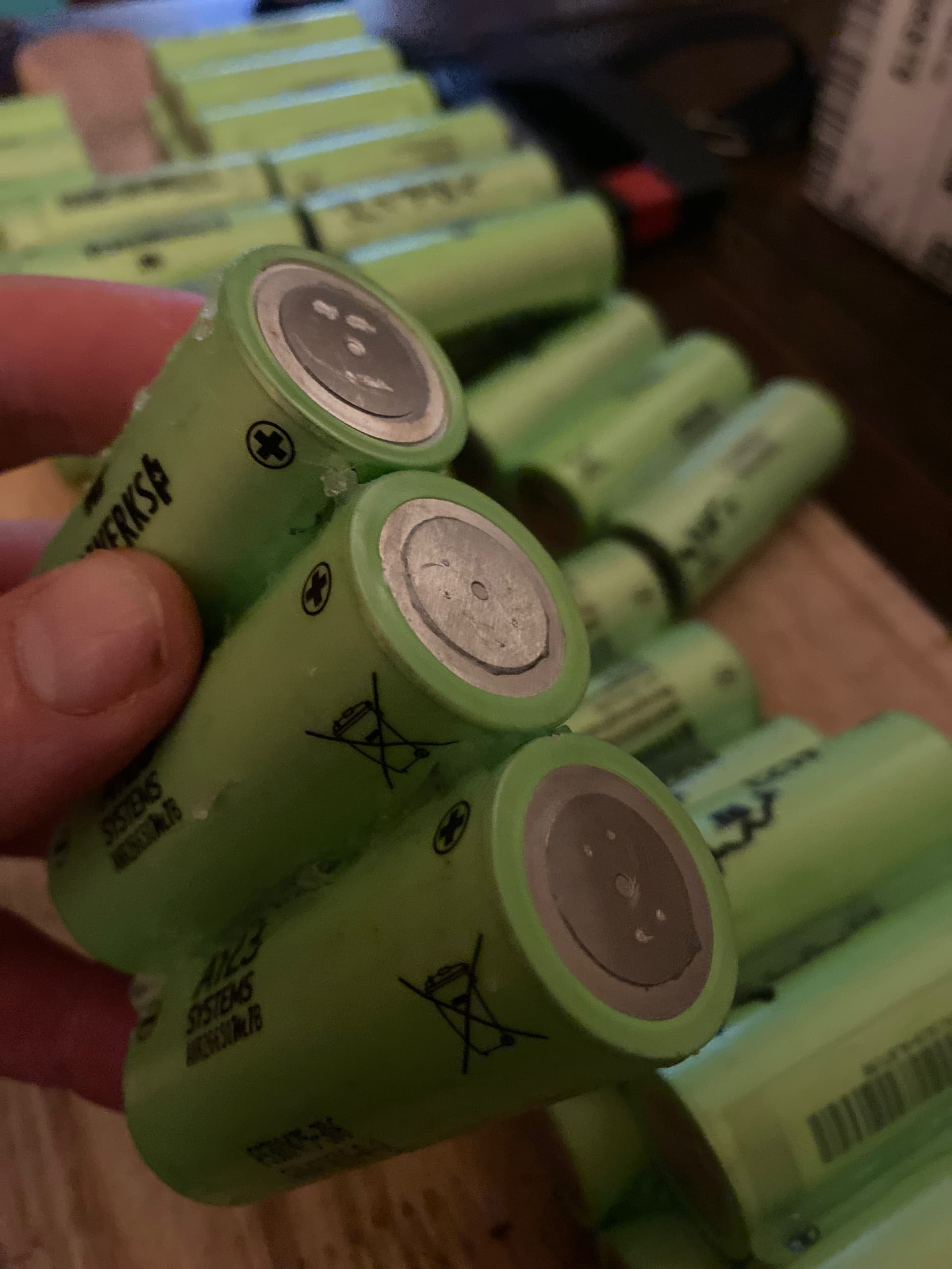

With the A123 battery there doesn’t appear to be a negative around the positive terminal. In fact the positive and negative almost look like they’re back to front. Is there a positive next to the neg terminal or vice versa . I can’t seem to find anything with a multimeter.
I’m asking as do A123 batteries need insulator rings?
That’s the negative terminal in your photo, they are reversed. Did you check with a multimeter?
Negative 1st photo positive 2nd yup. I was just commenting that they look reversed .
They are reversed. I don’t personally know of any reason they wouldn’t also benefit from insulator rings.
