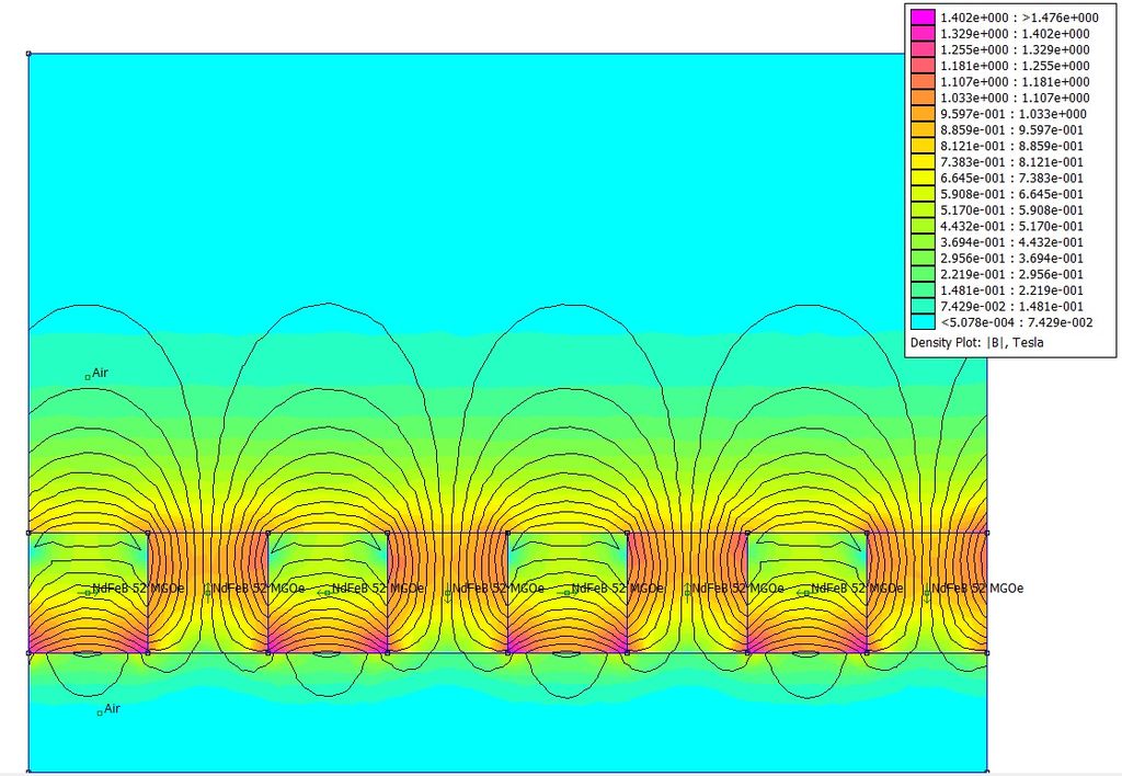

More motors don’t use halbach arrays because they are difficult to construct using assembly line machinery and they will demagnetize each other, so you have to be really careful with things like heat. Halbach arrays are only meaningfully effective at larger air gap distances and they alllow for fewer turns for a selected motor Kv.

i see the hallbach can be demagnetized more easily if exposed to a strong enough field or with the magnets being smaller. (I see in motor analysis software they will give a field strength at which it would occur). They’re more difficult to construct but still surprising some primo manufacturer hasn’t made the extra steps considering the benefits. A carbon rotor with a hallbach would be super bling. And a carbon shaft for the Uber premo power to weight win
Magnet manufacturers have tested the effectiveness of a halbach array, they provide no additional benefit when the airgap is small. Basically in most motor constructions they only come with downsides. Since the magnets are all working to demagnetize each other, I would guess they demagnetize at a lower temperature.

In my simulations hallbach is a great improvement in a motor.
What’s the airgap between the stator and the rotor? What is the Kv difference? Simulation and reality often don’t match up.
I have the model with the air gap at .5mm. I forget the details but remember it producing 20% less electrical resistance for same output

I’ve also played a bit with hallbach in simulations, there is a considerable improvement in efficiency, so not a gimmick
