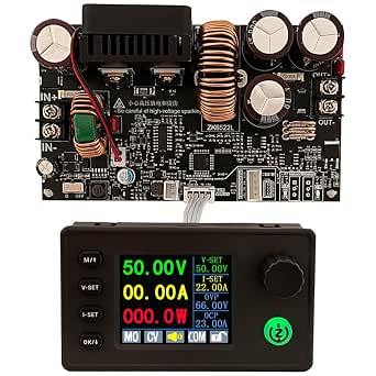

But As Dumbass B I have busted out the replacement Bucker anyway, to check its headroom.
I plugged it into a 39.3v 10S battery and dialed the voltage potentiometer output all the way up.
it stopped rising at 37.19v. This is with only the 0.04 amp load of my inline wattmeter.
My DMM on bucker terminals confirmed this voltage spread.
I thought my other handy 10S battery was stored at 34.5 volts, but it too is at 39 volts, So I cant presently apply a load to the bucker to check how much that 2.1v headroom falls, but it is safe to presume that at 2 amps it would be below 37.19v. and more than 2.1 volts difference between input and output.
Therefore, this bucker the one I linked in post 2 has an overhead minimum of 2.11 volts, at least in teh 39 volt range, with minimal load. This could be different at higher or lower voltages.
But I am going to use it to bring both these 10s batteries down to storage voltage by powering some 12v Fans for several hours, as I do not expect to use them as range extenders anytime soon.
