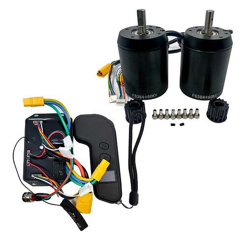

Why choose a single motor? In my opinion, using the 6384 dual motor is much better.
