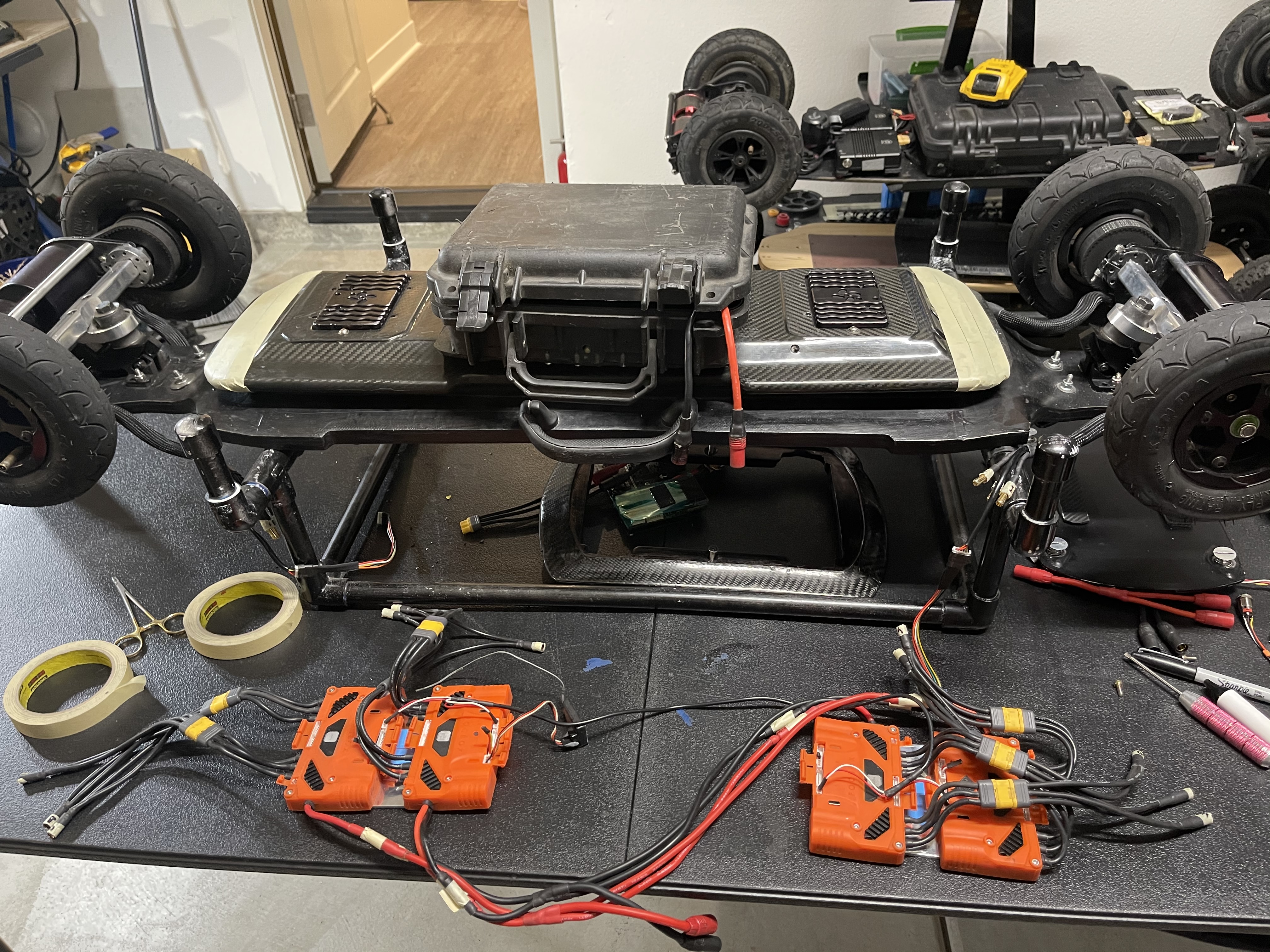

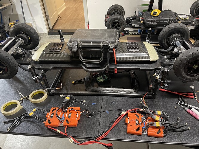

Those long battery cables send chills down my back.
If I thought you’d be anywhere close to maxxing these out, I’d suggest adding a capacitor near each ESC, or at least the far-away ESCs.
But I think it might be fine, IDK
The Carbon GT enclosure never ceases to be hilarious every time I look at it.
The long cables also give me heartburn. I embiggened the enclosure depth and will have room for power wires to take the shortest path to escs.
(The wires will be shorter than original. )
