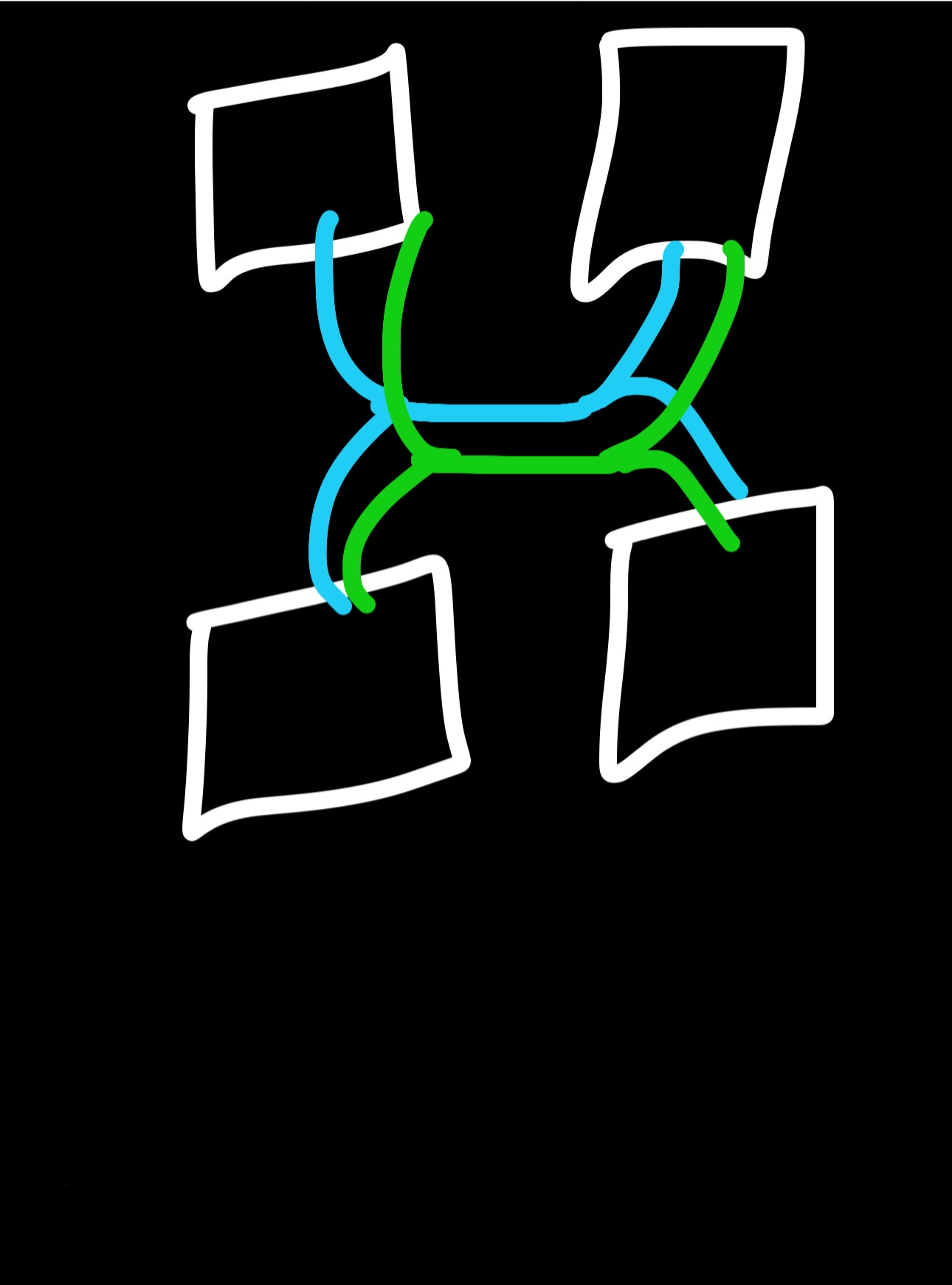

Ima need to see what the canbus wires for 4wd look like
Just canh and canl Between escs… ezpz
Super easy, just 2 wires connecting CAN L and H.
not quite, for 4wd on escs not internally connected like dual skp solos it would need to be double split for the additional 2 escs. This is why I’m asking for someone to show what it looks like
Daisy chain
I forgot the plot from my original comment but I think it was that splitting PPM is simpler. Unless someone sells daisy chained Can Bus wires ready to go for 4 escs. I’ve also heard can is more sensitive to interference so generally it’s better to have them short.
A splitter would work no problems but could potentially be kinda ugly and difficult to cable manage neatly. If you daisy chain you can sneak two wires into the same crimp(s) and make a single continuous harness that plugs into all 4 escs.
not sure how a splitter would help any with wire lengths, much of a muchness there. But interference can be somewhat mitigated by twisting the canh and canl wires together and even further protected by adding shielding and keeping the wires away from any high power cables (battery or phase). I don’t think the cable lengths in an esk8 are posing any sort of measurable problem in terms of CAN connection but it certainly doesn’t hurt to keep those cables as short as you can.

i haven’t had any issues running it even with different esc’s, skp solos in the front and g300’s in the back. i’ve put that board through the wringer too with half a season of racing plus practice. not even a hiccup.
I mean you’d be making the same splitter regardless so not really?
that’s what my splitters look like for can
on ppm, i had an extra split going to a female jst connector so i could plug in my ppm receiver
