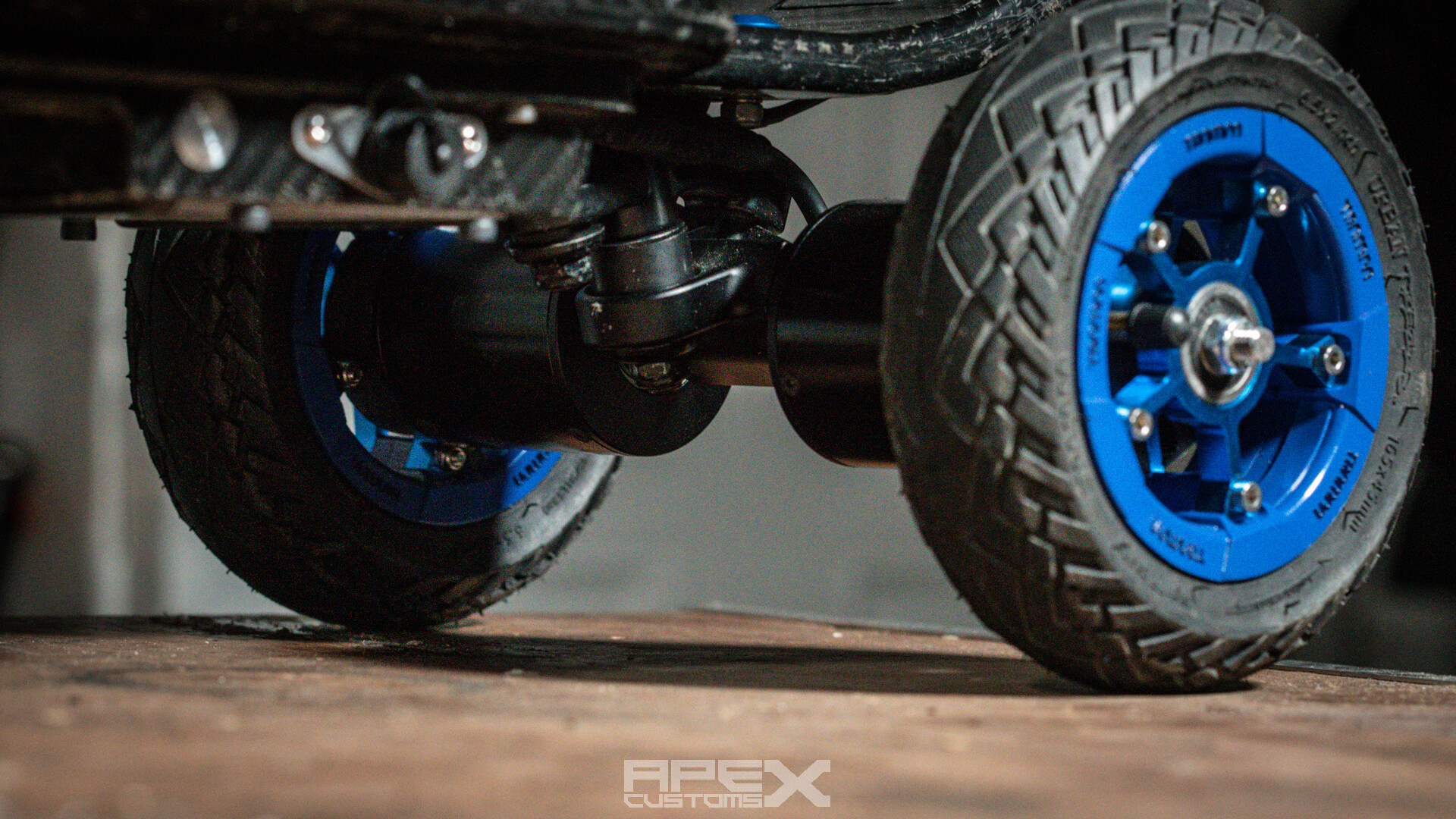

Just got this finished up for @Ricardo
Specs
Evolve Gen 1 deck
12S5P Samsung 30Q pack with Smart BMS
2 x FOCBOX Unity Motor controllers
Elofty 58kv DD motors x 4 on DKP trucks
Trampa superstar hubs with 6.5 inch urban tredz
Custom POM push fit adaptors
Flipsky VX2
Pictures
Ive had a quick test ride and fuck DKP trucks! This thing feels wild and im not sure 4WD + DKP is a good idea, ill swap the rubbish china thane bushings and try again.

Are you running the same amount of power to the front and rear wheels?
Good question, at the moment yes but is something to play with… such a strange feeling on DKP.
The whole build was around the Gen1, we’ve essentially tried to get the most out of it, there isnt a mm more space in there trust me! A good challenge
I like the idea of breathing new life into an older board like this. Yes, the bushings that come with them are hot garbage.
I pulled the upper arms and use them like a tkp. Been working well like that for a while now.
Absolutely mate, I cant wait to see someone who can ride DKP have a go because I cant ride them at all. I have channel (and other :relaxed:) trucks in my blood now!

Why am I using the past tense? Well, the board is now a 3WD. In the wise words of Monty Python, “E’s not pinin’! 'E’s passed on! This motor is no more! He has ceased to be! 'E’s expired and gone to meet 'is maker! 'E’s a stiff! Bereft of life, 'e rests in peace! If you hadn’t nailed 'im to the perch 'e’d be pushing up the daisies! 'Is metabolic processes are now 'istory! 'E’s off the twig! 'E’s kicked the bucket, 'e’s shuffled off ‘is mortal coil, run down the curtain and joined the bleedin’ choir invisible!! THIS IS AN EX-MOTOR!!”
So, one of the Elofty motors failed (the winding is crap) so the board is dead for now.
@Lee_Wright and the boys at Apex did a absolute beast of a job, can’t fault them, but unfortunately the DD technology isn’t yet mature enough. Better days will come.
I’ll leave you with the handover video, and I’ll try to control my urge to buy replacement units.
