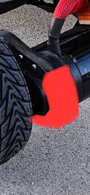

Has anyone designed any bumpers for Fatboy
SS Mini that’ll protect the gear drives and motors when you stand up the board?
Does anyone have a 3d model file of a fatboy mini? Or can someone scan one? I really want to cast these bumpers to be able to stand the board up and not mess up the gear drives.
All bumpers here: 3DServisas Gear Drive Bumper Guard by 3DServisas - Thingiverse
Thanks for that, but what I’m looking for is kinda like this where it comes from the bottom and wraps around the back so to protect the drives when I want to stand the board.
SS-MINI-Cover-V1.stl

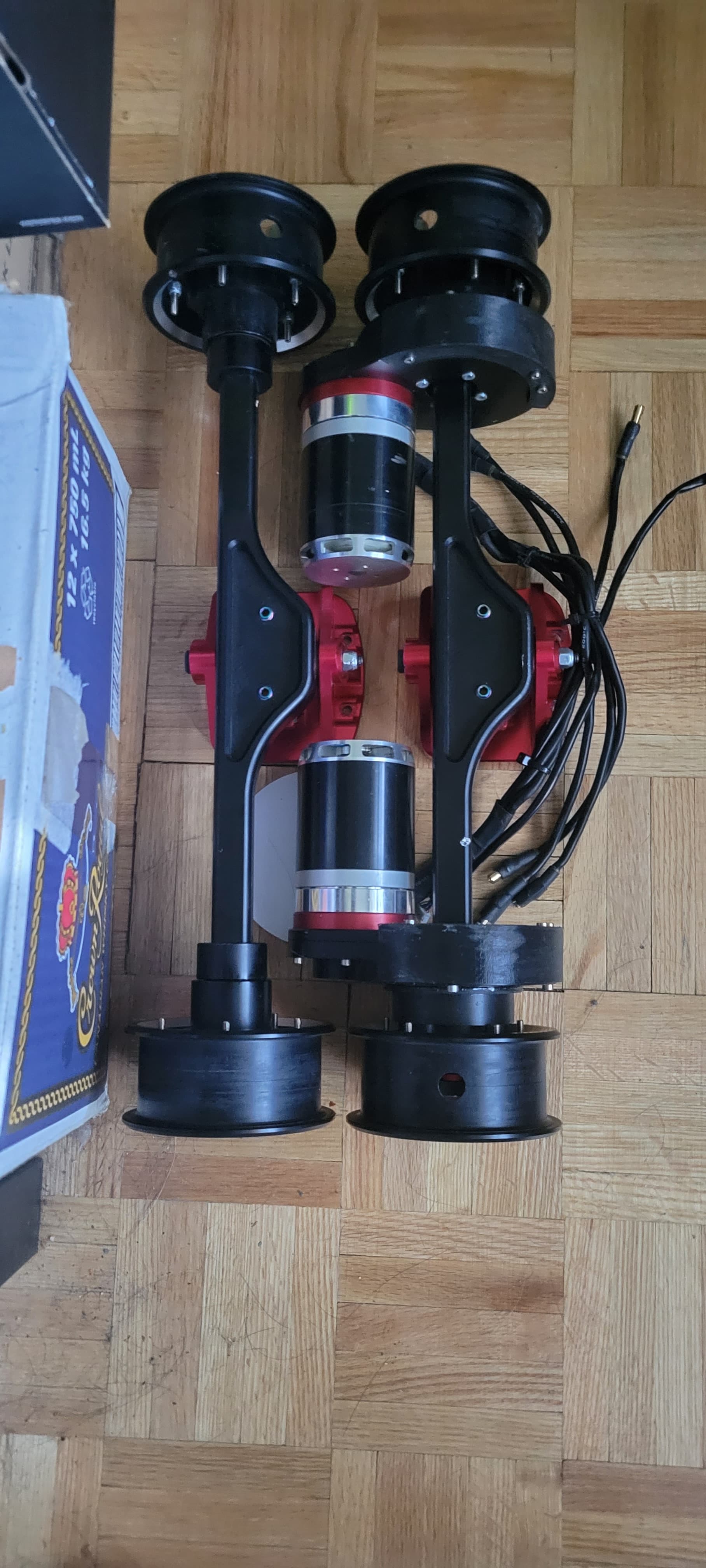

Hey @3DServisas is there any possibly to upgrade Finality AT version 1 to version 2?
I would really like that free spin of the v2 drive.

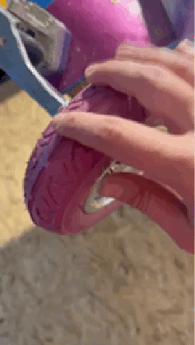

Is the skyart one the same? :sweat_smile: 3ds stuff confuses me
Do i need to balance these shits and how?
Its not the balabce issue. It is a lack of free roll that finality v1 are known for.
I thought it was because of a seal that was removable? is the pic i have of the same is anyone aware? All the ones i see on 3ds website look ever so slightly different. Wouldnt the lack of freeroll also prevent balancing? Or is that a non issue on the 3ds rims?
I didnt know there is a seal that could be removed. Ill look into it tomorrow.
Yup balancing is not doable in this case.
I made a 3d printed adapter to be able to put this rim to the standard skate truck and be able to balance it.
I could be wrong, dont quote me, but i remember seeing somewhere while reading around, that you should get better freeroll if you remove the gasket in the wheel adapter i think?
If you’re interested in a couple full sets of trucks and drives, I’d probably part with them for a lot less than I got them for. I’m moving away from finality
I would definitely like to hear if anyone has gotten better freeroll after removing the gasket. I’m also wondering if the gasket would need to be replaced with a 3D printed alternative that would still block ingress of crap while not adding any friction. I can’t remember if there would be much of a gap without the gasket there.
I tried to remove it today. It is not an easy removal. It looks like that gasket is pressed in. Will try tomorrow again.
