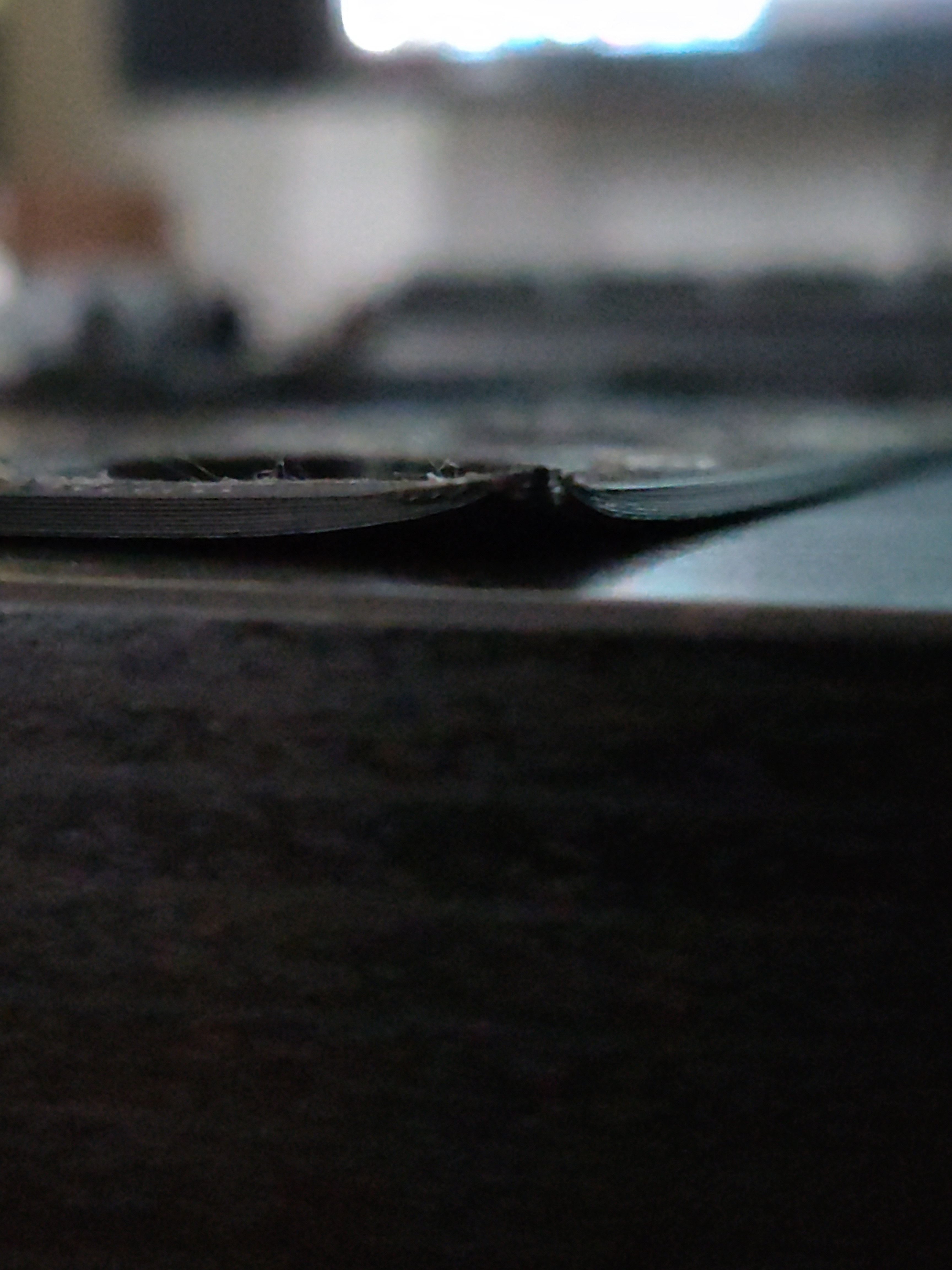

One problem i do sometimes have is corners lifting up. Especially if i don’t use a brim.
Temp is 230/65 with PLA
Currently testing 210/55
Corners lifting often times happens on the very first layer when the nozzle does the 90° turn to.

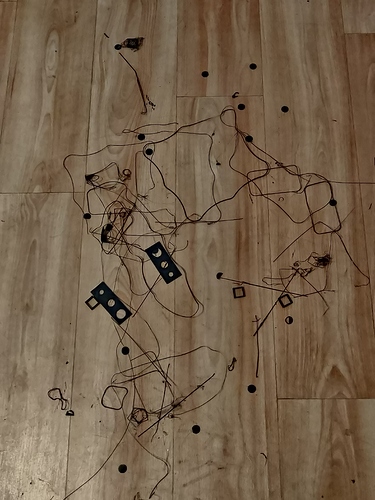

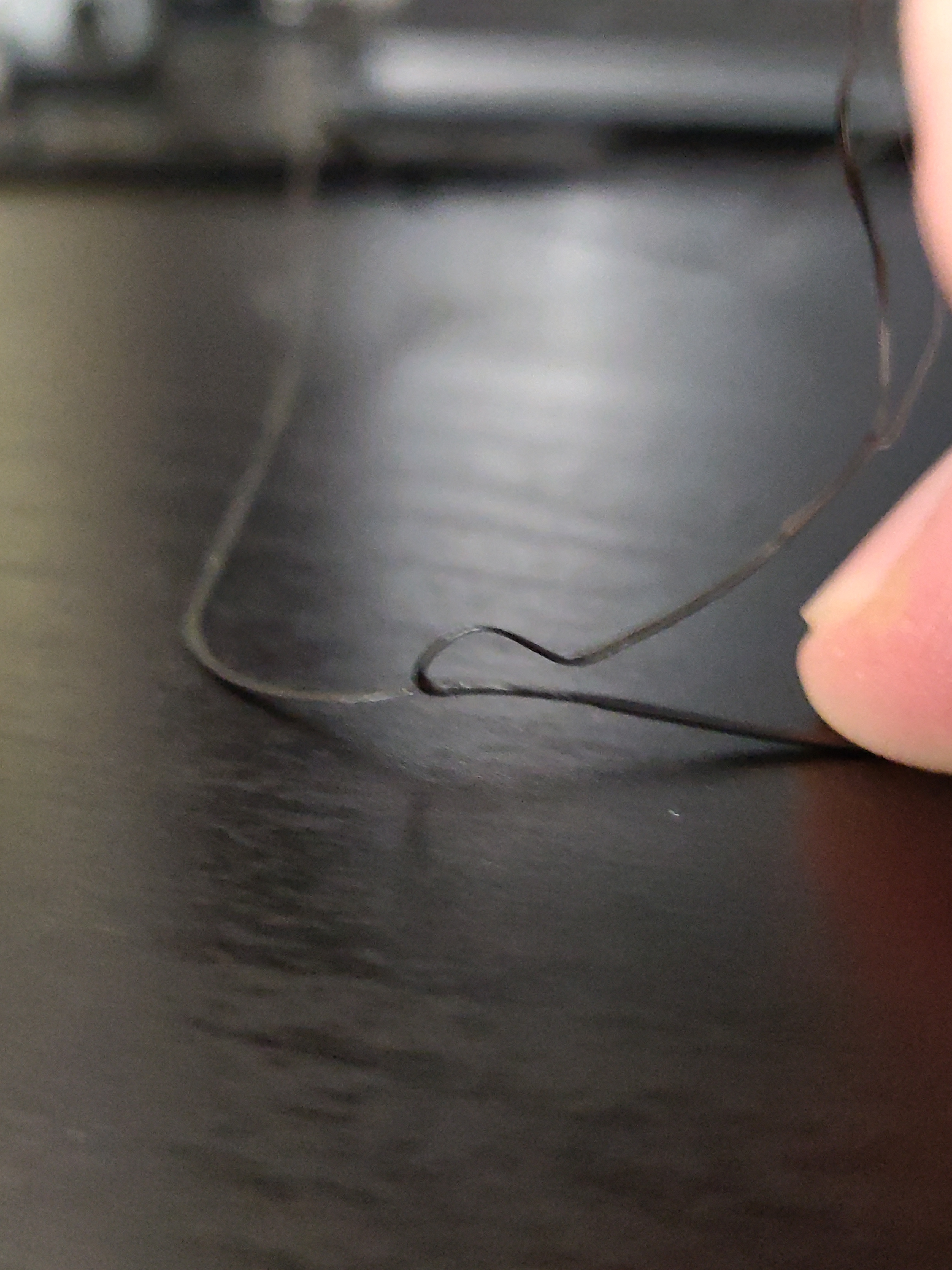

Or what sometimes happens is that the very first line it lays lifts up and attached to the nozzle getting dragged behind, if its not getting dragged it’s just curled up.
here you can see how it curled up.
Try sandin the buildplate with some steelwool very lightly, I have to do this once every few monts to keep the prints sticking nicely to th PEI sheet. Sometimes the print just start to lift up grazy, so after cleaning with alcohol and sanding a bit it sticks like a charm again.
Glass bed :slight_smile:
While we are at it. I feel like i can remove prints from the glass bed easier when it hot than the stock matt that came with the ender .
Use a thin layer of white PVA glue. It will stick well. To remove it I apply a shearing impulse with a small hammer
But apart from bed adhesion, if you use smaller layer heights then it will work well.
This is a super common problem with 90 degree turns/corners. When modelling my own parts my last step is always to add a bunch of small bevels/curves to any turns that would be 90 degree or more changes in direction for the printer since this will greatly reduce the chance of a corner pulling up (get rid of the corner). Alternative if using someone else’s model I’ll just add brim like you mentioned to overcome any warping at corners, I don’t see this much with pla but using pei sheet too so things stick pretty well. If you are using z-probe or otherwise could get your nozzle a bit closer to the bed or in slicer settings set the first layer extrusion flow to 150-250% of normal so it makes an extra fat sticky first layer (also typically I go like 5-10 degrees hotter on first layer than the rest, more gooey/sticky and I don’t care about overhangs/drips on the first layer really).
Removing the corners (or rather smoothing them out) also helps to reduce or eliminate “ringing” or echos from turning a corner and the printer slightly overshooting and bouncing as it’s trying to achieve a linear path.
The pulling up on corners occurs because as the filament cools it contracts and at a corner it is getting pulled in, in two directions and so tends to want to curl, with a sharp corner there isn’t a lot of material at the tip/point of the corner for it to “hold down” against the contracting plastic further towards the center of the model/shape.
