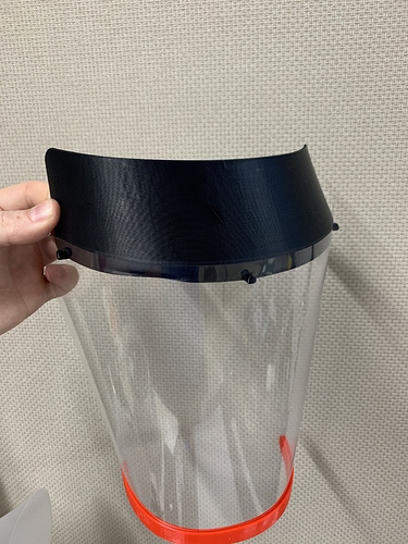

This is one of our larger “factories” for face shields. We are almost up to 20 printers in Ashland, Ohio.
I count 9 anycubic firehazards :joy::joy:
Glad to see other grinding these things out, awesome initiative
Who provides the front transparency? How much does that cost?

There is a lot that is free from donations! It is all over schools that no longer use it. We may also buy it for $0.15 to $0.35 per sheet. Total shield cost us $2.05 absolute max…people happily pay more to further our cause.
On a really cool note, vase mode is something that I need to utilize on more prints! This uses several “vases” which are over extruded and squish together. Print time dropped from about 2-2.5 hours (5 for people who ran feed slow AF) down to 45 minutes. Better yet, the nurses still want them.
Yeah, you can get really clever with converting parts to vase-only by adding very thin slots in strategic areas to create connections between walls that don’t touch in the 3d model. Here’s a really good example of that. https://www.thingiverse.com/thing:2277253
That is exactly it! I never did this before, but will have to try modifications on a few models. Thanks for the excellent example.
