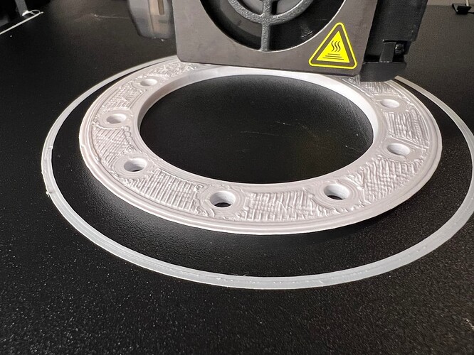

I dial my Z offset back away while printing because it looks like my nozzle is too close but once I get far enough away to avoid what appears to be nozzle drag marks on the infill, I can clearly see I’m now too far away and my lines are barely touching (if at all). Tough to find that sweet spot. This was one of my earlier layers a few mm into this print before I backed off my Z offset a bit
That flow is way high. It shouldn’t be leaving drag marks like that throughout. White filaments always print oozier for me due to lack of fillers. I tend to print them a bit cooler and at like 97% flow.

Thanks I’ll try backing down on the flow!

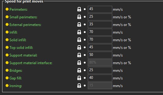

I use prusaslicer so no idea, but these are my speeds (on my prusa) which work okay on my 0.6mm nozzle:
