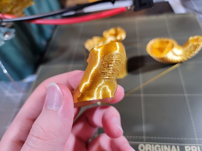

I’m attempting to print the BOTY trophies, and I’m running into some quality issues.
  • Prusa i3 MK3s
  • 0.4mm nozzle
  • Silk PLA
  • 220°C nozzle
  • 60°C bed
  • 100% cooling after the first layer
  • In an enclosure for consistent temps (not heated)
  • PrusaSlicer, nearly stock “Generic PLA” slicing settings (only adjusted wall thicknesses, etc.)
  • manual supports added for supporting the balls only
I’m getting some serious zits on the layer changes. Im thinking I’ll try setting a fixed z-seam position and aim for the back of the legs.
I’m getting really poor overhangs on the back sides of the legs and tail. I dont have any ideas for this.
Any suggestions on how to fix these quality issues would be greatly appreciated! These are the BOTY trophies so I’m aiming to get the best quality I can.
Thanks!
All of the silk filaments do this weird thing where they puff up and stay stretchy and malleable for a few seconds out of the hotend. Imagine it like a petg/pla hybrid.
I’ve noticed that I have to turn flow down a few percent and turn fan speed down a bit to avoid those wavy zits. I find 98% flow, 210° C nozzle, and 75% fan works best for me with gold silk. Turning speed down a bit helps with the puffy filament issues. I do about 50mm/sec overall and I think 25mm/sec on the walls.
Keep me posted!
Zits are a result of not enough retraction, or a retraction speed issue. (overextrusion on layer changes).
Ugly overhangs are a cooling issue. Probably not getting enough airflow to the back side.
Silk filaments are just more fussy and can bring out tuning issues more than other types.
