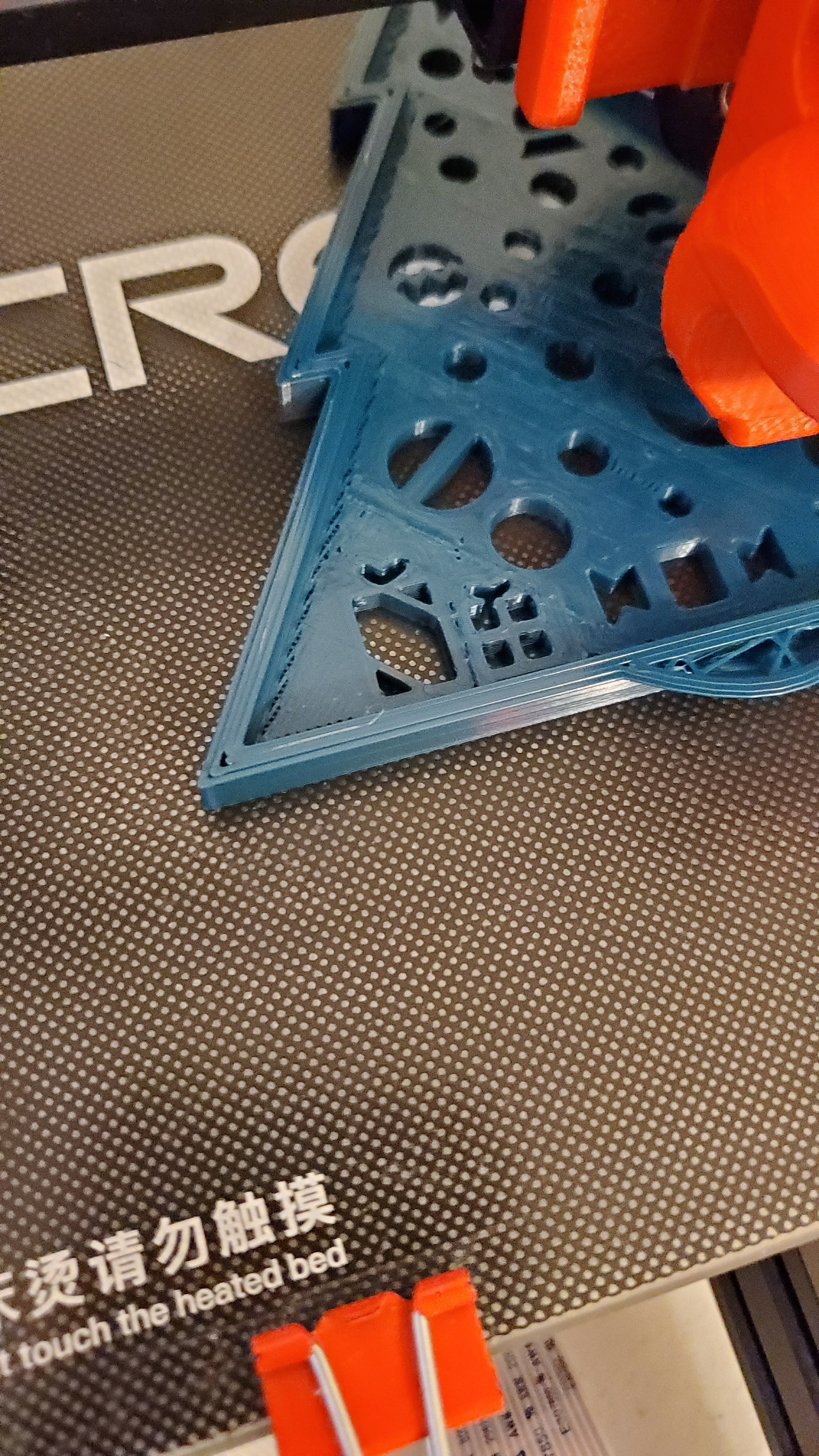

Not really having bed level or first layer issues. Just needed glue to help it stick. But after cleaning bed and raising it a bit, it is sticking perfect. Below is the print that just came off. View is the side facing the bed. Nervous to do petg on this glass. Will probably do a small print first to test if it sticks too well.

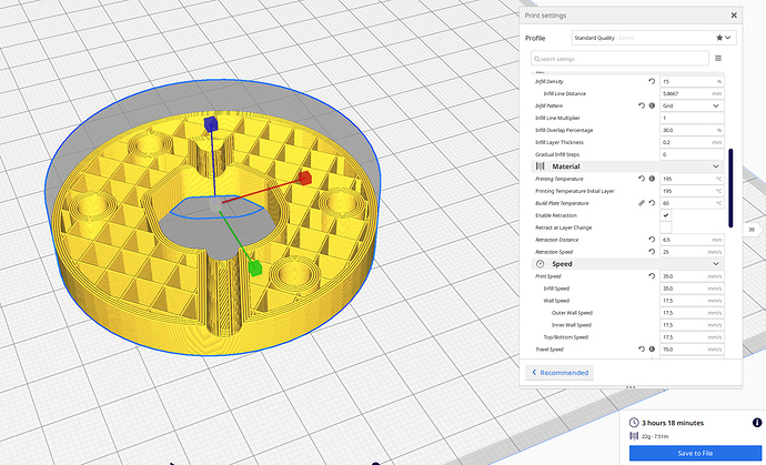

I’m always getting pretty high time estimates. Can’t be normal? 3.3 hours for that small piece??
13 Hours for the fender? 0.2 resolution.
I get the same time too. If I remember correctly.

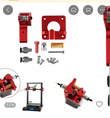

How funny, I just came on here to ask you something about my extruder that arrived.

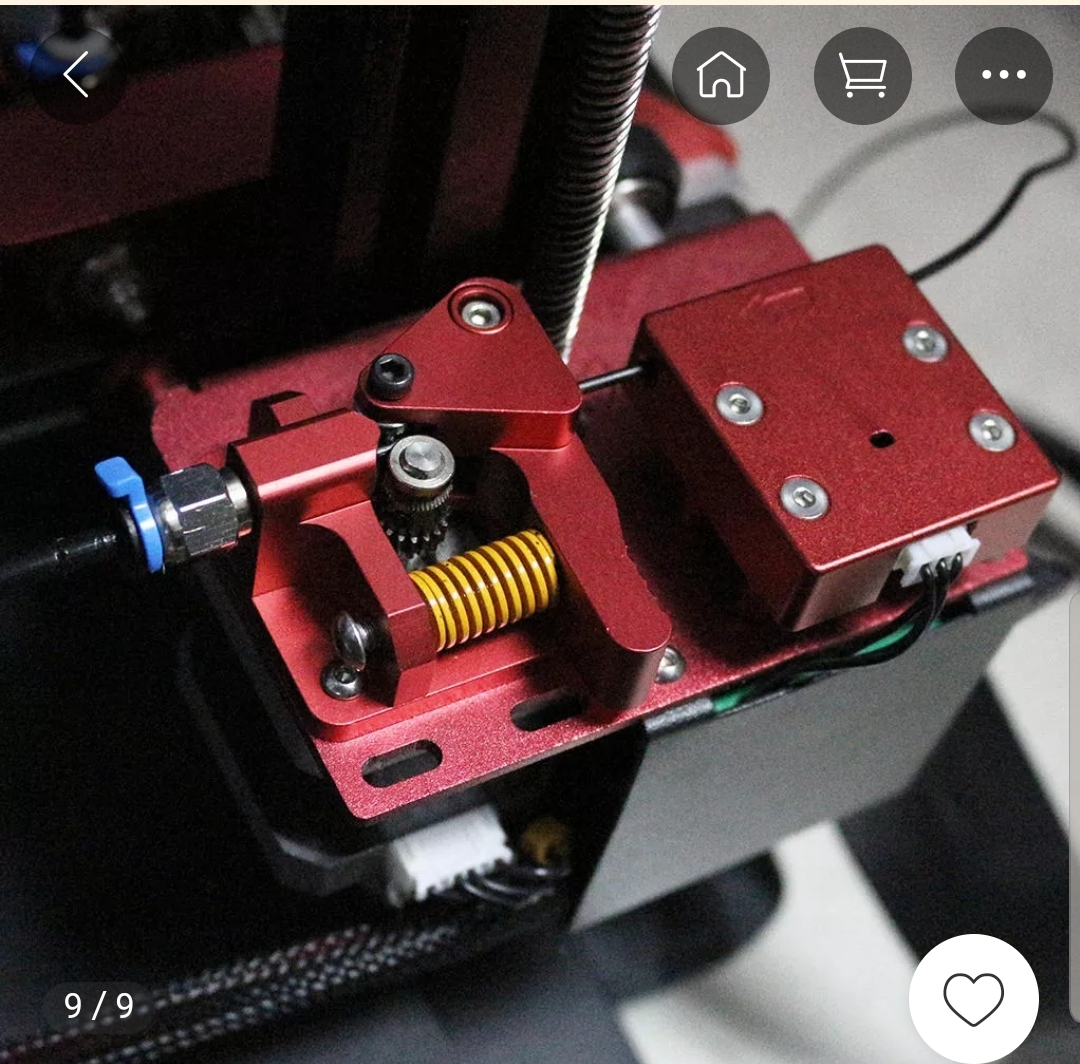

I installed it the way my old extruder was installed and this photo shows
But then the last photo on the item link has it installed backwards (filament entering through spring lever)
It shouldn’t really matter as the motor is controlling direction but just curious if you have a preference.
Haha. Nice coincidence. As for the orientation, I don’t think it would make any difference. Let us know if the extrusion gets consistent with this.
Also that last photo doesn’t look like it uses the tubing holder piece. The first photo shows it holding tubing. Should I have a small piece of ptfe tubing on the inlet?
Inlet shouldn’t matter. The path from outlet has to be through a tube until the nozzle though.
Thank you, I will do some test printing in the next few days and see what changes.
After switching extruders, I was still getting underextrusion at 0.78mm line width and 0.6mm nozzle.
I started bumping up the flow rate and saw some improvement. Normally, my old extruder would start binding around 120% flow rate. This dual gear extruder allowed me to keep increasing the flow rate until lines looked more correct.
This was at 142% flow rate though, that seems unhealthy. I got no binding though and prints filled in better.

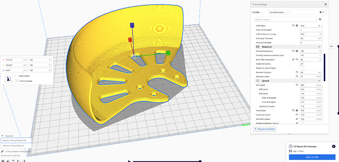

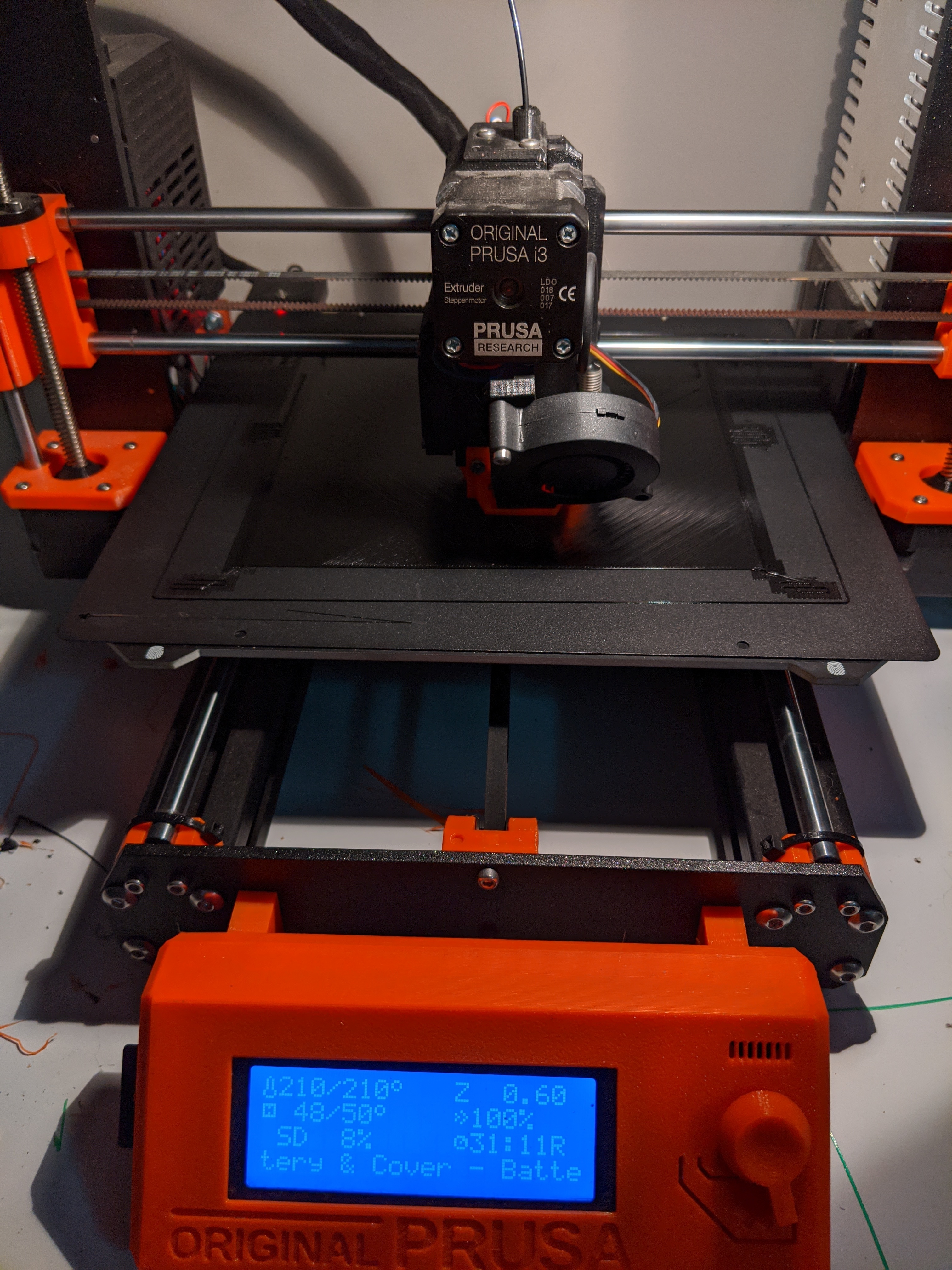

My petg cover bit the dust, after I carelessly dropped my board. So trying to print the thing with 4 walls out of TPU and some other mods… also will use back pack straps to hold the battery on instead of relying on double side velcro and duck tape. 31+ hrs to go for one half (using TPU at .2mm layer height it’s slow going but so far so good, wish me luck).

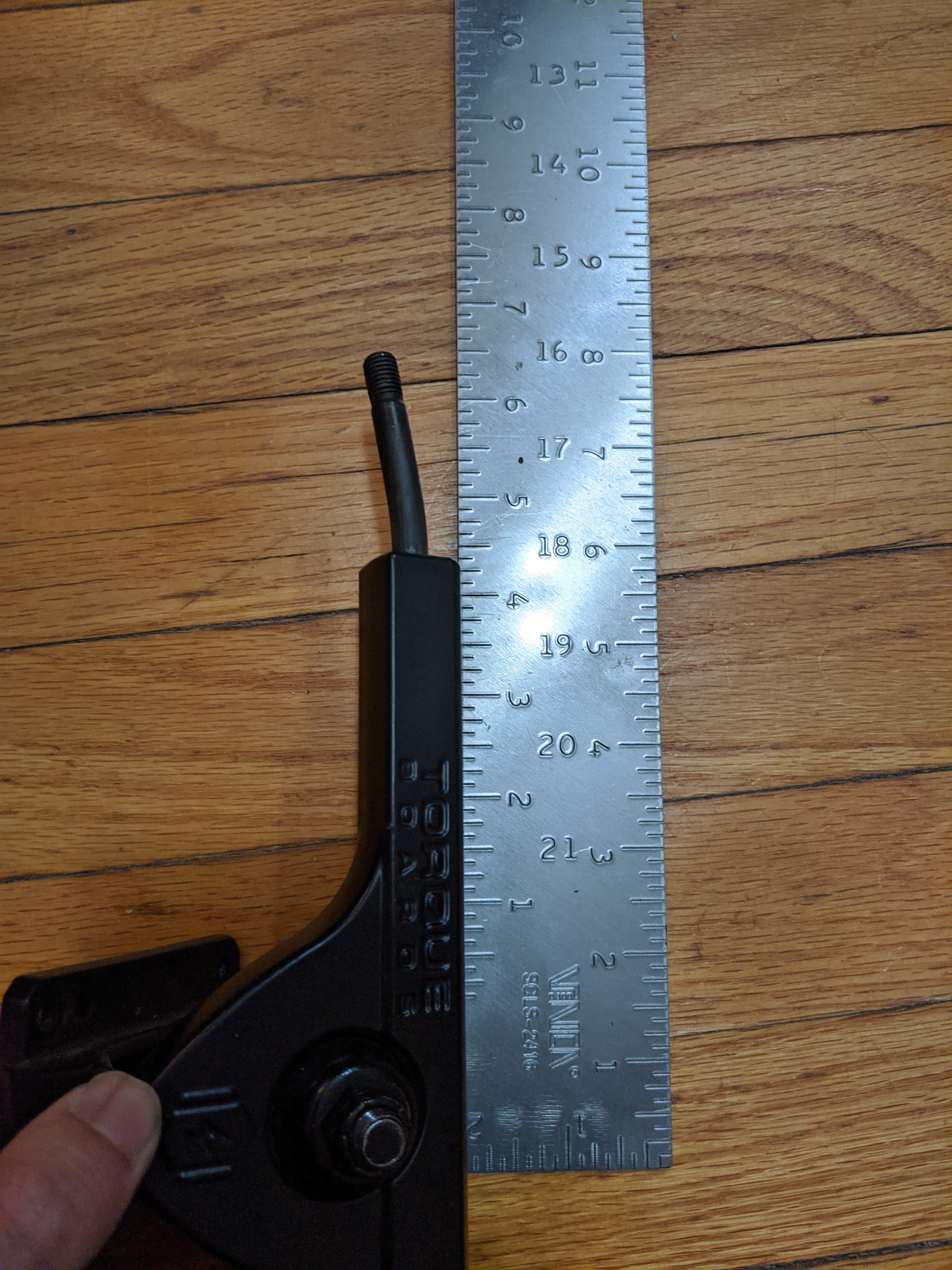

In other news torqueboards trucks aren’t impervious to being rolled over by cars.
TPU seems to be the ideal filament for this application, really interested to see how yours comes out. 100% infill?
Also yeah unfortunately thats not the first bent TB hanger we’ve seen due to being run over by a car. Maybe it saved your deck though we never know
