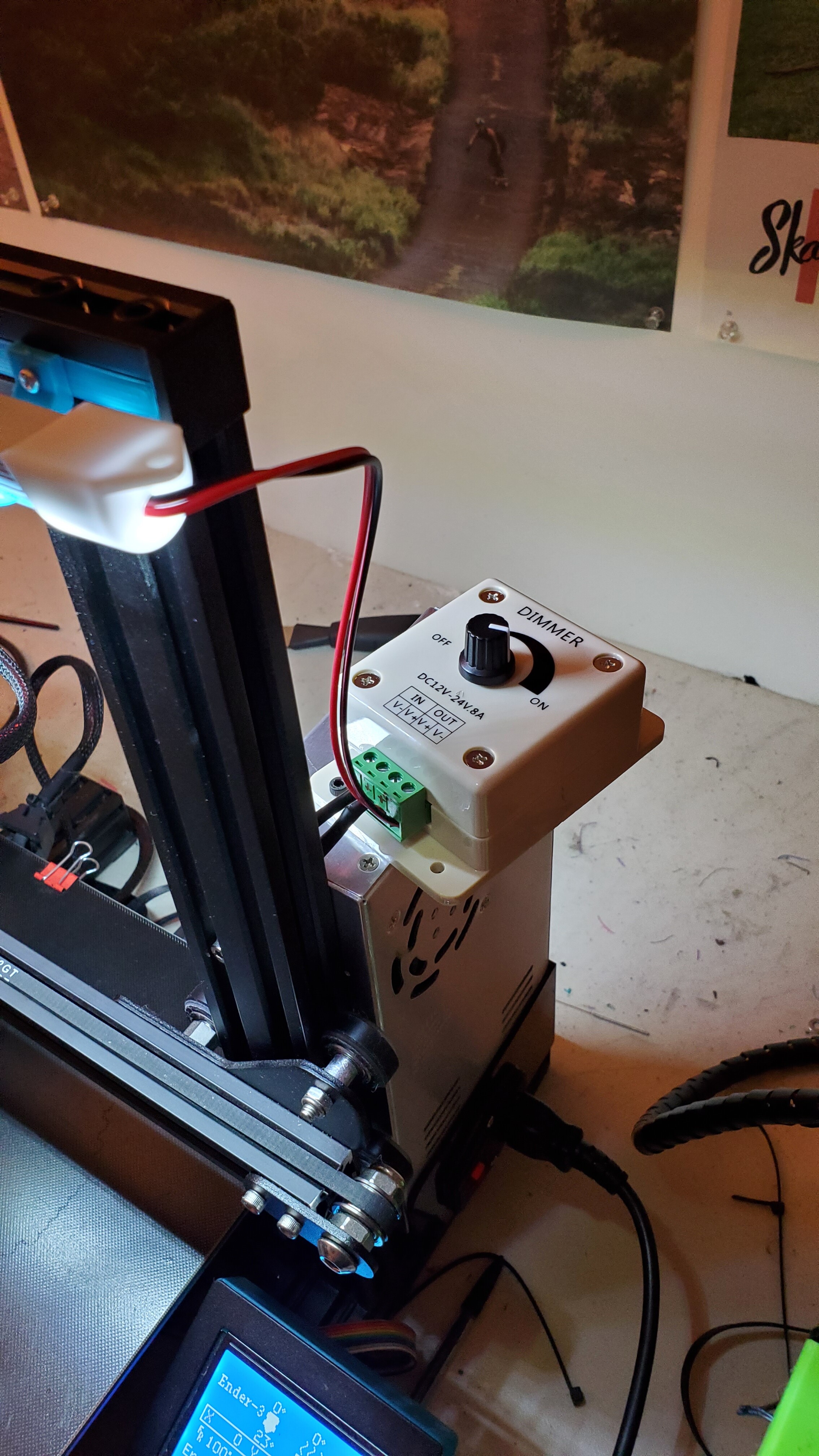

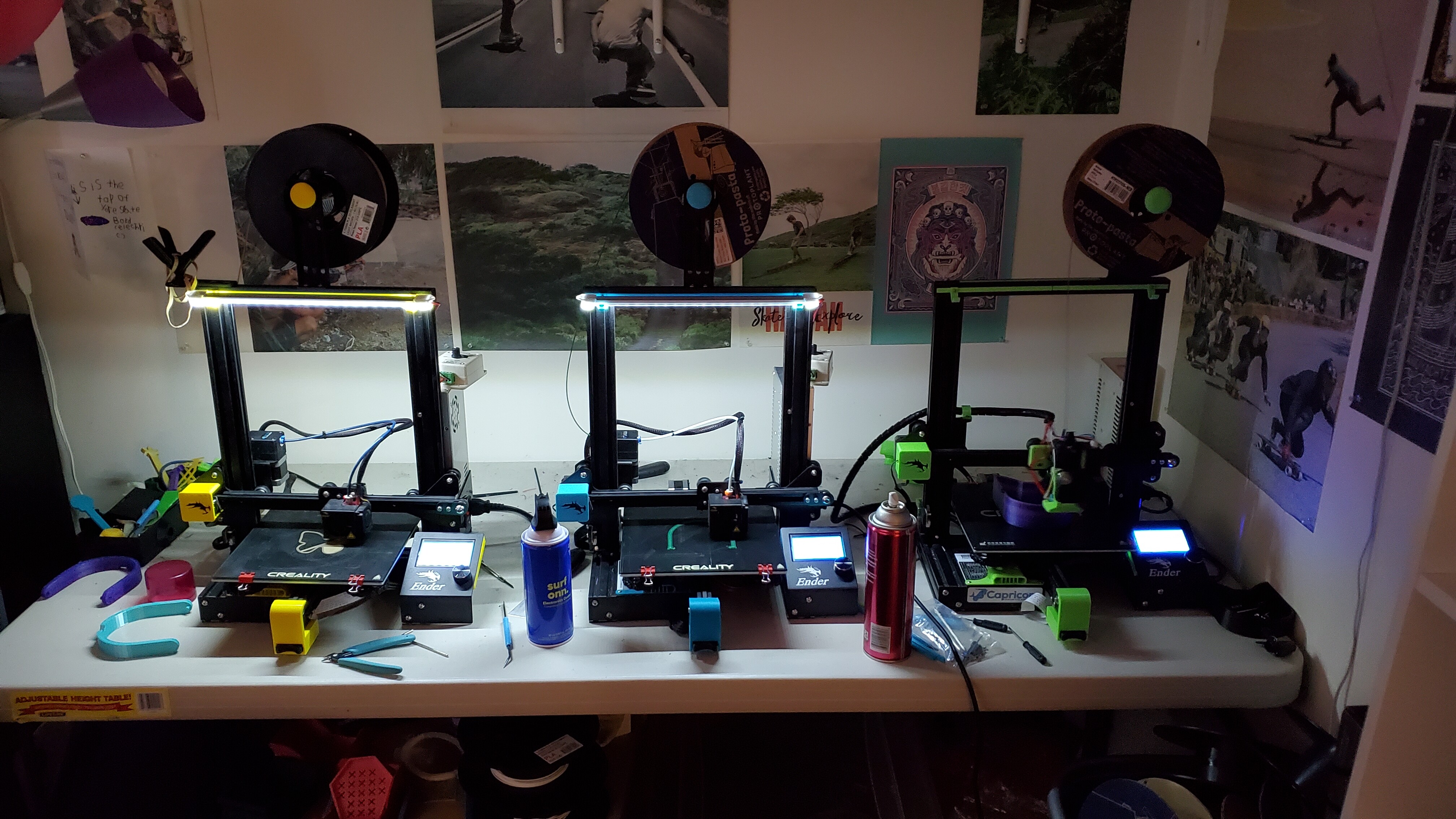

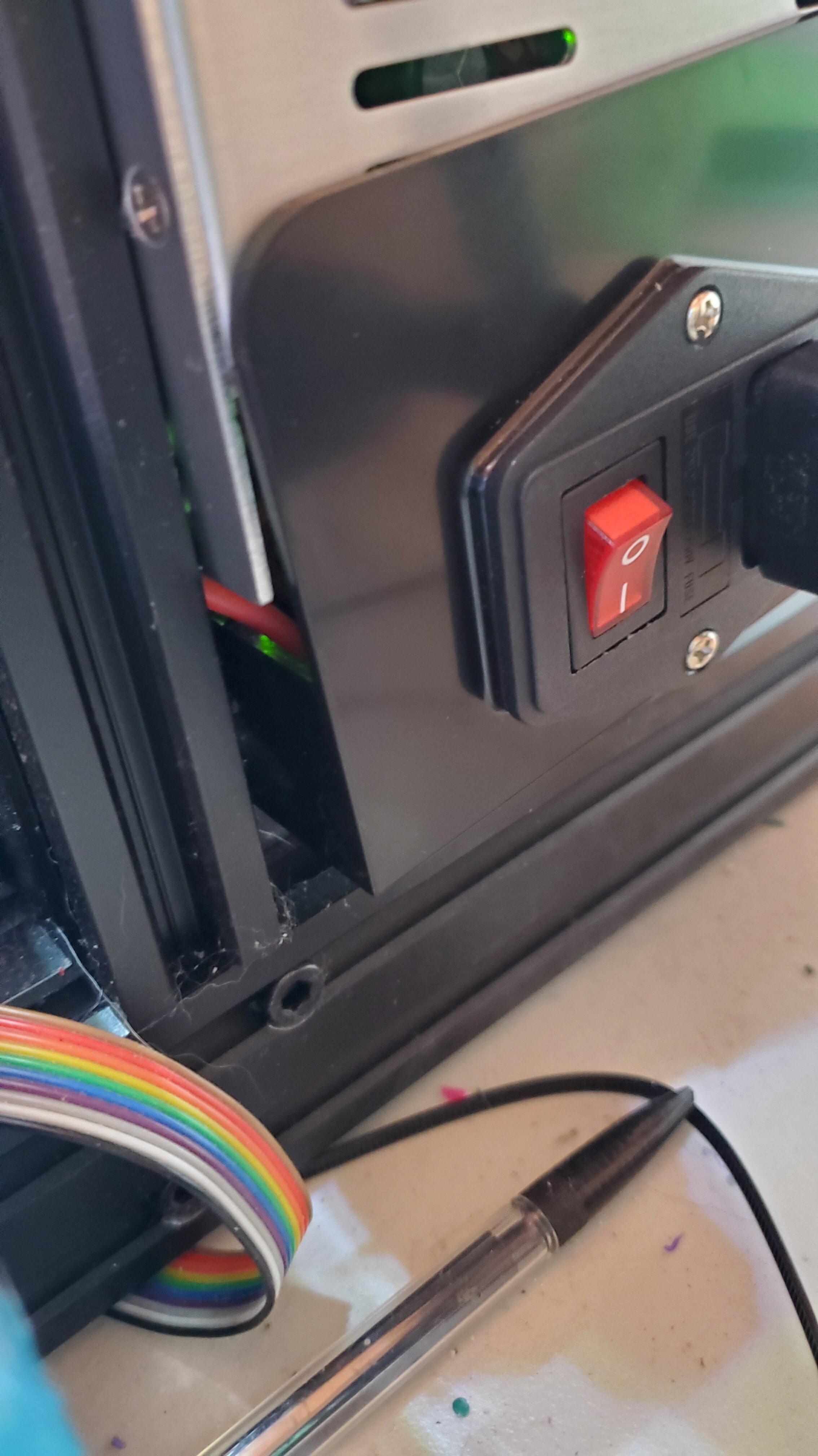

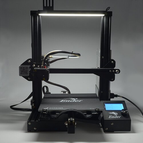

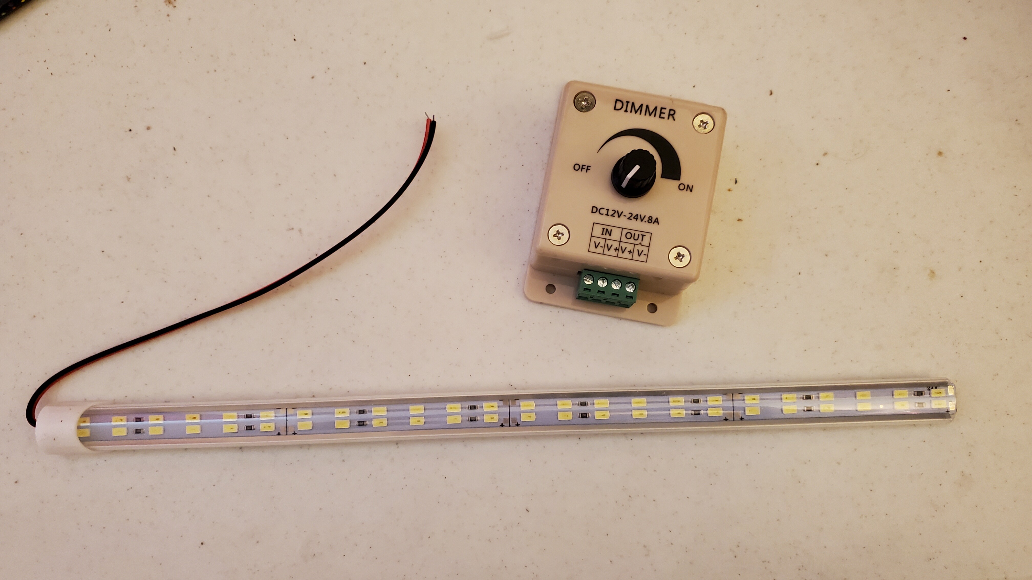

So I’ve been wanting led lights on my 3d printer to see what I’m doing for a while now. I didn’t want to bother with the neopixels port and rewriting any FW to adjust… I just wanted some lights so I don’t have to keep a small flashlight by each printer.
I also wanted it to be cheeeeaaaaap. It’s just led strips and a dimmer switch after all.
I kept seeing kits like these which were basic plug and play using an xt60 splitter. I swapped my connectors to xt90s and didn’t want to make a ton of tiny adapters so I set out to find my own solution.

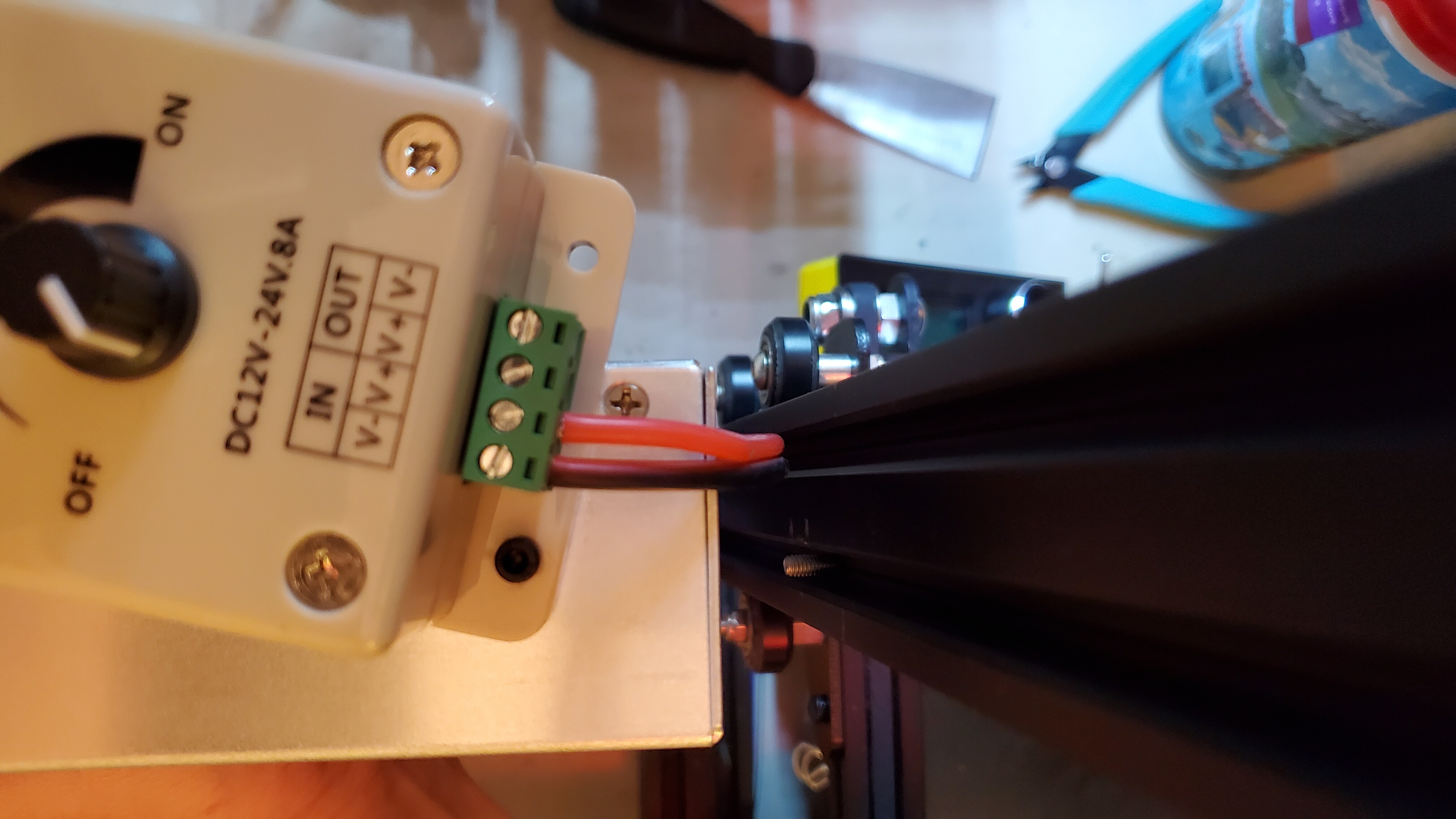

I found this 24v 8A controller in a 3 pack for $10
https://www.amazon.com/dp/B073R7H52B/ref=cm_sw_r_cp_apa_fabc_VFHVKGCT8F65F2ECQP29?_encoding=UTF8&psc=1
Conveniently, I needed to light up 3 machines so boom, sold.
Then I just needed some 24v led strips. I could have bought a huge roll and cut to size but I found some that were the right length, came on an aluminum backing plate, and had leads running off for cheap enough @ $7/each so I caved.

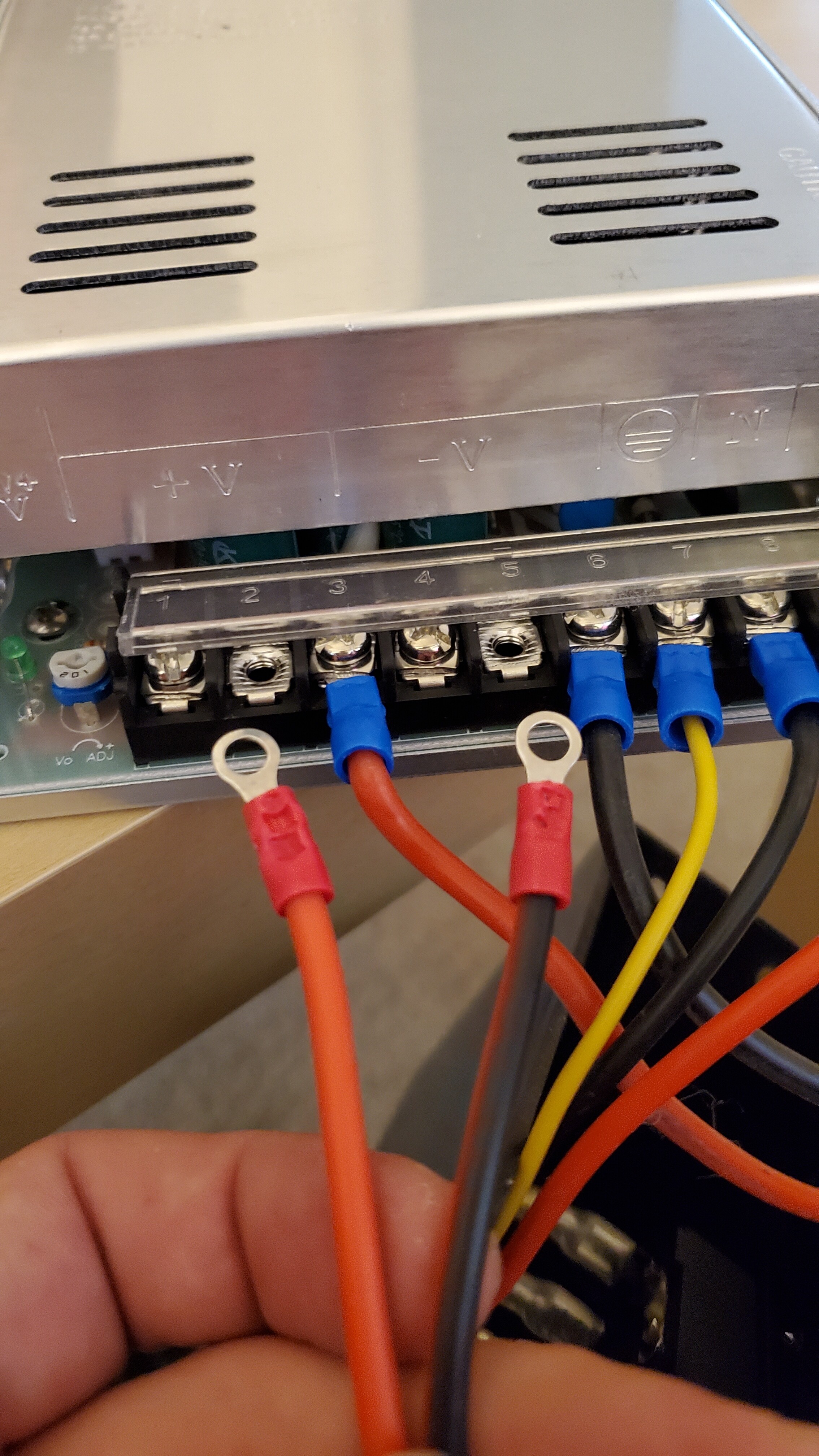

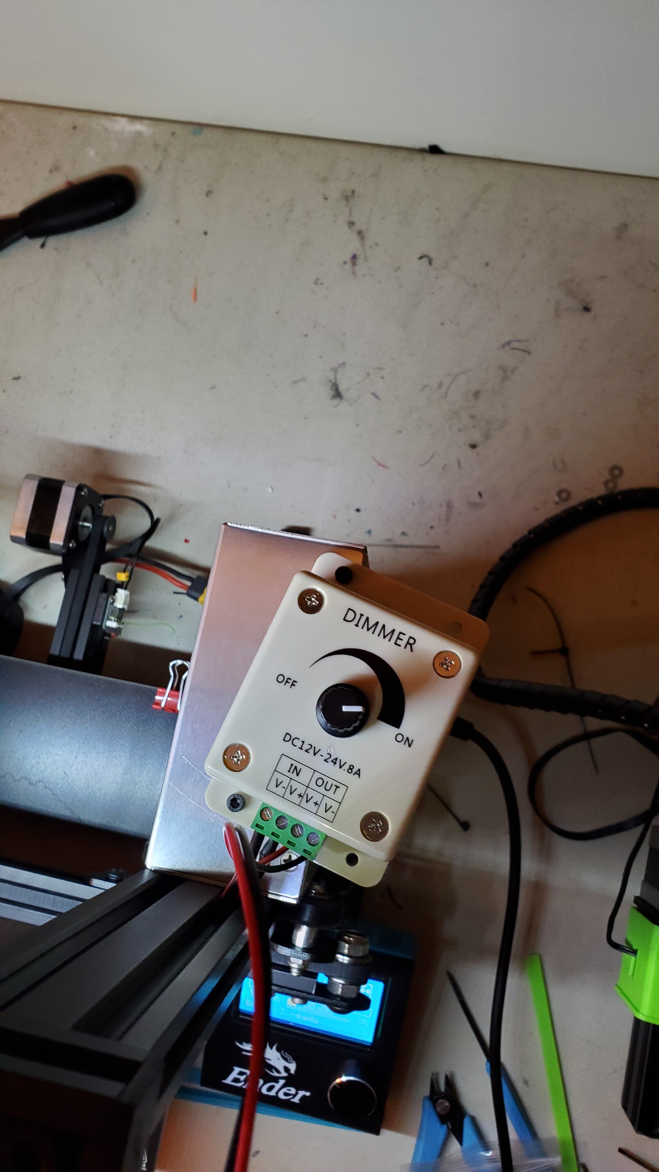

Supplies in hand here we go, as fast as possible. Power off of course.
Grab yourself some 14-16 gauge wire (smaller will probably work but is more annoying to crimp) and crimp on 2 ring terminals
As labeled above, use one of the open V+ and V- terminals to attach your positive and negative newly crimped terminals.

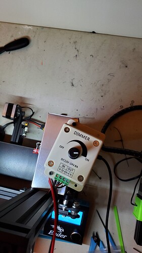

When choosing a switch mounting location, make sure nothing is going to run into it. Think it through…

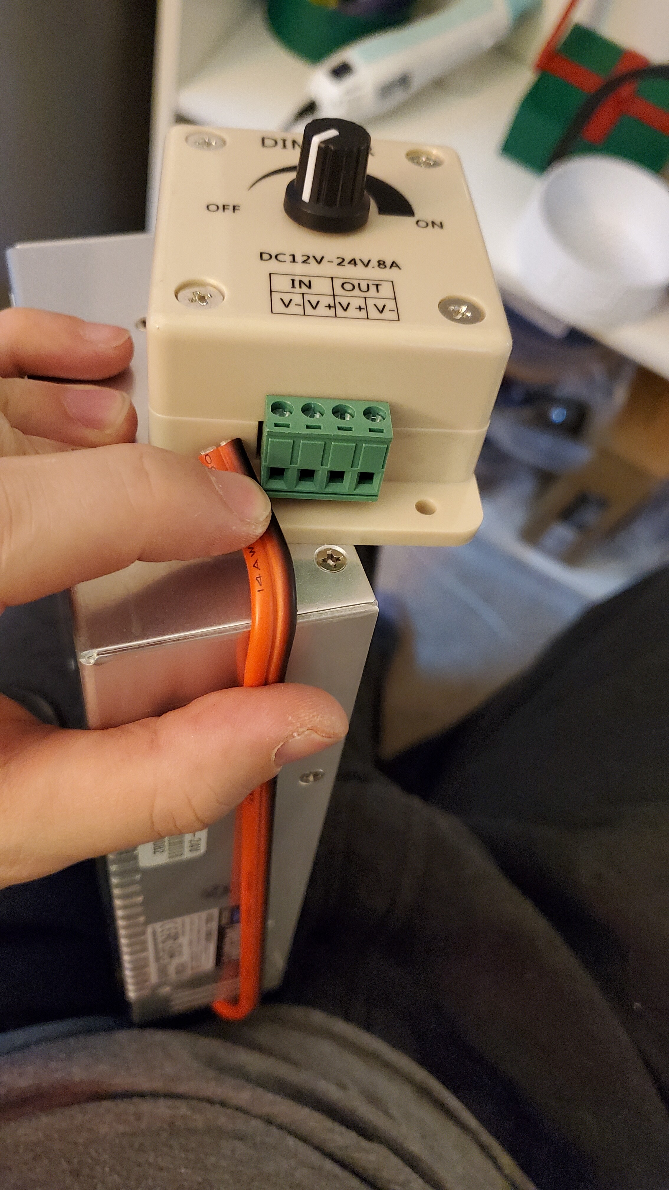

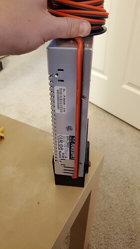

This controller just happened to share a bolt pattern with the power supply unit so I cheated and attached it there making sure to use short bolts that wouldn’t go too far. That’s the easy way out.
Run the power supply cables up this side of the PSU so the bolts won’t interfere. These guys fit nicely in the V slot extrusion.
Clip enough to fit perfectly, plus an extra cm.
Attach wires and insert slack into extrusion void.
Should look about like this now.

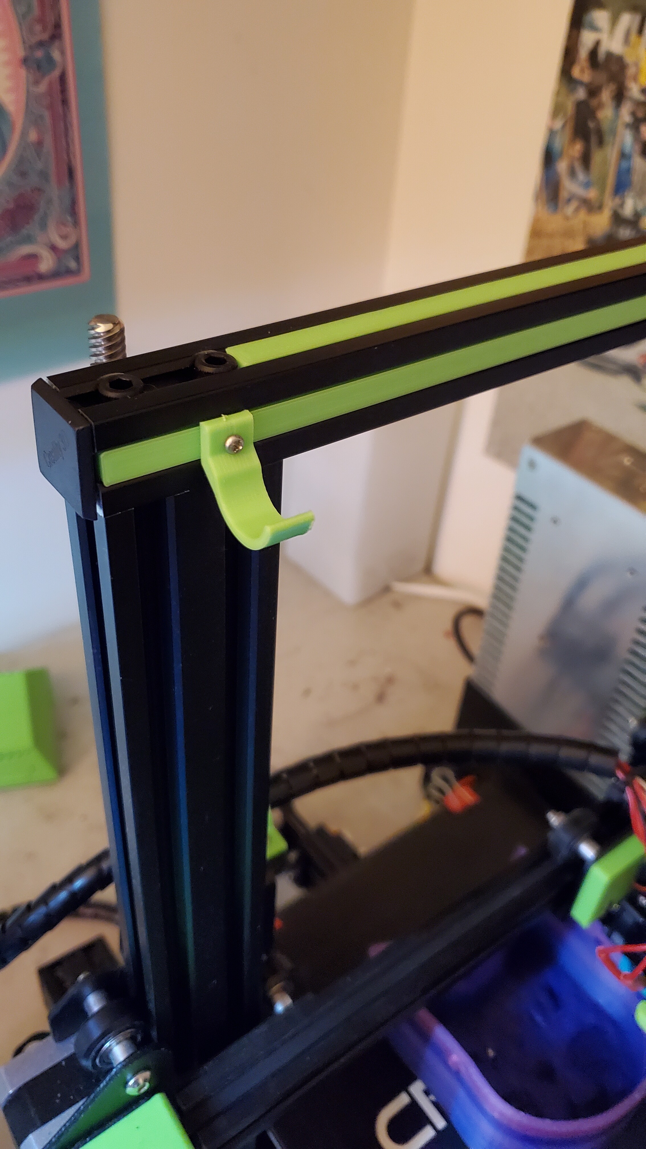

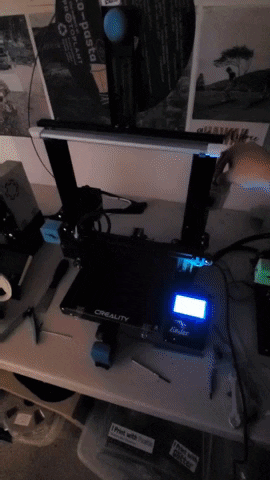

I 3d printed some tiny clips and rail fillers to hold the lights and screwed them together with random hardware I had laying around.
And voila, you have added lights to your printer for ~$10.
Got 2 done in under a half hour and will do the 3rd after lunch.

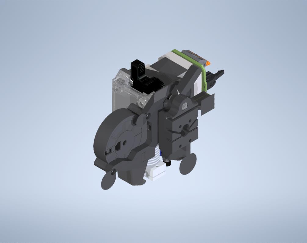

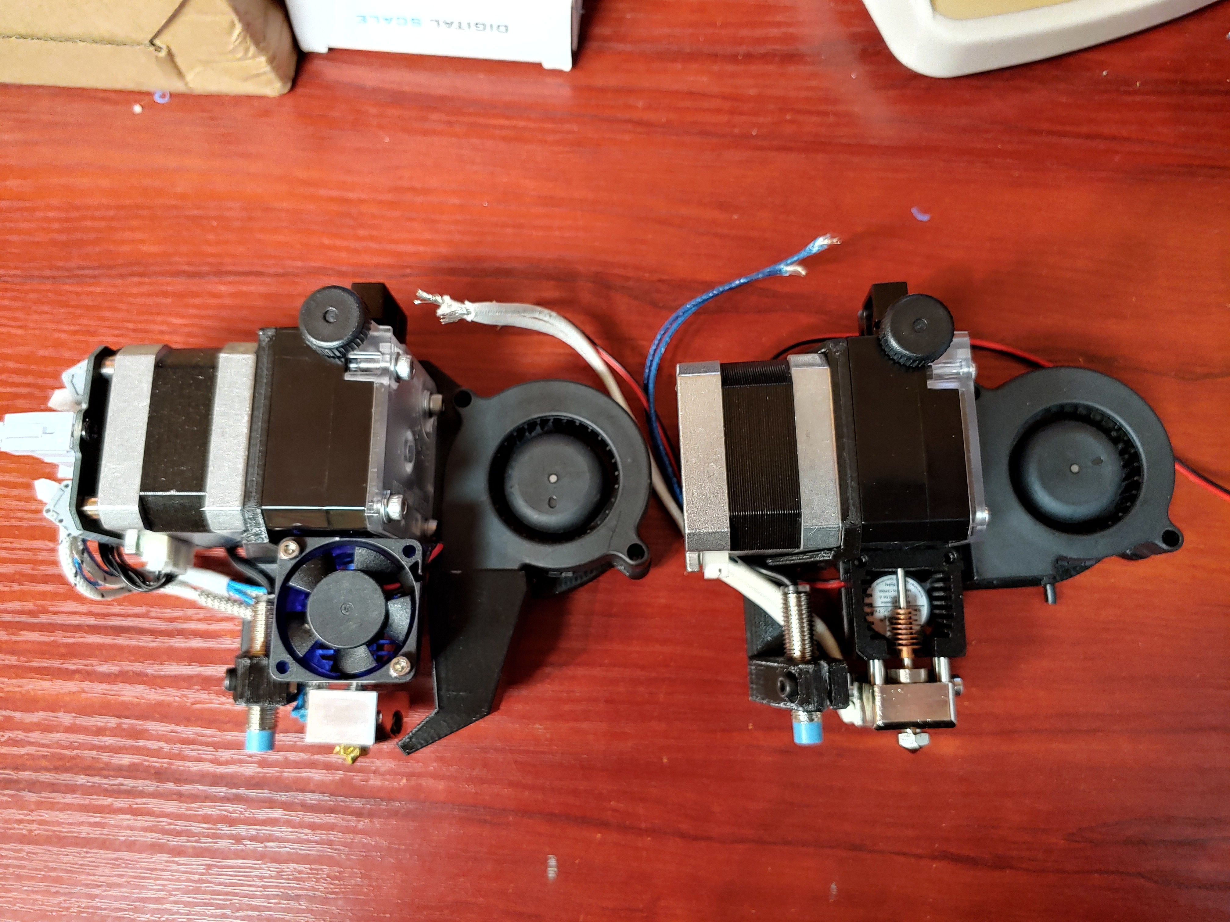

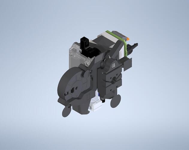

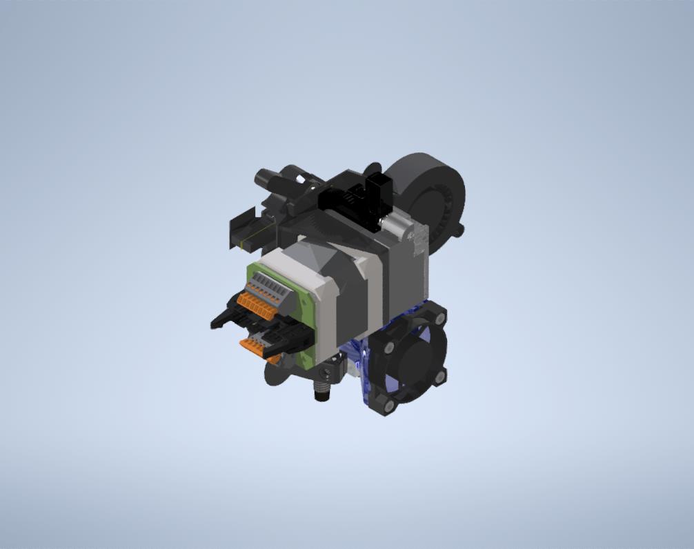

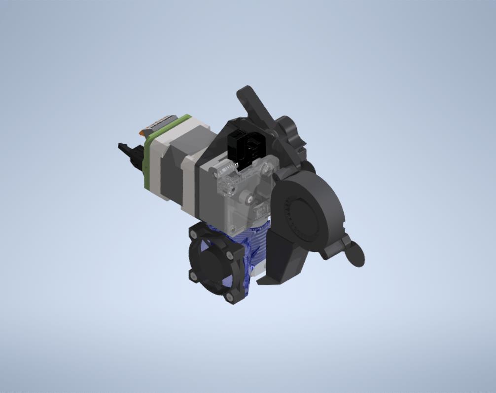

Got my final(until next one :laughing:) design finished and tested. Works beautifully but most importantly is very easy to service or swap.
It sits on Ender 3 with linear rails on X and Y.
I could not befriend BMG and Titan is my choice
looks awesome
do you have any files you could share as i use a titan on a creality printer also and have been looking for a good mount
This is a direct drive and mine sits on rails. I can share files but if you have no means to CAD its useless.
I am running duet maestro so my firmware is custom as well with all the probe and nozzle offsets.

DD advantage is printing flexibles reliably and more precise control of filament. When you do retractions, filament has enough play in bowden tube to be less controllable. the tube moves with the head and at different spot it could have different play inside. Filament is 1.75 and the tube is 2mm ID, less for capricorn, but still.
